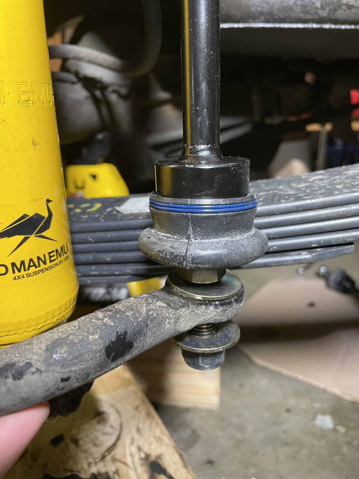

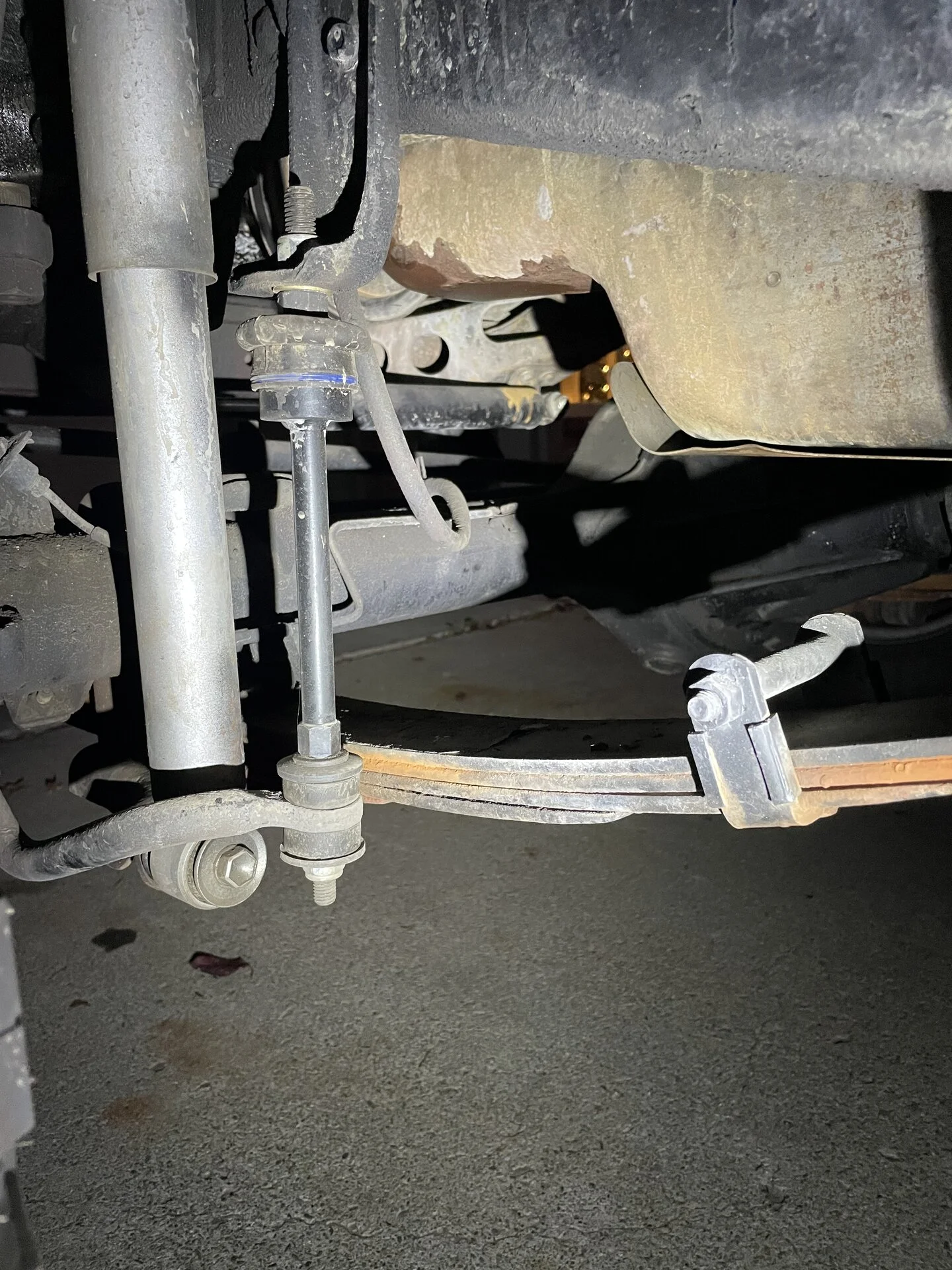

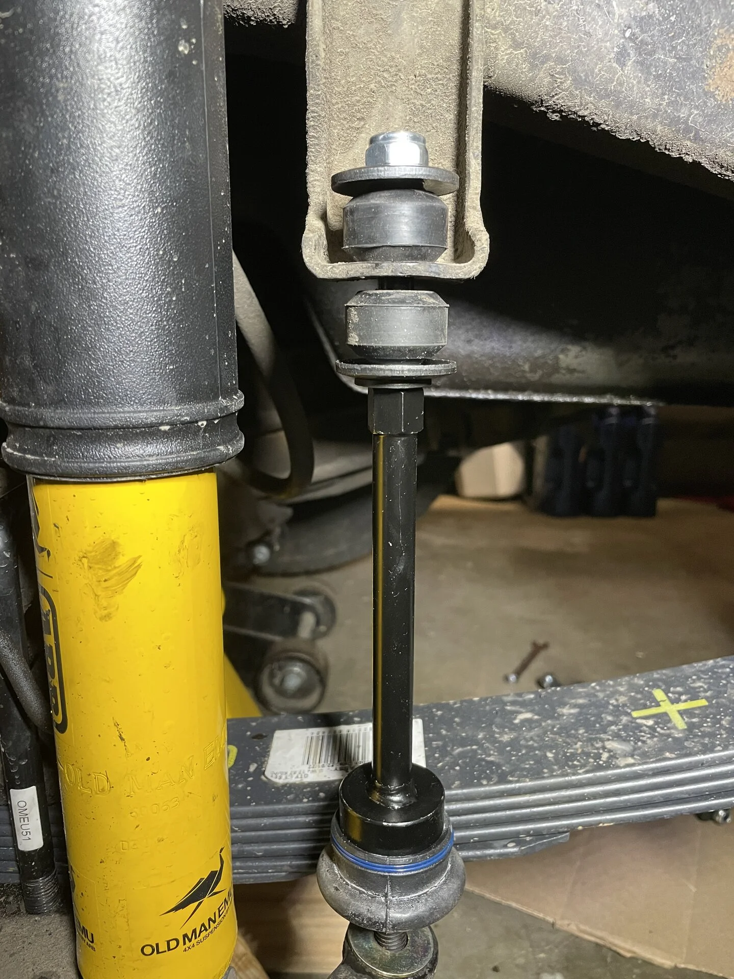

So my sway bar link from Man a Fre look a bit different. Does this install look right? I feel like the bottom is not correct. There was no instructions in the box or online that I could find.
I installed my links the other way around. Traditionally you sandwich the sway bar with bushings on either side
