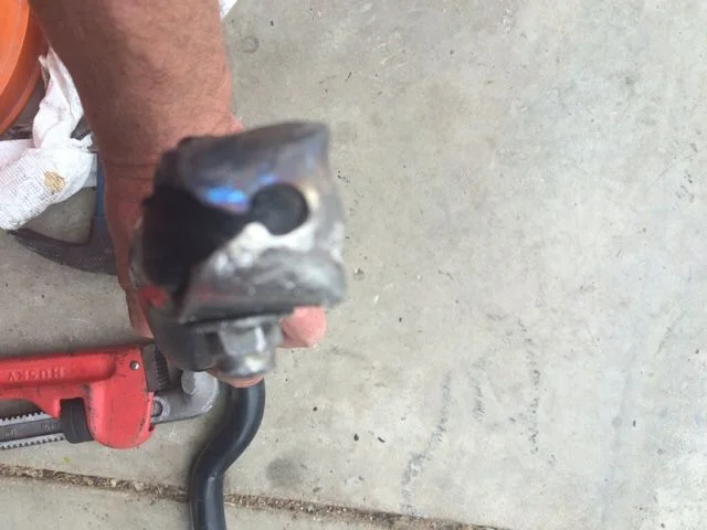

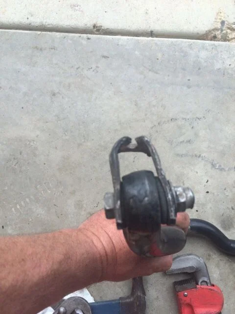

Anyone know where to source the broken bolt hole u shaped piece in the photo? Part #? It's from DS attachment point. Thanks!

Relatively common failure point. We now weld them when we do lifts. If welded on each side before damage, have never seen one fail. Relatively large "gusset" type weld like this:
lift_s_5-jpg.798975
The big problem is access, not a great place to weld. Repaired this one on the rig. Had a spare bracket, but they are easy to make, a couple of straps with the hole, weld them on, and add a strap as a gusset.
https://forum.ih8mud.com/threads/pix-for-steve.851974/
Did this one off of the rig, so easier to see:
https://forum.ih8mud.com/threads/workin-on-joes-80-s.801938/page-2#post-9158145
Thanks. Going to wait for the new whiteline and do just that. I may try to upgrade the thickness a bit. Lesson learned to take the sway off on more moderately difficult trails. Cheers. Any other thoughts?
