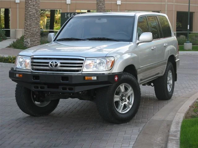

Yes, to me they are the best looking wheel for the Land Cruiser. There's a number of threads on Tundra Wheels and a couple specifically on Rock Warriors. In your search (upper right on webpage) go "more" to allow you to filter down and limit your search to the 100 series forum only. You will find your answers.
Tundra 18" Wheels whats not to like:flipoff2:

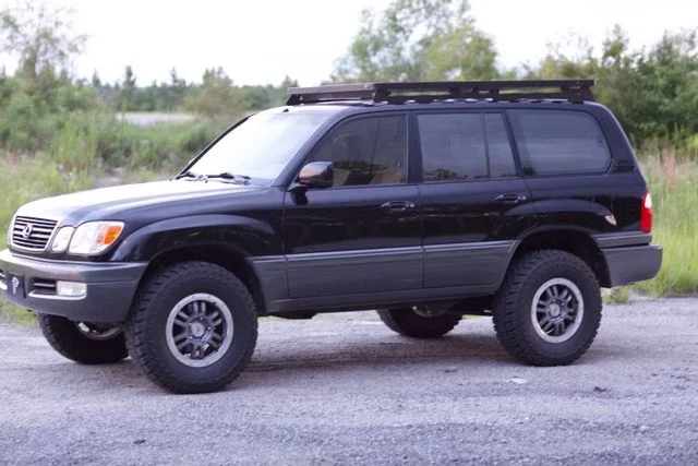

Might have to use spacers if the caps don't clear. You can also dremel out the cap to create space to fit. Or, run them without the caps like a whole bunch of mudders here do (including LandCruiserPhils pic above)
