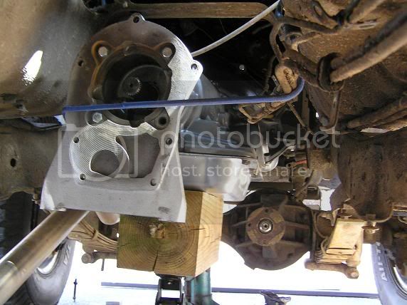

I'm too tired to go back out tonight to take pictures. But we got the tranny in (minus the flex plate and torque converter) and fabbed up the tranny mount. We confirmed the motor angle and with the engine like it is the tranny mount will be almost flush with the bottom of the frame! So with a little more work I'm planning on having the underside totally protected (no belly pan but "sliders").

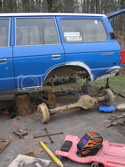

Started SOA. Got the axle out and perches tacked in place but I ran out of time.
Here's where the tranny will end up... I have the crossmember in but didn't get a picture. I like that it's tucked up in the frame rails
After tomarrow I think I'll have to wait till school's out before I can come back up and work on it :(:( but here's a before picture of the SOA. I pulled one axle myself (that was a job and a half!) and we may have both axles under it SOA tomarrow... It is funny how in these build threads no one mentions the crappy jobs... like spending 45 mins to get the freekin e-brake cable off. Or trying to grind the top of the axle where you can't see it to tack the perches in place.

Nice dude, I'm LOVIN the stump jackstand action :D
Oh, and I've failed as a friend. You have those cinder blocks loaded in the totally wrong direction and they are prone to immediate and unwarned failure. Please do something about them ASAP!! (not kidding here, in fact I'm gonna call you right now)
I can't believe it, but that's the first time I've seen the 60 on those tires. I never did see it in person since you got 'em. Weird...
I know you got crap all weekend w/ the boss, but gimme a shout if/when you get a free minute, I wanna check out those axle tubes. :D
