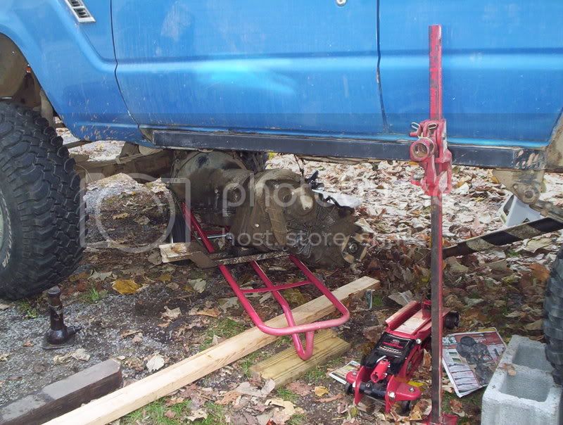

Here we go. Boss says since we're on vacation for turkey day it's time to get to wrenching!
Two and half mornings later I discover that the boss has botty fab skills! We pulled the tranny and t-cases in the gravel with three jacks and a come-along. and dropped the whole unit on a handcart so we can get everything to the basement for the rebuild. It was redneck engineering at it's finest! We took the weight off of the tranny with on jack on the toy drain plug and the other two jacks on each end of a 2x4 (yes wood) under the tranny pan. The pulled the truck forward and dropped the tranny down. There are no pictures in case something had gone wrong there'd be no evidence!
Pics:
Drivetrain resting on the hand truck

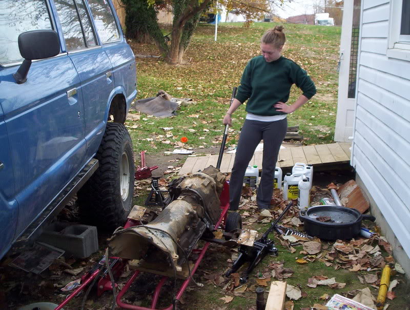

I slid the stuff off of the hand truck and she's planning how to get everything strightened out

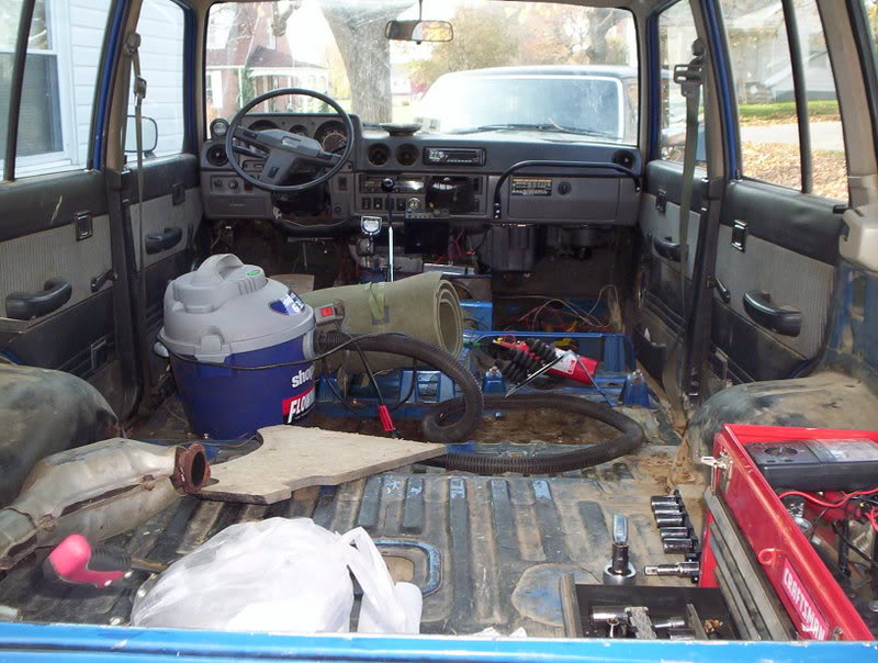

Rust spot 1. Drivers side rear most body mount
Passenger wheel well
Drivers floor pan
Anything else I should do with the interior out aside from bedline paint and rust repair? I'm wishing hard a cage will appear... we'll see about that.
Hopefully found a frame to swap under everything so we'll go to rebuilding next while I wait to get the frame here and prepped.
I would say dont think about attaching the cage to the floor only, at the very least sandwich the floor between to plates, the lower of which should be attached to the frame. The floor is no stonger than the roof, and if the roof was that strong you wouldnt need a cage. Think about it.
