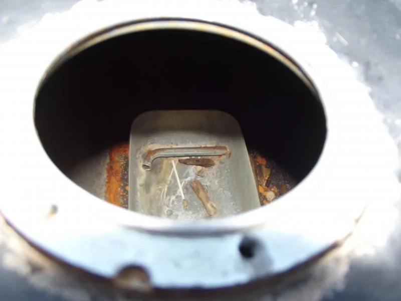

I initially used the stock '77 fuel tank under the PS seat. at 1/2 tank when starting up a hill it would die out. get flat and it started right up. with a port fuel injected engine you can't suck up any air or it dies. here's a pic of a Toyota pickup tank when they went to fuel injection-
attachment.php
look in the caprice tank and it has something similar made of plastic. it allows fuel to come in when flat but can't run out when at an angle or cornering or on hills.
I couldn't fit the caprice tank in mine. IIRC it is wider than the frame of the 40 and would hang too low for me. check it for your application. it may be different.
