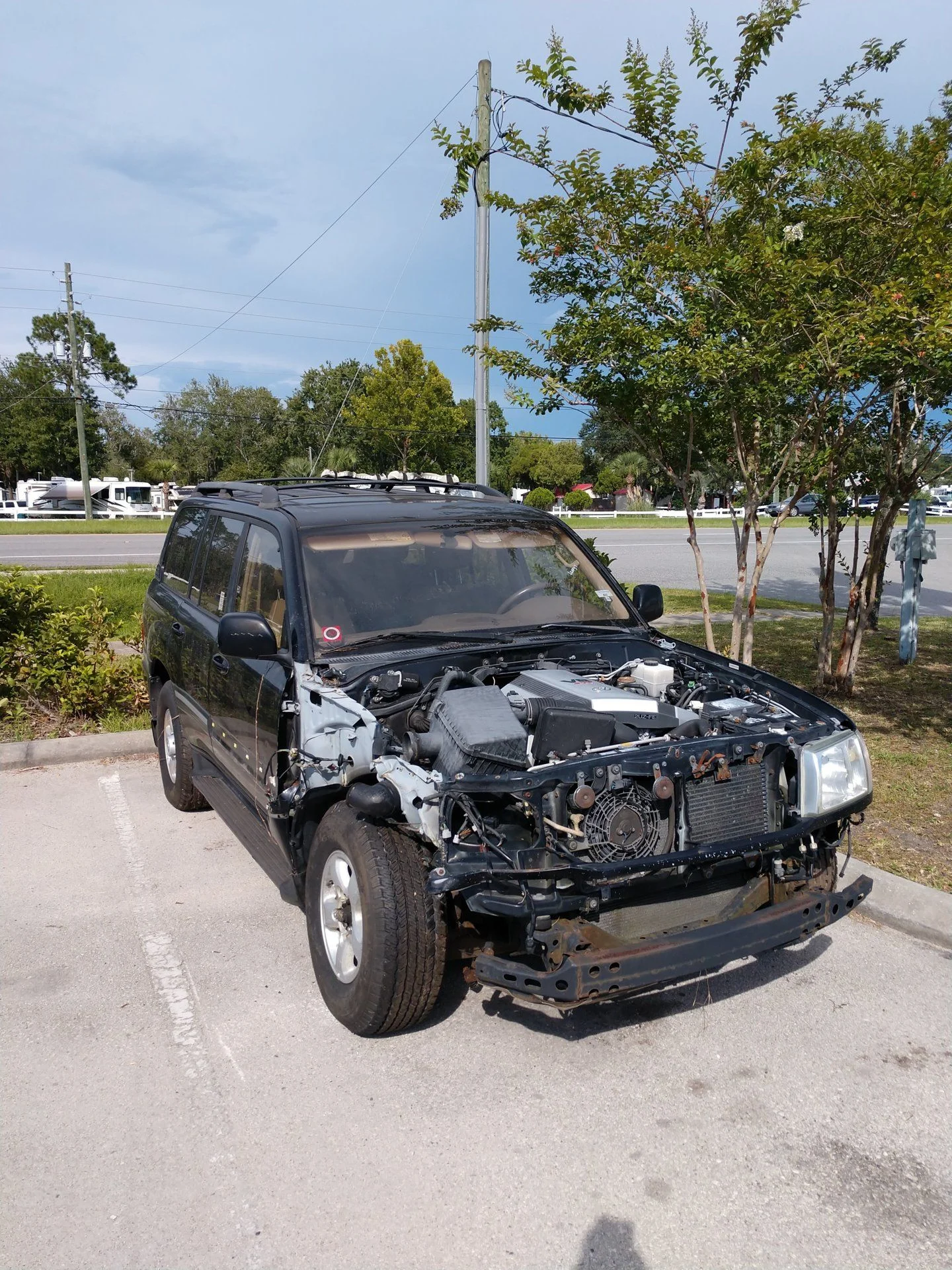

One thing to keep in mind guys that I have actually bought a complete truck, I'm going to park them side-by-side and perform the swap that way so I'm going to have full access to everything.

This is non vvti engine. Hopefully this goes smooth I'll keep you guys posted with a build thread.
A 2UZFE Prado 70 series swap! Cool; I'll be following closely. From your first post I thought you were thinking of a 1UZFE, which is why I spouted off all the info about different generations etc.... 2UZFE is a different beast.

I originally was going to go with the 1u but the engine and transmission alone we're just $700 minus all the extra bits that I needed. My plan is to go ahead and utilize the OBD2 port as well out of this truck to make diagnostics a lot easier. I will try to snap shots as much as I can. I've taken on a third job to be able to pay for a lot of this extra stuff so my friends at the shop will be doing a lot of the extra work, I'm not too savvy it engine swaps but I have no problem doing suspension and little things. I'm also talked to a few people that have done the swaps on here and I'm going to try to create a PDF format guide on how to swap at your own risk.
