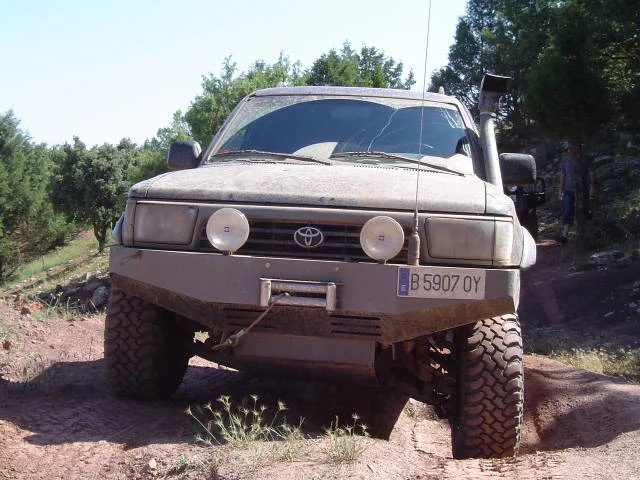

Hello everyone.
As my near project is swap the unreliable and unflexible IFS of my 89 4Runner for a solid axle, I found a FJ40 in a junk yard that have this front solid axle and I wonder if it can fit to replace my 4Runner IFS.
Any advice or suggest are welcome... Thank you!
