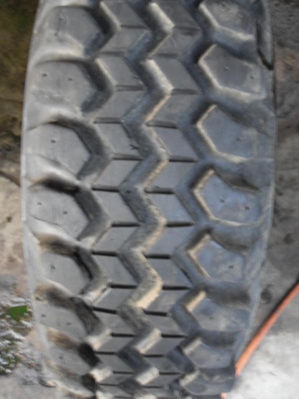

now onto the sipping pics, here's what I did. first pic was a rear tire (good shot of how it was done), and the second is a close up of a front that chunked out. I agree that the sipping is better for icy roads.
so I think that the diagonal grooves you have are good. I did mine to the center of the far side instead of the corners like you drew out. just don't go too crazy and leave smaller blocks. that's why mine chunked IMO. grooves and sipes too close together.
