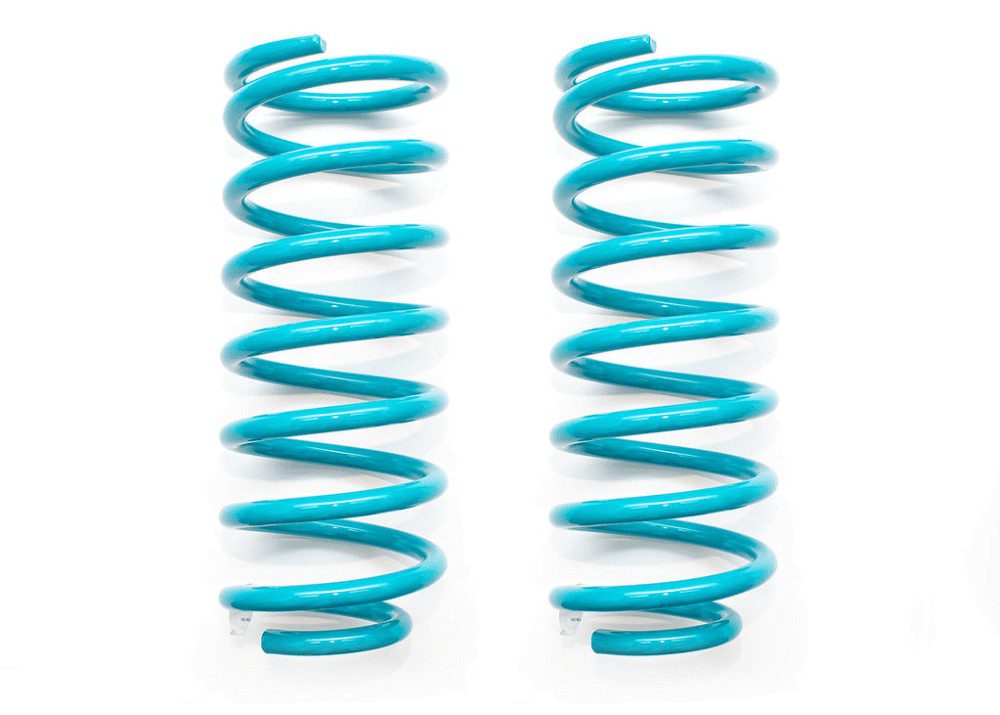

I measured the rear and it was sagging around 18.5-19 inches so looks like I'll try and add some springs in the rear. I'd like it to sit about 1 inch higher than stock which is ~21.2". I think some medium springs could be good. Do you know of any good recommendations? I'll plan to raise the front just a .5" lift to 20" total.

You're welcome. They're the most popular and common 100 series rear coil we sell.
Hey Mike, before pulling the trigger I saw on on Cruiser Patch's website that C59-223V only provide 1" lift at stock load. So in my weight case I would be at factory height or even sagging in the rear? Please see screenshot below:
*also adding that this is not my daily driver anymore so with items stored constantly in the trunk + bumper and drawers, I'd guess I am netting a constant load +200-300lbs over stock.
That's old info, Dobinsons changed their lift height specs on those a few years ago
Got it! Do you know when the C59-223V will be back in stock? I've got a trip coming up 4th of July weekend and hoping I can source these beforehand as my truck is driving like 💩 with the rear sag.
No ETA yet. Probably August-September. That probably won't meet your timeline. LOL

Thanks Jason I absolutely do and am going to be ordering the Dobsinson C59-223V rear springs. I'm looking for about 1-1.5" lift over stock and these give 1.75" at stock weight so believe they will be perfect.
