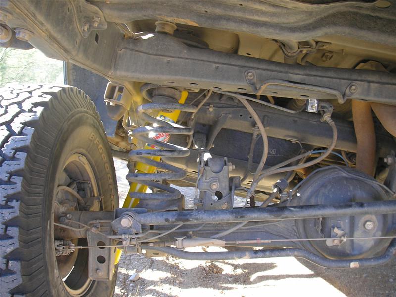

How goes the spring retainers? I have my 863's retained at the bottom by welding some steel over the spring perch and also below the perch so that it wraps accross the bottom of the spring. But I haven't done anything with the top perch yet. I'm curious what you end up doing. I can't decide if I'm going to mess with the top perches and put my 866's back in or if I'm going to just buy some 860's. Post up some pics when you get those top retainers done. I'm curious how the 866's will behave when retained top and bottom.
We bent some 3/16 steel for bottom perches...will bolt on tomorrow thru that hole in the bottom of the perch...Have not really looked at top yet...will tomorrow though...I will take some pics tomorrow...GregB, do you have any pics of your bottom retainers?
Does anyone have pics of how compressed the coils get at maximum articulation? I noticed my retainer could interfere with coil on the bottom if the coils compress real low.
Another thing I noticed today is that my brake lines don't connect above the diff like the pictures of Shotts cruiser..Maybe because mine is a 99 vs. his 01...The only tube I have going up or down is the diff breather tube...Anybody else notice this? if so where do I extend the lines..if at all??
Thanks
Because of how the spring flexes you need to retain it over the axle toward the center. The spring stays close to the perch in this spot. Look at the pic. I retained the spring on the perches RIGHT side (this pic was before the retainer):
