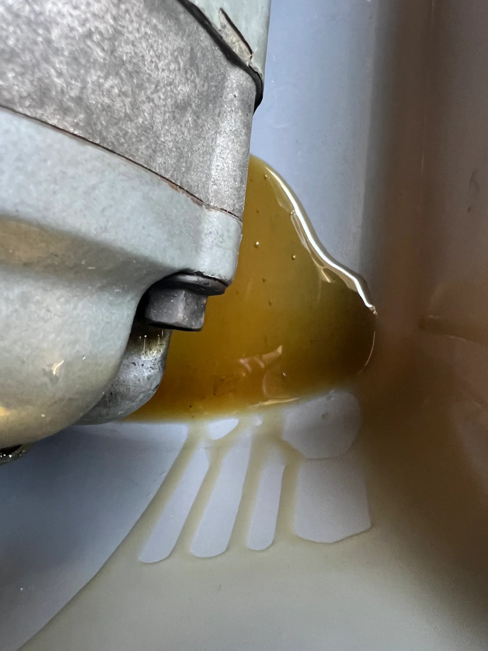

My TRD supercharger has approx. 50k miles since Magnusson rebuilt it 15 years ago and I'd say my oil was due. The oil is significantly darker than the new GM Supercharger oil.

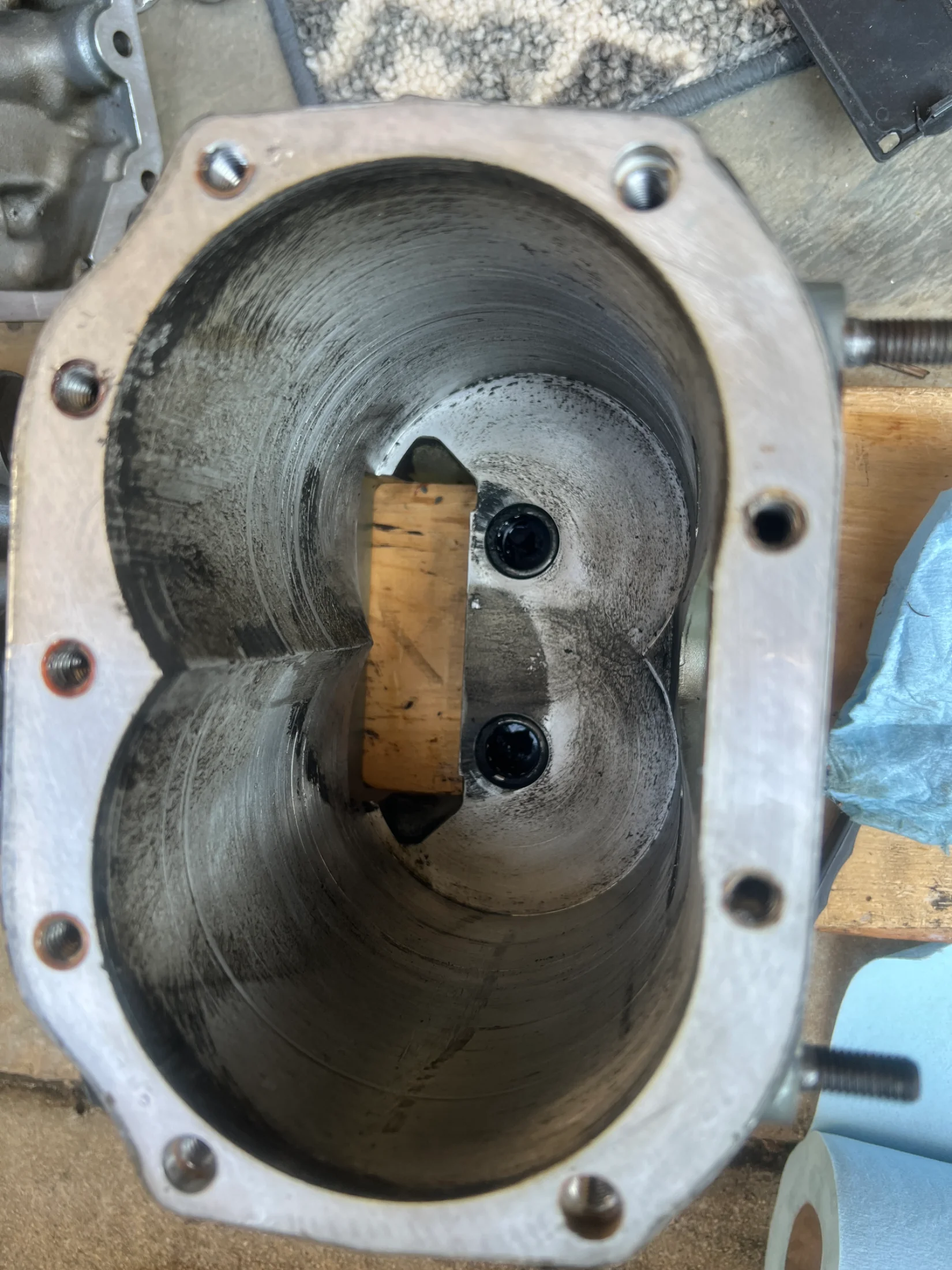

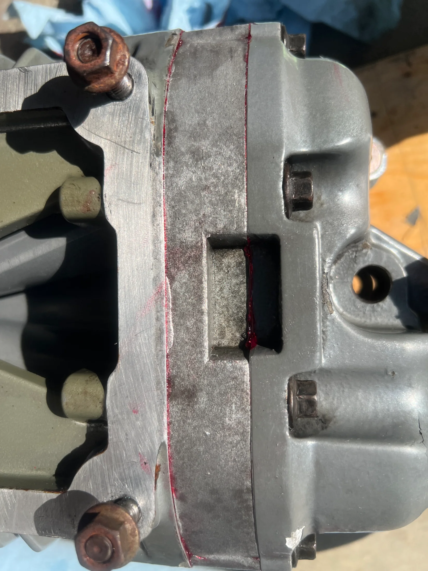

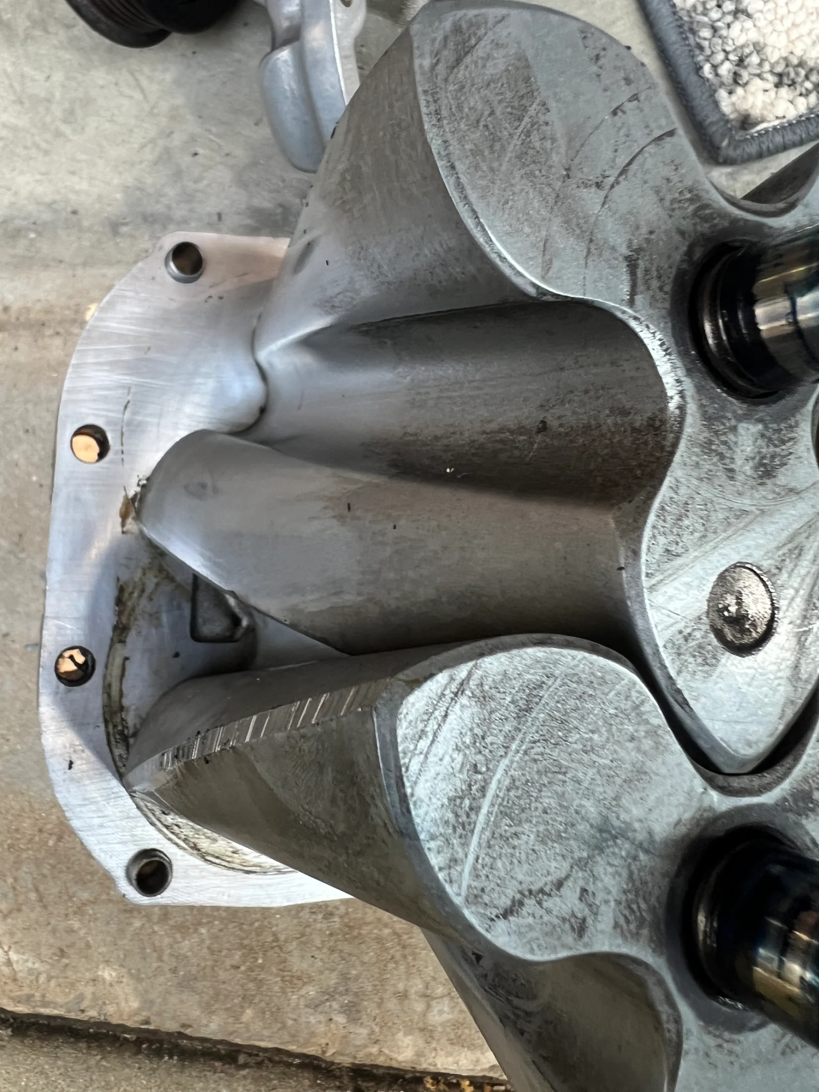

Well I knock the rotor section loose when removing the nose cone. I noticed no Loctite 518 sealant in between it and the case. So figured I'd remove clean, reseal and reinstall until I saw this. The rotor edges have scored the housing. Ugh!
The bearings were all replaced when I had it rebuilt or so I thought. They seem to be tight in the case when rotated. Perhaps this is old damage prior to rebuild.

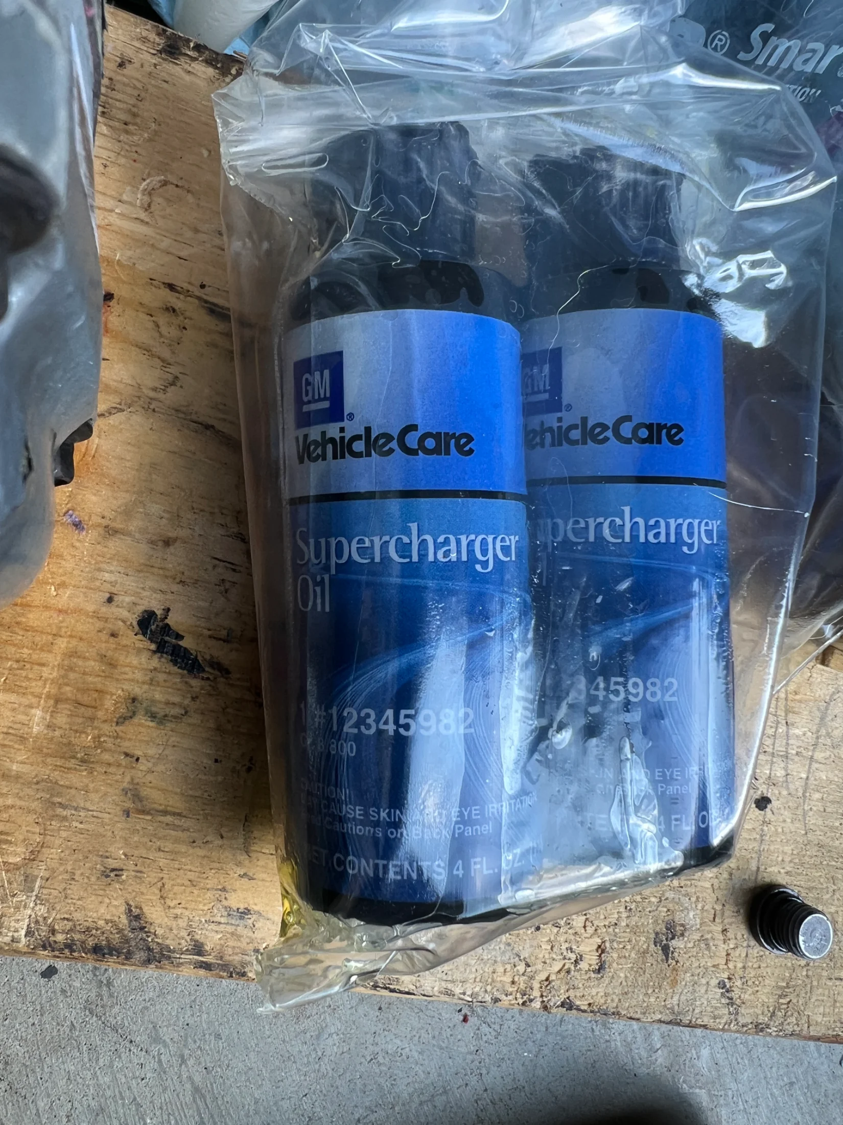

I put it all back together and oiled with GM Supercharger oil that has been in my tool box, triple bagged, for the last 15 years.
Spun it a bunch and she's tight. No noises or wobble.
Must have been damage prior to last rebuild. I'll reinstall and run it and see how it goes.

The GM supercharger oil change seems to have quieted it down. The coupler was tight with no indications of wear. Getting max 4.5 psi boost with the stock TRD pulley so no change to previous observations.
It was relatively clean inside when compared to other M90 units seen on YouTube.
