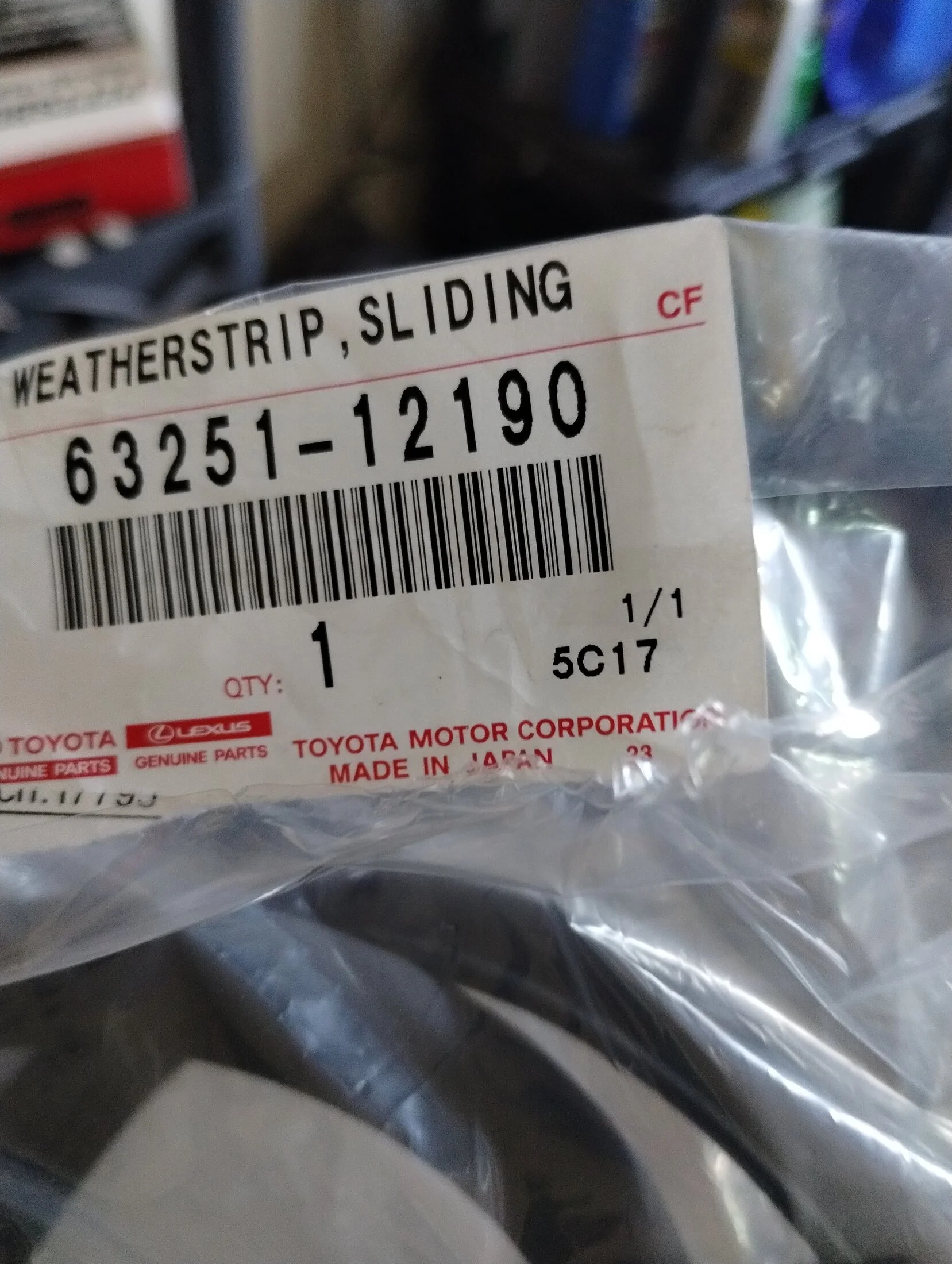

Sure, here you go...
Just a note about this.. 200-series LX list a deal/gasket part number separate from the sunroof panel, but same-year LC's dont. They only show a complete assembly. I don't know the reason for the difference, possibly some bougie coating on the L-model panel. That's a total guess.
I've ordered a LX seal to put on my LC but it has been sitting on the shelf for at least a couple years waiting for me to "find time" to absolutely verify it fits.
Time....

Any update on your project? I just called my Toyota parts department and they confirmed they recommend buying the weatherstripping and the glass together for $1,400.
The part pictured here is $70. Were you able to complete your project?

I spent $35 for the weather stripping. Of course the parts dept is gonna "recommend" replacing perfectly good glass... Everything is a scam now. WTF would the glass need to be replaced if it's not cracked or broken?
Go to Bell Lexus online and buy the part for $35

Hold your horses.. the Toyota parts diagrams, which are the only ones they likely will be looking at, don’t list a separate part number for the gasket. Only the Lexus one does. I don’t know why.
