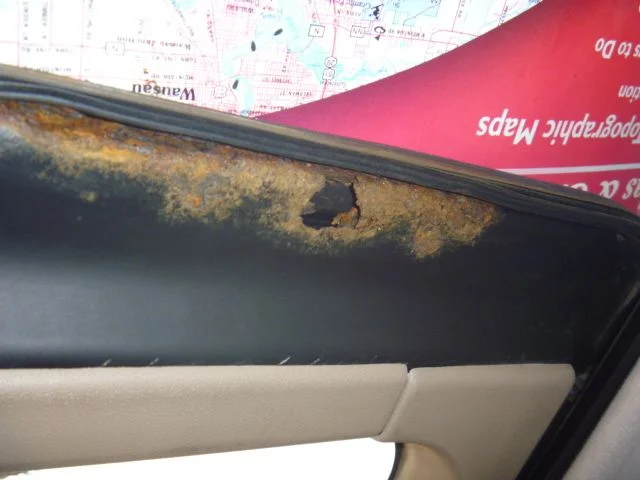

Just when I thought I knew where all the rust was on my truck, I found something bad for the first time last week when I was applying that weird German goop that people recommended for conditioning rubber seals.
As far as I know, I don't have any issues with leaks getting into the roof and I don't get any water built up under the carpets. The drains have been cleared with a weed wacker string. The sunroof otherwise functions perfectly.
My concern is that if I try to remove the sunroof to install a new unit, I will mangle my perfect headliner(I have the lovely '94, which I am told is NOT easy to remove or reinstall). I am also concerned about getting a used one and not being able to get it all back together properly.
I am leaning towards just trying to get this cleaned up with a wire wheel and then treat with POR15 and then pumping some body filler into it and then painting it. My other idea would be to use a high quality paintable caulk like OSI Quad so that things can shrink and expand with temp changes.
I would prefer to avoid the classic Red Merle program of making little jobs into big jobs on this and I would be able to live with a repair if I thought it was going to work and not cause future issues. The hole is right above the driver's seat, which is why I never noticed it before. The hole is currently about the diameter of a dime, but I have a feeling it will expand quite a bit if I try to grind it out. It's not great, that is for sure and I really don't want to cause the sunroof to leak by futzing with this.
Any thoughts on what I should try to do here?
The photo is so close up its hard to tell exactly where this is.
It's on the front of the sunroof on the driver's side. The map book above it is outside(I had to put something up there to get a "decent" photo.) The sunroof is open by about 5" in the pics.
You do not want to remove this if you don't have to. There is no way to remove the headliner fabric without ruining it. Try to get at all the metal you can reach with a brush and remove the loose scale. Wipe it down with Ospho and let it sit, with the windows open (obviously indoors), overnight. Wipe off any remaining fluid residue. The Ospho will convert the iron oxide into iron phosphate, sealing the metal and preventing further oxidation. It'll be black when the iron oxide is converted (it will not be pretty). If the ambient temperature is below 50°, it may take two days. The reaction will slow down below that temperature. There is no need to paint anything you can't see, the iron phosphate is a permanent coating. It does serve as a primer prep, if you want to paint. It not only provides rust inhibition, but also serves to provide better adhesion for the primer than bare metal gives.
FWIW, this is why I mentioned in my earlier post that a rust inhibitor is always necessary before priming. It serves those two functions and both are necessary. Bare metal oxidizes almost immediately and if you don't do something about it, the paint coating lifetime will be less than optimal.
Also, if you can get it, zirconium phosphate is even better than Ospho. The largest US manufacturer is near you somewhere, IIRC.

Thanks for the response. I agree that removing the sunroof is not really an option. As for the ospho, I wasn't really disagreeing with you, I just thought he had it down to bare metal and that not using it probably wouldn't have caused problems for him. That said, this is an entirely different situation and I know for sure I am not going to be able to get this really clean without damaging the seal. I have some Rust Mort Rust Mort™ | morttm | SEM Products. Do you think that will be OK?
What are your thoughts on the caulk vs. body filler idea? I could shoot some caulk in there and let it cure and then use the body filler. That way there would be a little flexible layer to account for expansion. I feel like I need to do something though or I might run into trouble with the metal frame becoming unstable.

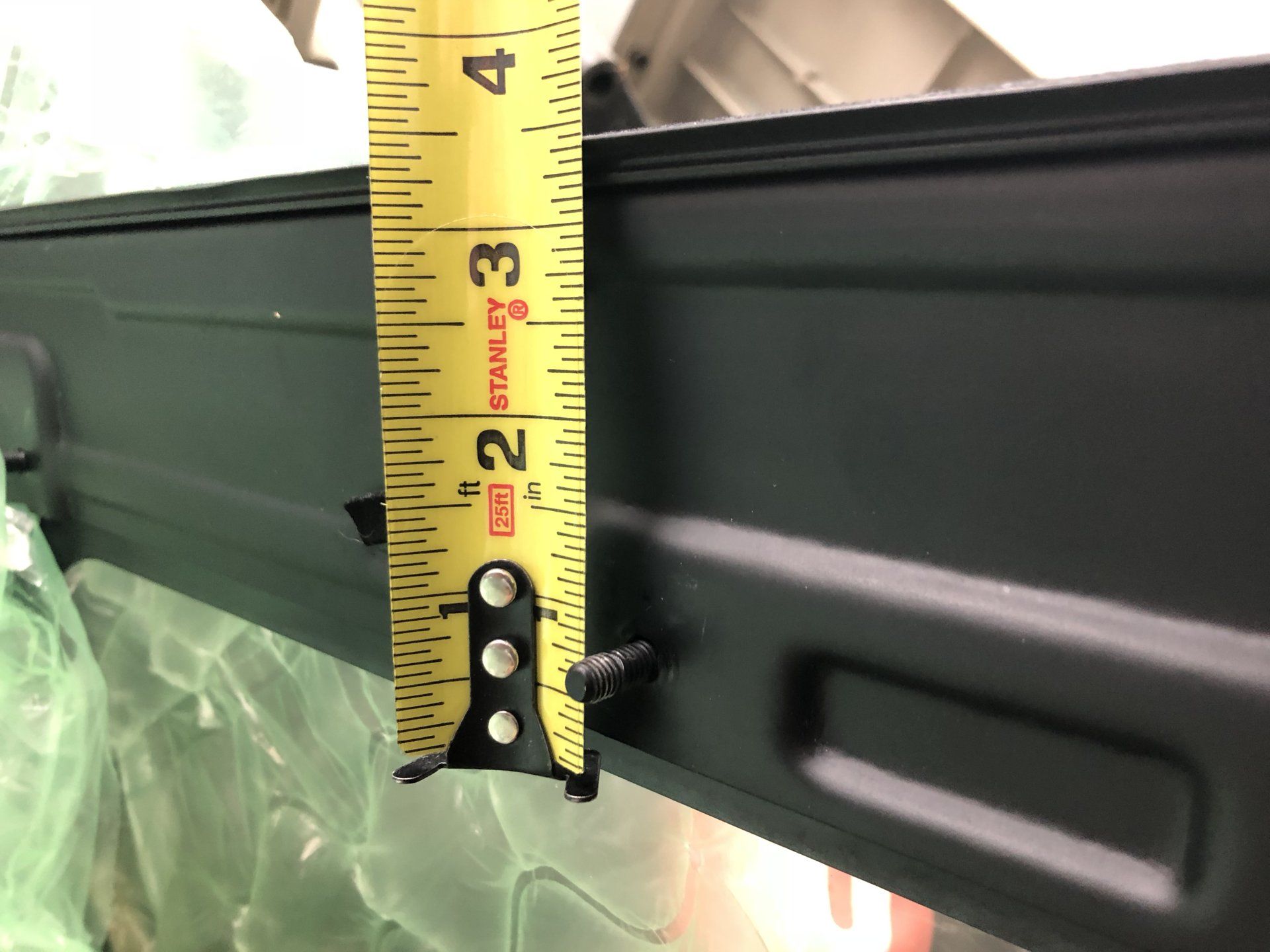

I don’t think you’ll be able to swap the seals. Here’s a better reference for the location of the threaded studs. I haven’t removed one from a pre-95 but I’m pretty dang certain it’s got nothing to do with the headliner. Just go pop off one of the plastic trim pieces and have a look

I took the trim pieces off like you mentioned and it sure does look like I can just loosen the nuts and lift the old one out. Thanks for the response. I didn't think this would be an option, but now that it seems like it is, I would rather just get one in that doesn't have the rust hole.
