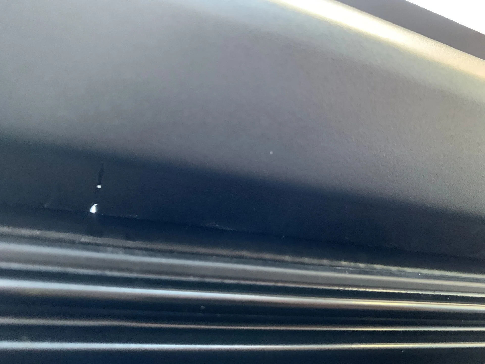

Hi everyone,
Looks like I ran into the same issue here too after a few days of rain here in CA. I noticed that there was a small drip coming from the sun roof from the edge facing the back of the vehicle.
I took off the trimming and noticed water marks. At this point I am leaning towards resealing with silicone unless there is any other suggestions for an alternative fix by the community. Not looking to replace the whole sun roof if possible.
Also even if I change the seal, is that even a do it yourself project? Also for resealing, any particular suggestions to brand or type of silicone?
See photo
