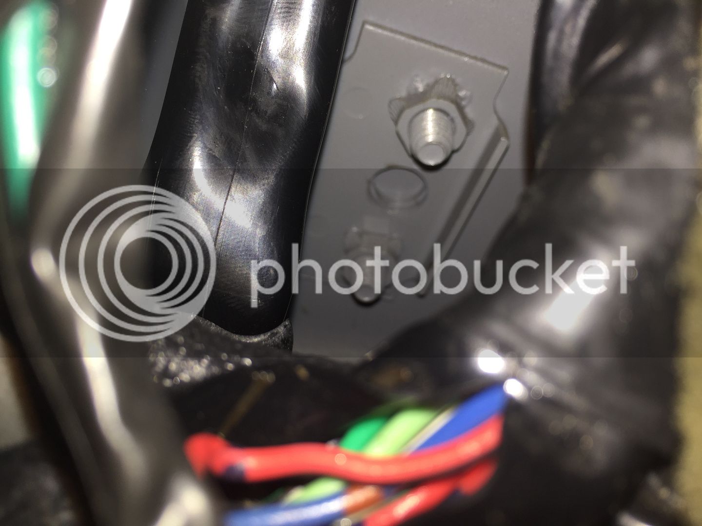

I did some research and determined it was most likely a clogged drain(s). After fishing weedeater line from the sunroof side, I attempted to clean from the bottom of the hose. In doing so, I disconnected the hose from whatever it may have been attached to at the bottom of the A pillar. So now the drain hose is loose, but draining. Will this be an issue? I'm concerned about the electrical components that are stashed into pillar with the drain hose.
Hose pictured below. I can't really see to the bottom of the pillar to even attempt a re-connection.
Well I've got a 100 now so I can't go look at the 80 but I'd imagine there's a way to reconnect the hose. Just so I'm clear, the hose came unclamped on the low side, not the high side between the roof and headliner?
Correct, it is unclamped from the low side. The water still drains properly from the slit beneath the vehicle.
