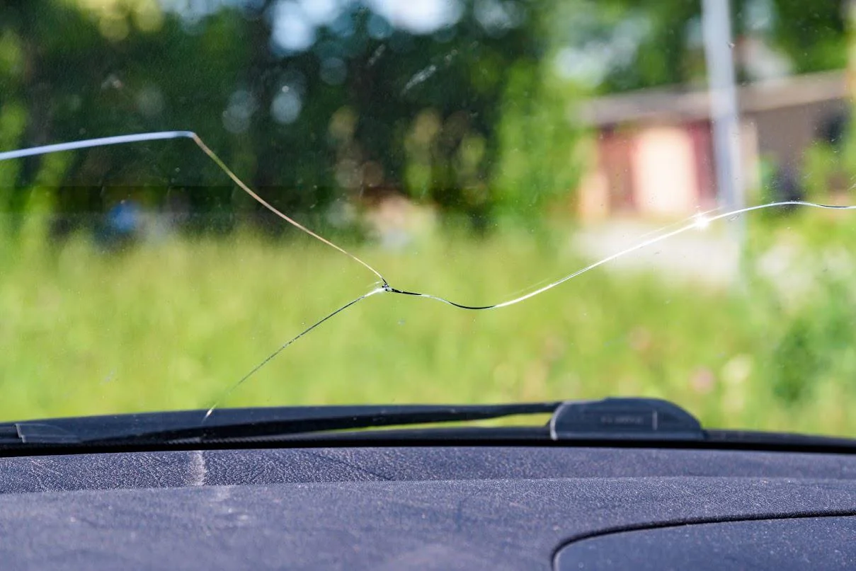

@80 Life : Got photos of the sunroof glass crack(s) you can post up?
I will post a pic when I get home tonight. It looks like the below but smaller. It spiders webs out just once like this and its why I would think sealing the crack wouldn't be possible

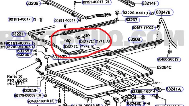

IME the sunroof glass assembly can/does sag over time, adding shims (available from Toyota or about any parts store) to the nuts/studs will raise it up and help the gasket seal better, although as mentioned it's not entirely waterproof.
If you remove the glass entirely there are other tricks you can use to help the seal work better (search sunroof leaks). However when you reinstall the glass you have to test fit the glass position (fore/aft) and spray it with a water hose before you tighten it down as that also can also make a difference in how much it leaks, IME.
