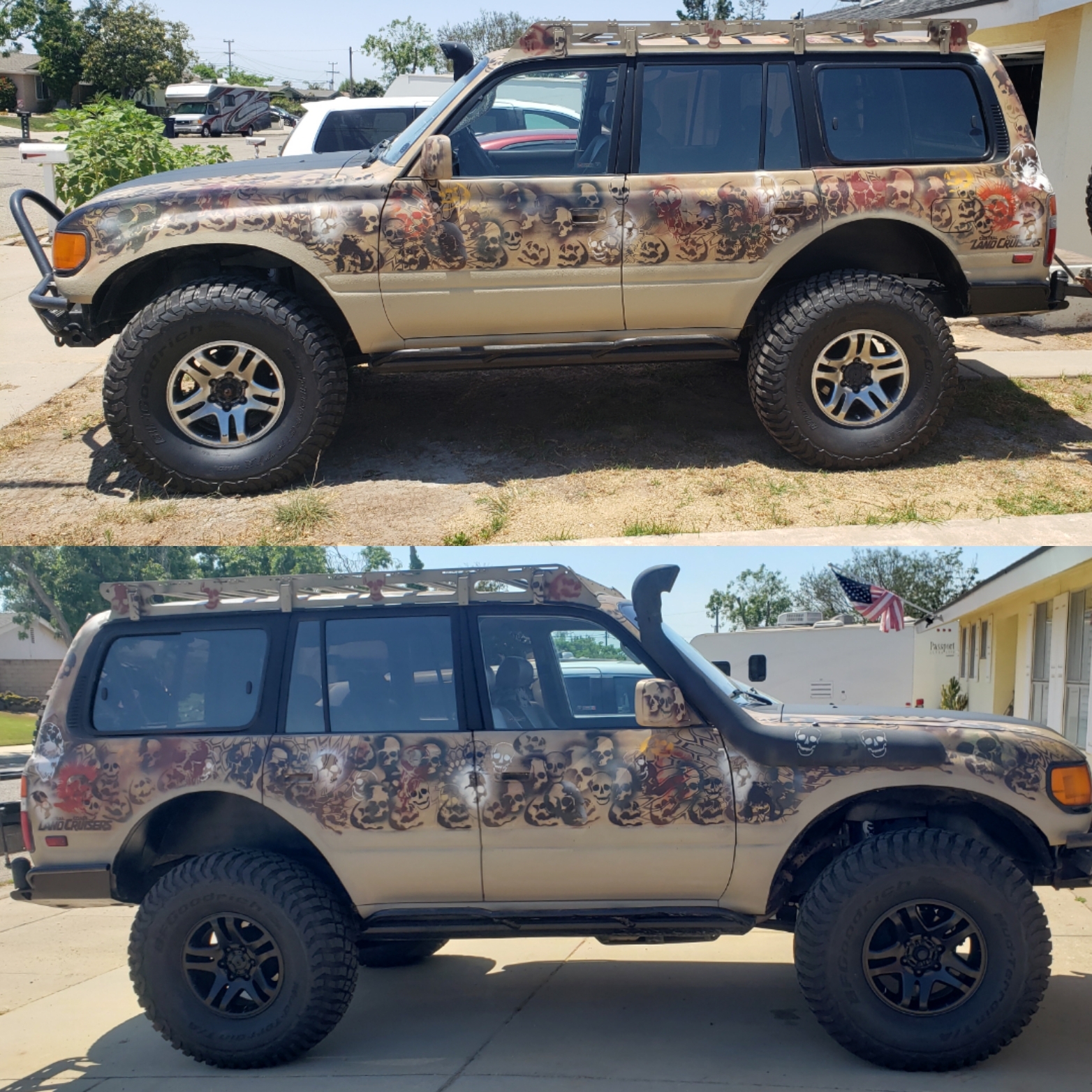

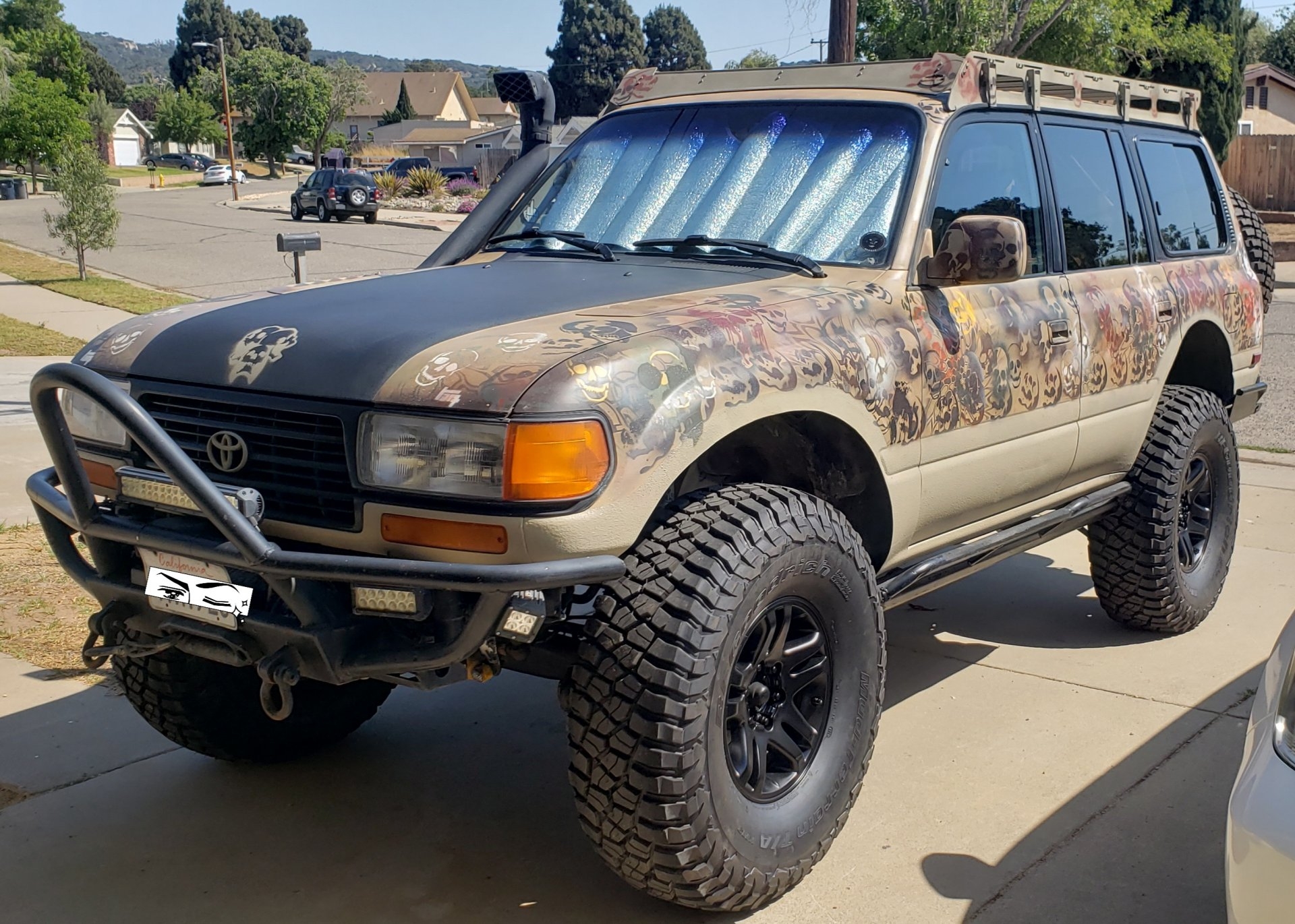

Getting ready for Rubithon. Been a minute since I've worked on the Cruiser. Got into an accident on the 101 after a tire blew out and caused me to go across 2 lanes of traffic and head on into a steel guardrail. Long story short ended up having my second back surgery in 7 years. Good news is nobody else was harmed and the surgery was successful with the exception that I'm not young anymore and I need to start taking it easy. Trail Tailor upper and lower control arms installed. Painted my Bowfin Cruiser rack to match and my wheels satin black. Also I sold my 38x13.5017 Falken Wildpeak mts stickies and finally mounted the 39x13.50r17km3 I won at Panamint Valley Days last year.

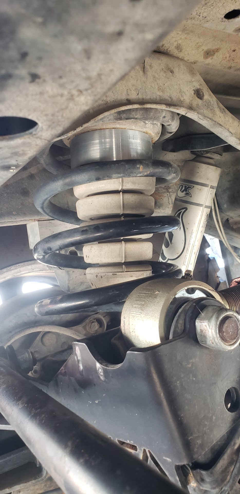

Nice, everyone seem to over look these. but they really help smooth out the ride in the big bumps !!
Did you make them ?
Had a buddy hook me up. But yeah, the progressive bump is often overlooked!
Got one myself and really like it.
