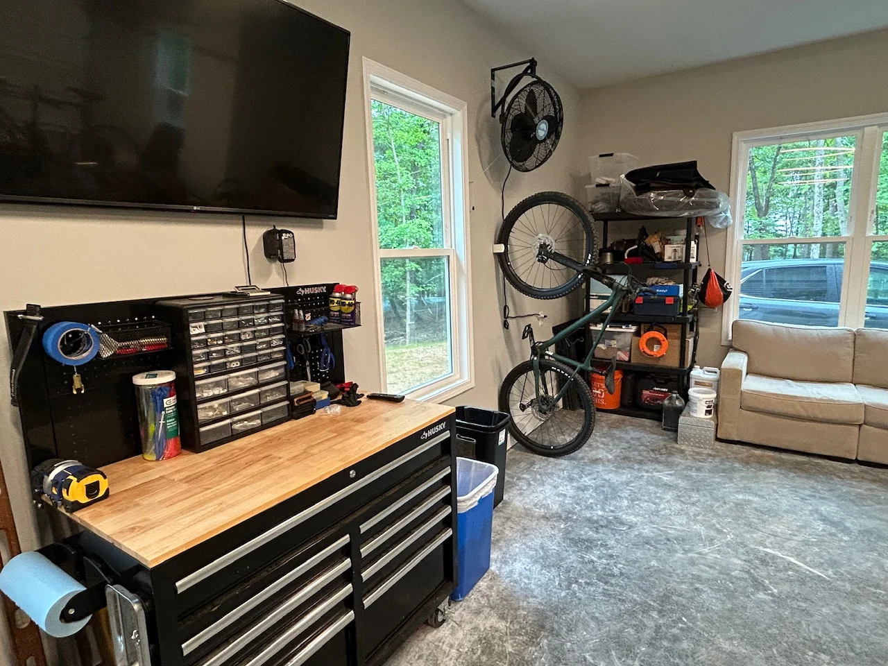

I'm a fan of the Hornit Clug bike racks.
Have you considered any fans? I've been using Air King for years and just installed two 20" fans in my new 3.5 car garage.

Thanks. Best part on the mount is its simplicity. I'll finish up a ride and pop the bike in place and walk away. I also like the Helmetor wall-mounted helmet mount. Similar in concept if it's something you may be interested in.
Fans do a great job. In addition to the garage doors, I have six windows that I'll open up for flow. With the fans going, it's great. Do you know if the garage is insulated? Sorry if I missed it. Going to be tough with a split if not. I plan to put one in mine at some point, but even with the super hot couple of days we've had, fans hold up.
