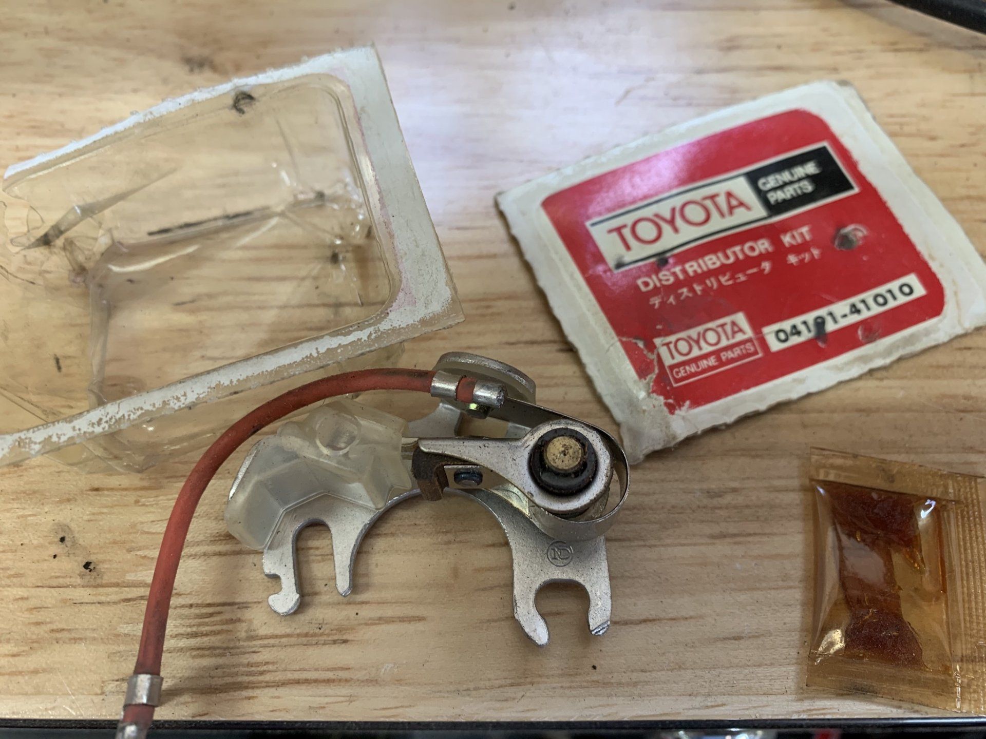

I woke up at 3AM this morning with an epiphany. The points have a plastic “cover” over where the contactor is and I am embarrassed to admit that I was setting gap on the wrong end! I gapped them at .018 and she fired right up.
The old contactor was worn down badly. I can’t believe I had this new old stock set on the shelf.
Thanks again for everyone’s help. I learned something totally new with this. Now back to driving my favorite 40.

Although the contactor looked old and cooked, I think the gap must have gradually changed until it finally closed and couldn’t deliver consistent spark. I’ve read that they need to be regapped periodically, which is why most people replace them to avoid another PITA mechanical part to maintain. I knew nothing about points two days ago. Now I’m kind of a fan of the simplicity.
