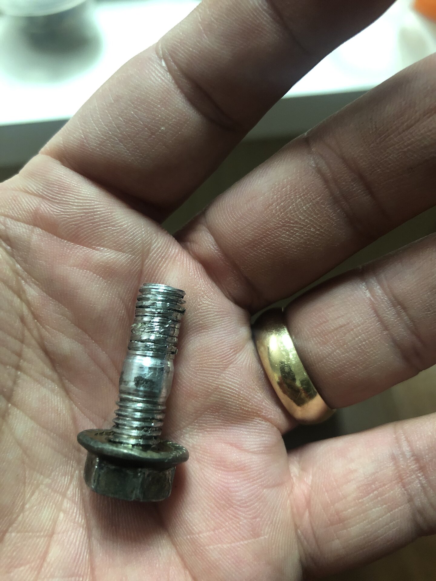

Finding a stud bolt to replace this one has been about as frustrating as removing and reinstalling the fan clutch behind the shroud. I can’t find them anywhere and CruiserParts are out of stock.
It would help if we knew where it came from; is this the EGR stud, water pump mounting stud or fan clutch stud. Or something else entirely?

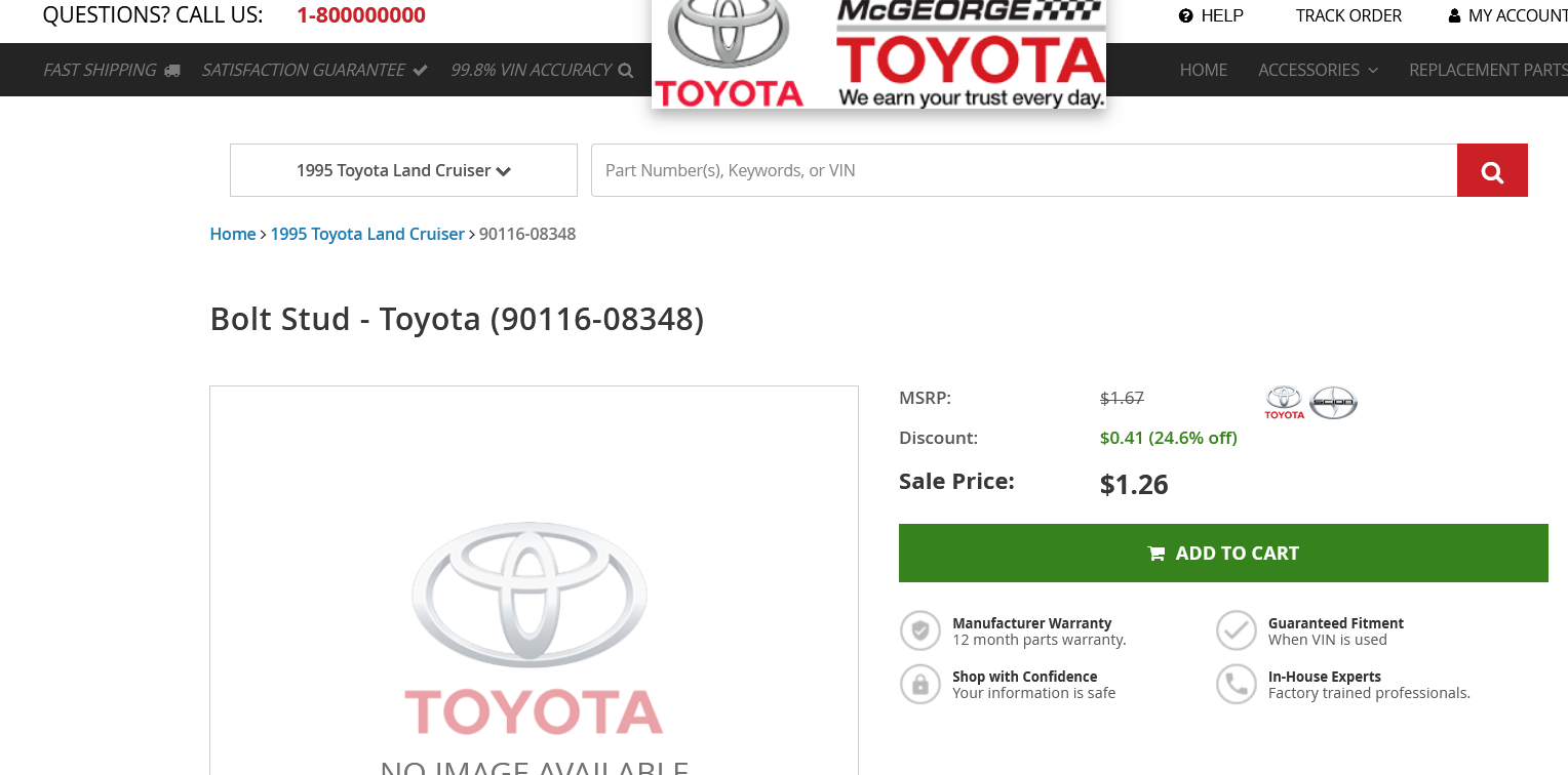

The water pump mounting studs are available:
These should be M8 x 60-mm long.
The fan clutch studs are not listed separately; they are mounted on the water pump.
The EGR studs are:
These are also M8, but I can't remember how long.
Those aren't supposed to be removed/removable. IIRC, they are peened on the back side to keep them in place.
I'd suggest you use the EGR studs. They have external Torx ends to use to insert/withdraw them. Run them in until they bottom out.
Appreciate the info. Yeah. It definitely wasn’t my intention to remove the stud, but it came out with the nut.
