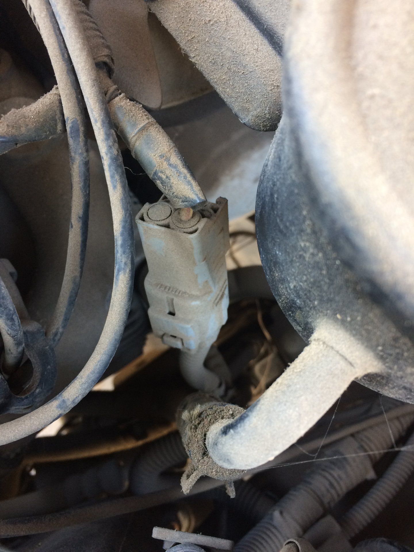

Found that the ignition fuse had no power. Fuse was good. Jumped a wire from the rear heater fuse up to the ignition and now she runs. Not sure what is going on with the ignition wire but at keasli found the culprit . Southern engineering picture attached.
Check continuity across the socket pictured. It supplies B+ to the ECU. If it fails you will NOT get a Check Engine light when turning the key to RUN! Mine failed on the lower pin’s crimp. I was dead in the water until we jumpered a B+ lead from the battery to the ECU. You could pull off your jumper and try jumpering over this socket. It is right in front of the OS resevour.
