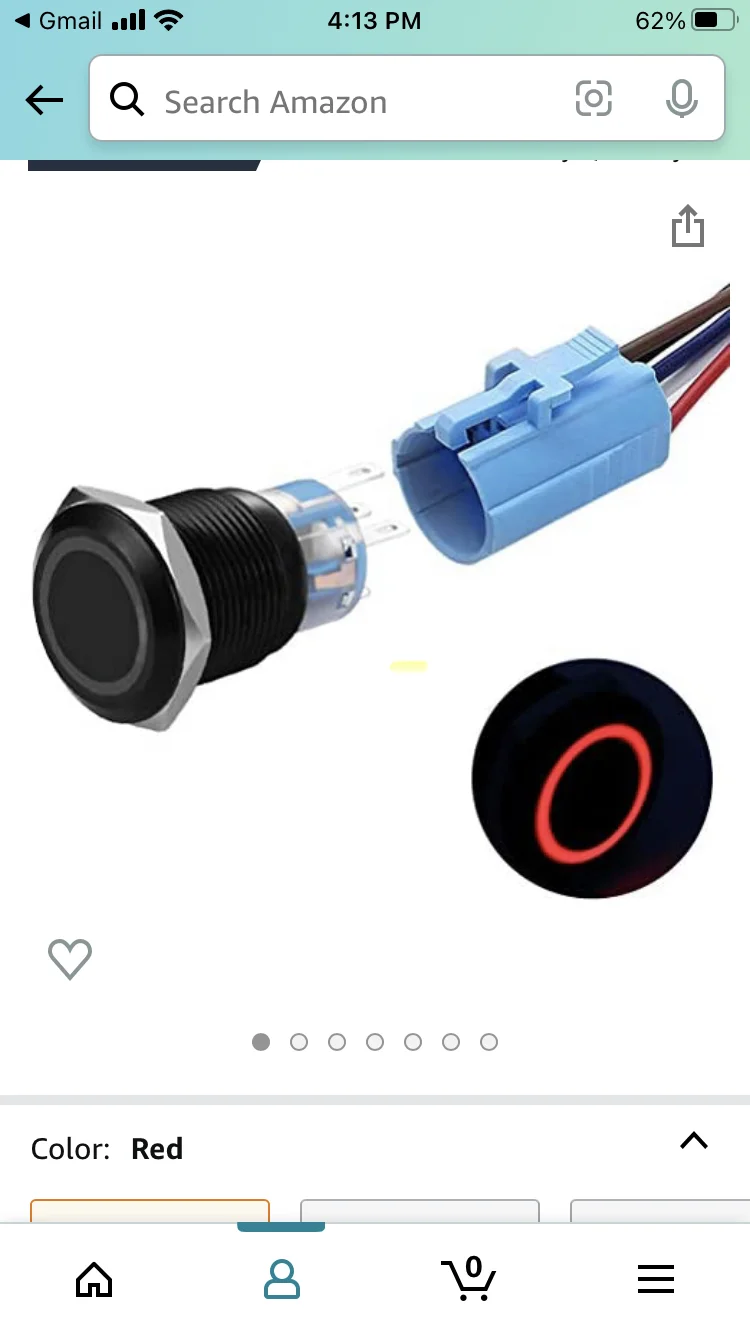

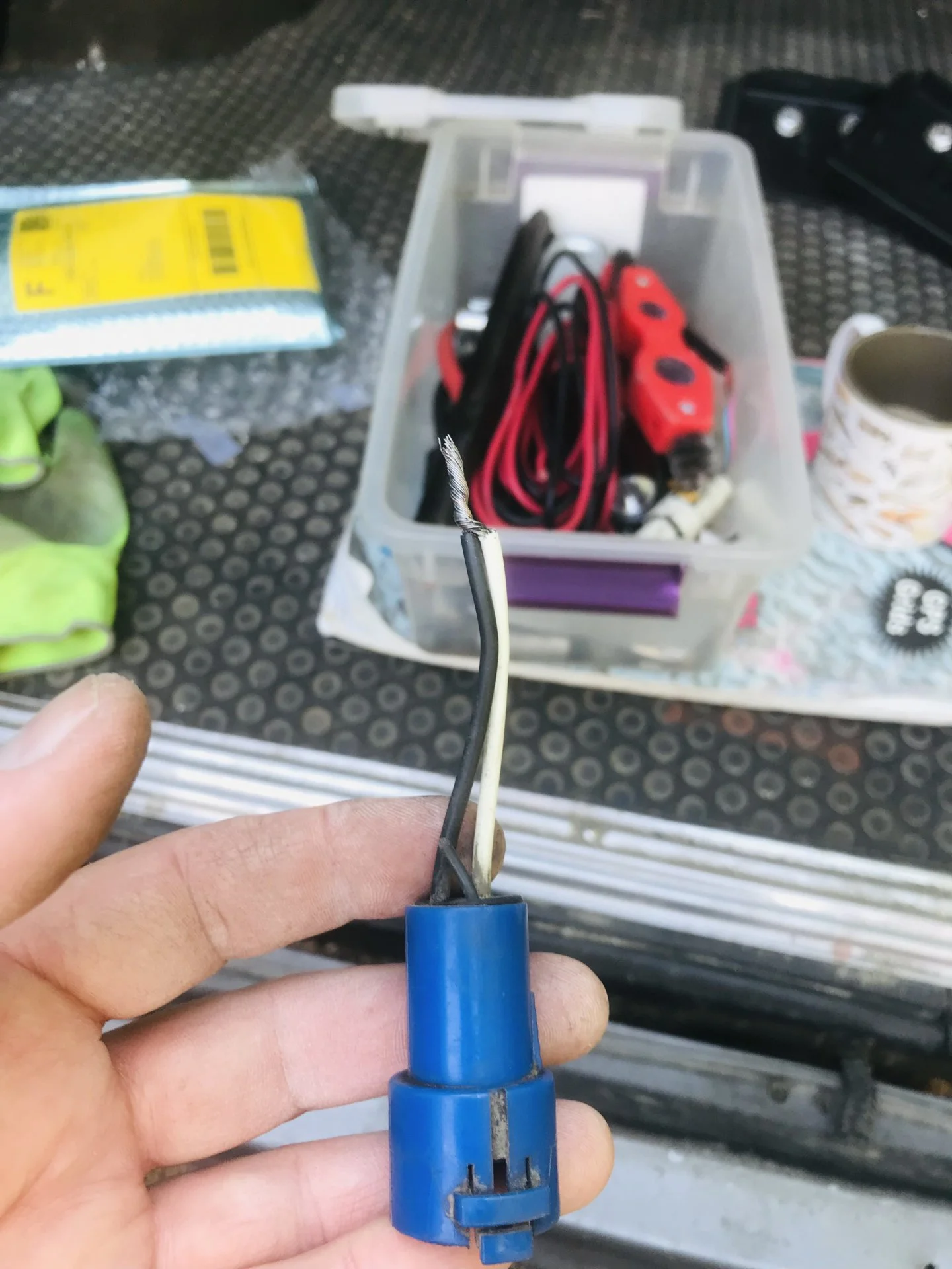

moving on from the ordeal. next order of buzz. wire in a kill switch.
i plan to tap into the old NSS circuit from the automatic transmission
i will extend off from those wires and insert a push button switch in a place that only me and my wife and fishing buddy will know about.

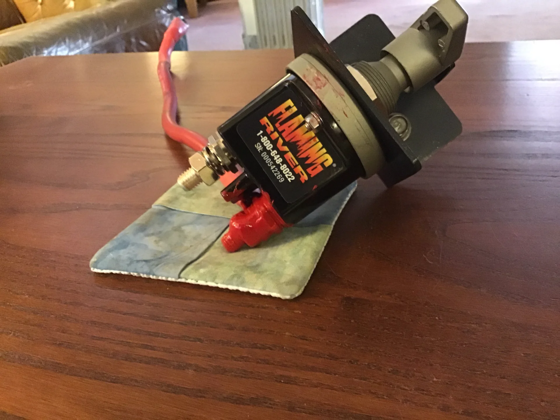

@Paul DiNapoli here is a great Kill Switch that uses a padlock for extra security. About $75 on Amazon.

would you be willing to share a few more photos of that thing? am i right in assuming that goes under the hood somewhere? does it just disconnect all power from the rest of the rig? (if i'm understanding how that thing works??)

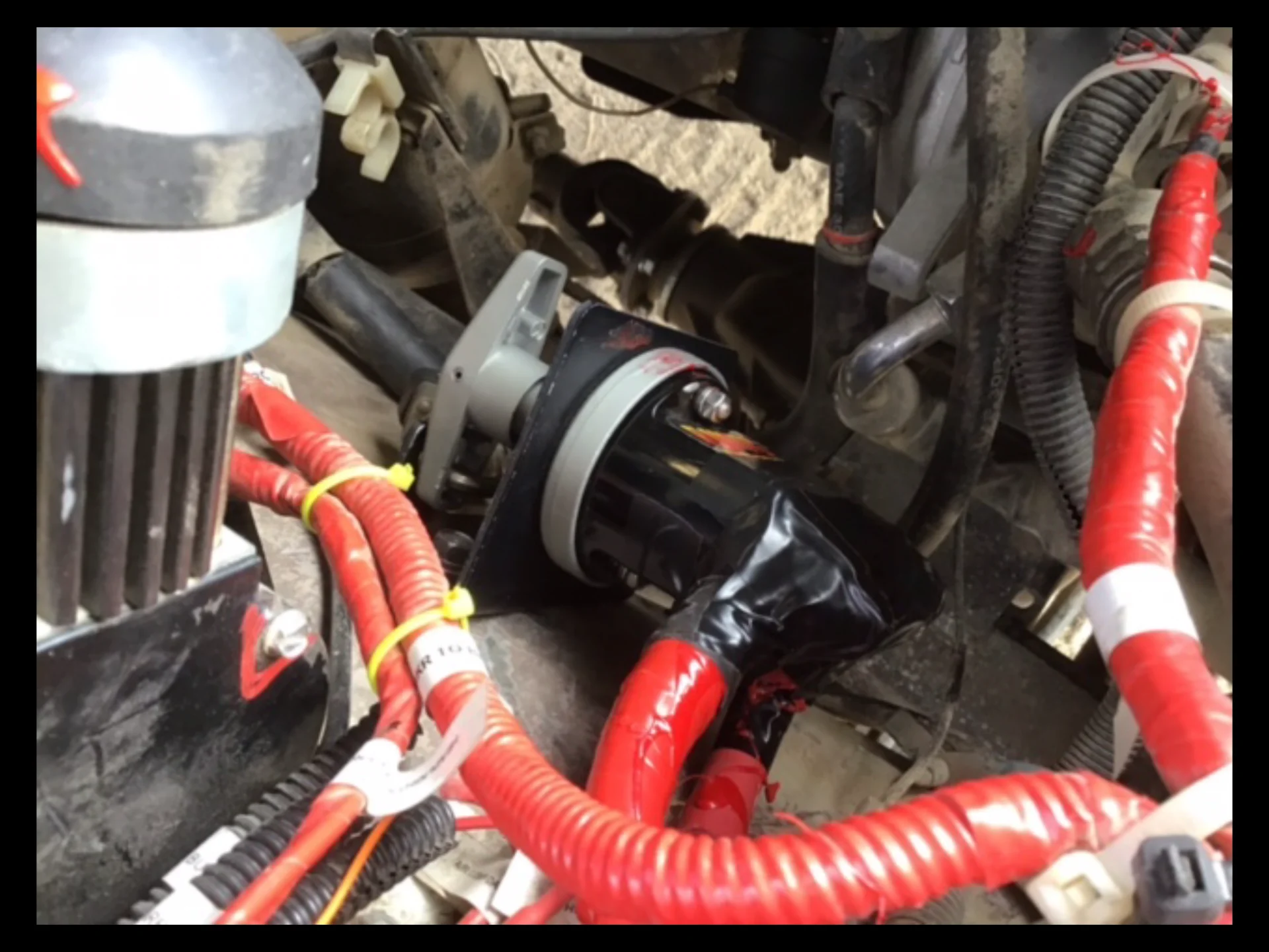

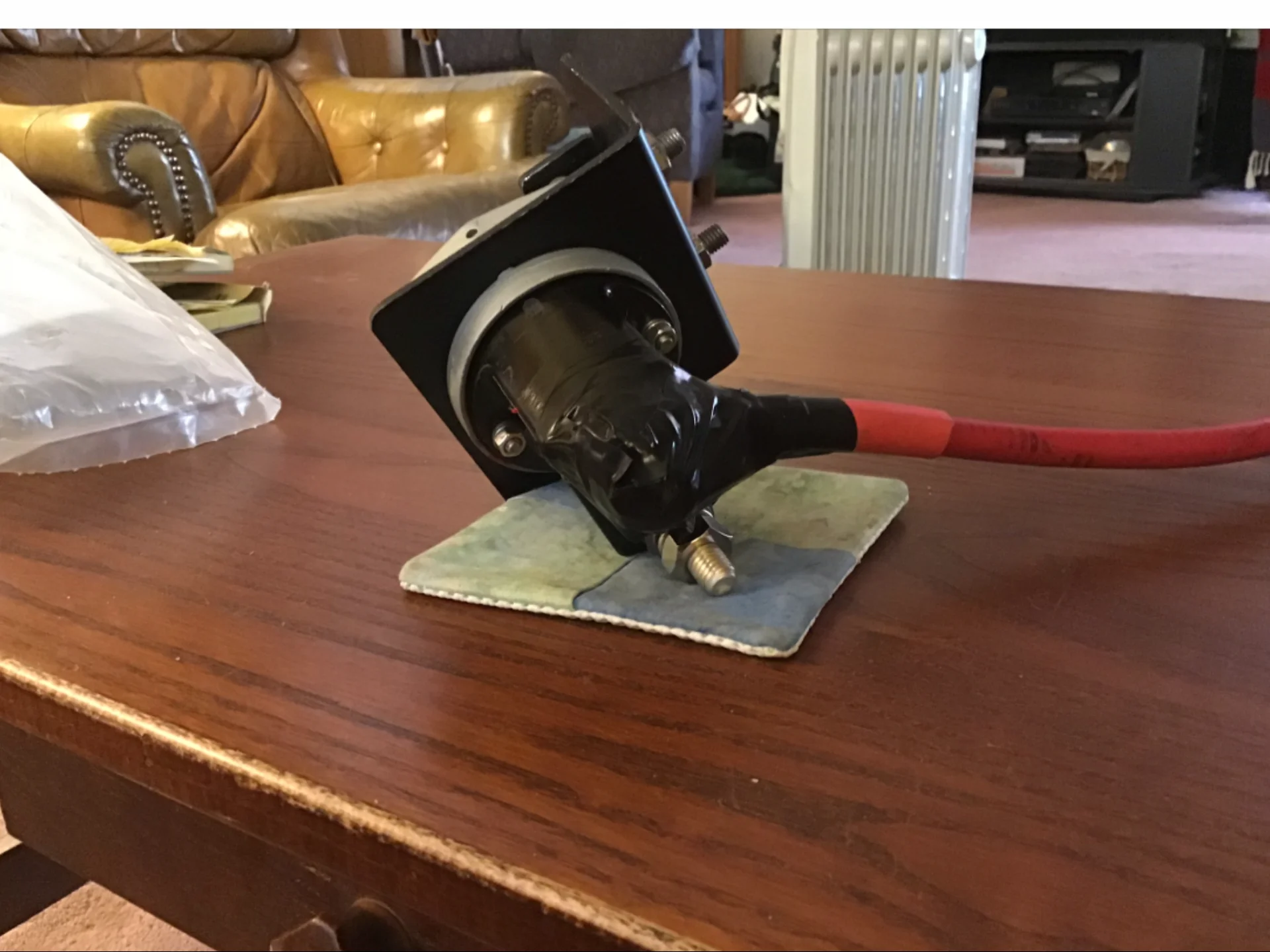

@Paul DiNapoli Here‘s a couple more pic. This shuts off power from your positive lug on your battery down to your starter.
When you have it ‘on’ everything works except your starter. Turn the key, everything lights up, radio is on etc…it just sounds as if you have a dead battery. It is not impossible to work around it…but if you get the one with a padlock it makes it more difficult/time consuming.
I feel much better having it than not having it. Think about Apple AirTags or similar…in addition to this item. In your described situation, if you had Airtags…and an iPhone, you likely could have driven to your stolen rig almost immediately.

got it...it sits inline on the main line between battery and starter motor.... that's what i was after. in the open position - everything has juice...just nothing to turn over ther starter.
