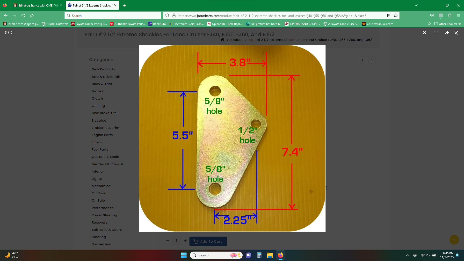

I Just realized when I scrolled thru the pictures on JT Outfitters site there is a picture with dimensions:
My current OME anti Inversion shackles measure 3 1/8" center to center pin to pin. Theirs are 5.5"
