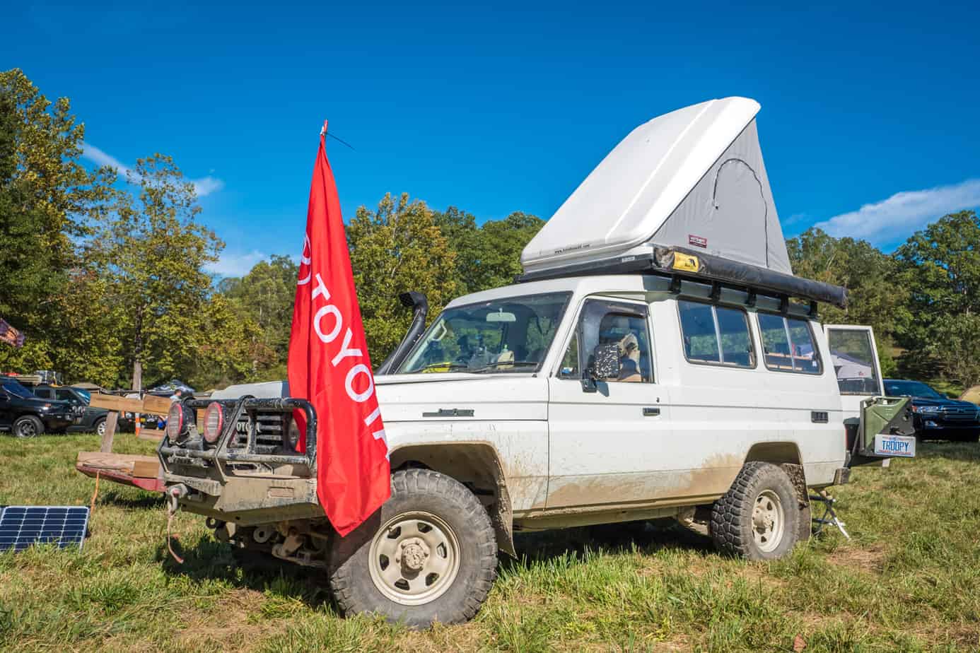

So in the spirit of christmas and in case someone wins the lottery and wants to contribute to the build, the next big things that are being budgeted for are as follows.
1) Injection pump rebuild and Turbo install. Intercooled and limited to 10 PSI. Speaking to Rob from odd iron about this currently. Want to maintain a high degree of reliability, but need a tad bit more power, it really struggles to keep 65 when in rolling hills, its a little dangerous dropping down into the 50s when the speed limit is 70
2) Alucab Hercules pop top conversion.... ok4wd has the kits in stock. but its $$$$.... maybe one day
3) RV setup for the rear. @fireball i know we have been talking... and i cant wait.... ill reach out via email again to give an expectation on when... talked to the wife and shes onboard.
