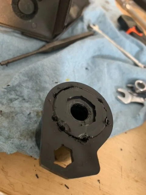

4. Remove the small plated screw holding the dampener cap in place ( sorry forgot to photo that). Now for the fun part.
The cap has indentations for whatever assembly tool they used to screw it on. The cap is threaded. Ideally someone would find a similar sized die that fits the recess and try to unscrew the cap. I didnt. as was previously described, removing the cap gets ugly. Hint, there are 3 recesses on the cap youd need to work around with a thin flat ( but strong) prying tool. Choose your precision flat blade wisely. The cap will eventually start to lift. Paint mark the hole for the cap screw, it'll be unrecognizable when you're done.
a savaged dampener cap
