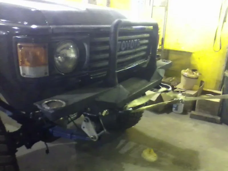

I also installed the front bumper again to prevent the front of the truck from getting damaged while being towed around the property. I cut out some of the tubing to allow it to fit without the 2" body lift, but it still needs to get some finish grinding.
I also plan on welding in a receiver so as to have a removable winch.

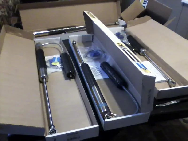

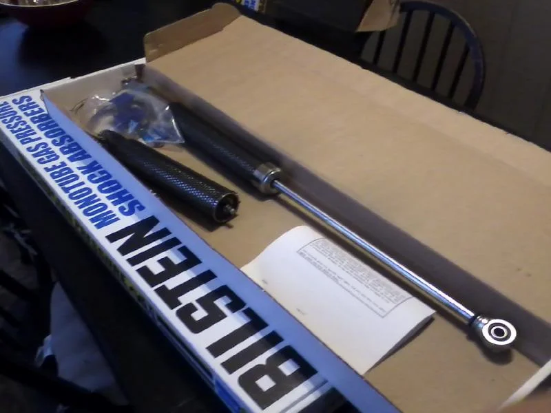

They were a little on the pricey side, but the fact that they're revalveable and rebuildable makes them worth it.
I purchased them from eshocks.com, really good customer service and nice guys.

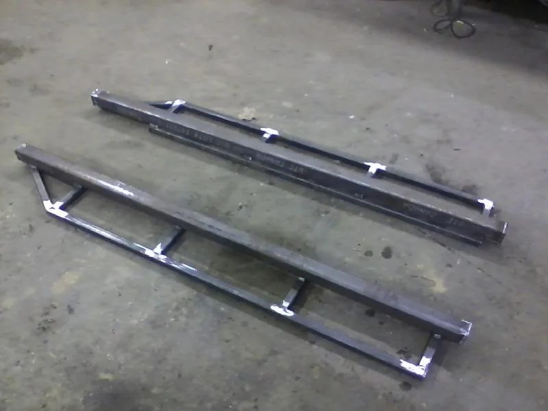

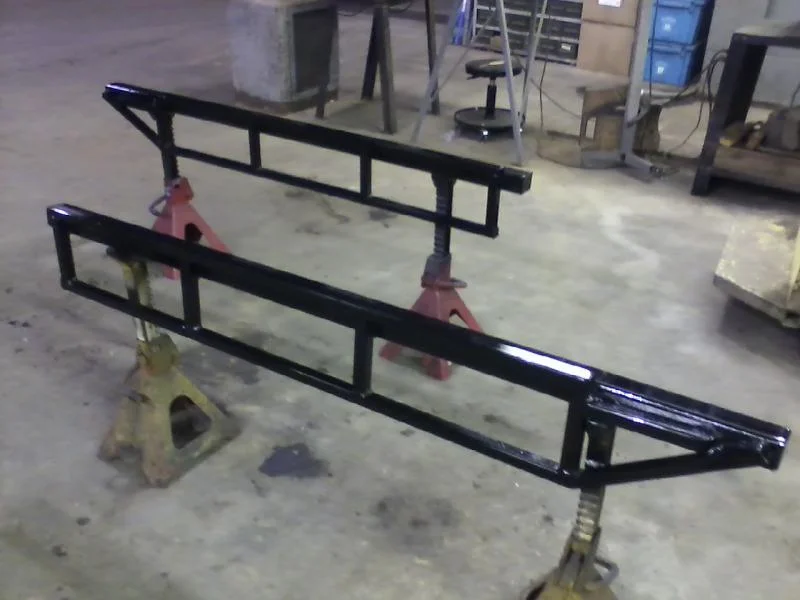

Well I was hoping to get those shocks installed tonight, however there wasn't anyone around to help me pull the truck in so I decided to tackle another project I didn't plan on doing for a while.
Using a bunch of scrap metal in the shop I made a set of sliders. The nice thing is I really need a step to get into the truck so these will double as that.

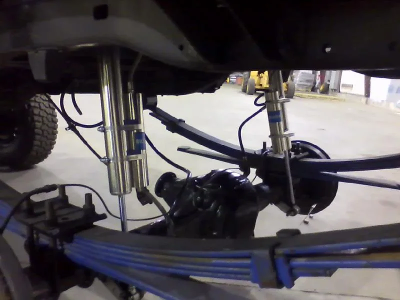

I had a little bit of shop time tonight and got the rear axle wrapped up.

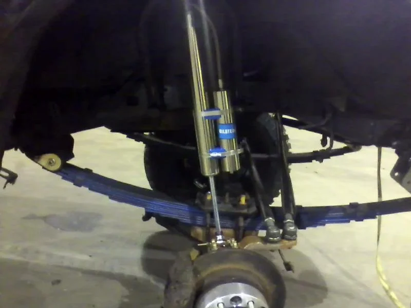

Shocks are installed and looking good. I originally wasn't planning to run reservoir shocks so I had to take a hammer to the gas tank to clear the reservoir fitting.
I also lengthened the lower shock mount tabs to give me more clearance on the axle itself.
The 360/80 valving seems to be working out nicely, just from riding in the truck to steer it out of the shop I could feel a noticeable difference.
The ride is amazing, the rear shocks are firm but not stiff. Any bumps are easily absorbed by the suspension and shocks.
There is no jarring or rattling that I am used to from the old suspension.
Later in the week I plan on finishing the front brakes, and installing the front shocks.
I may even get the engine running this weekend. :D

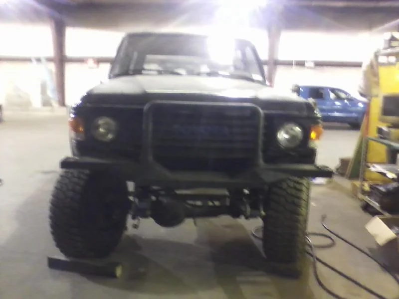

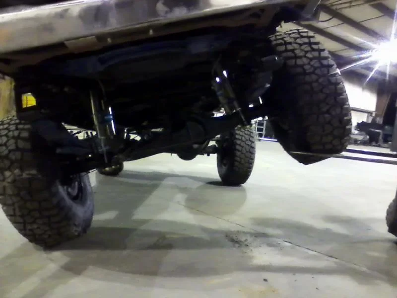

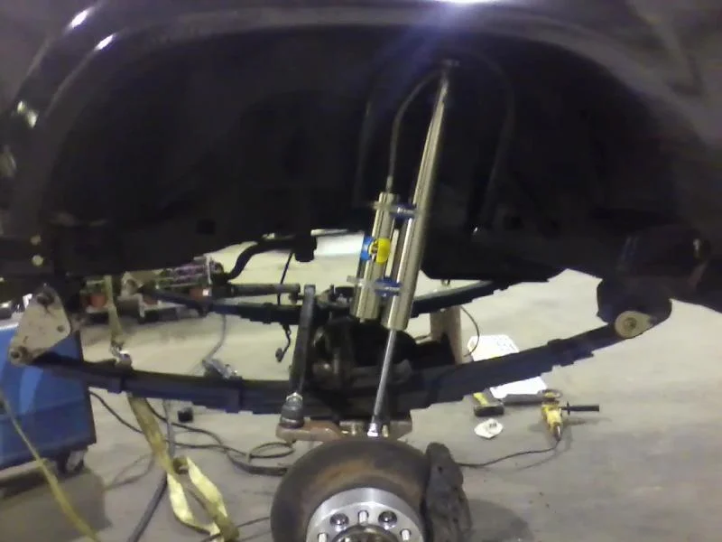

Front, 4Runner calipers installed tonight along with the front shock hoops and shocks.
Tomorrow I'll route the front brake lines and install the new 4Runner MC.
Pics of the shiny new shocks installed. They look like they are set at different angles in the pictures, but in reality they aren't its the way I was standing that makes them look that way.
