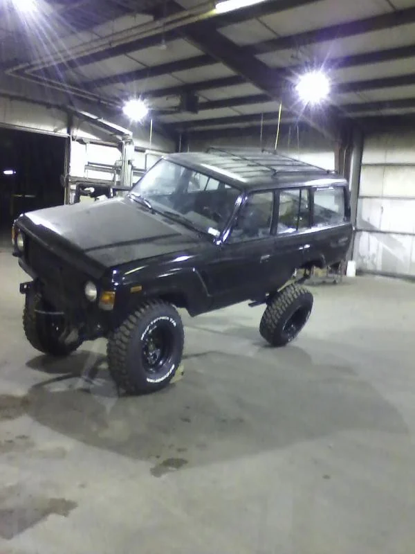

It is a little bit big.
I like it though, there is plenty of room to take advantage of the flexiness of the suspension now.
When I swap the Cummins in I'll probably end up running 37" tires.
I wish I had the budget for 40's. But I can't afford to regear and buy some right now.
Maybe sometime down the road.
Yeah, you know it.

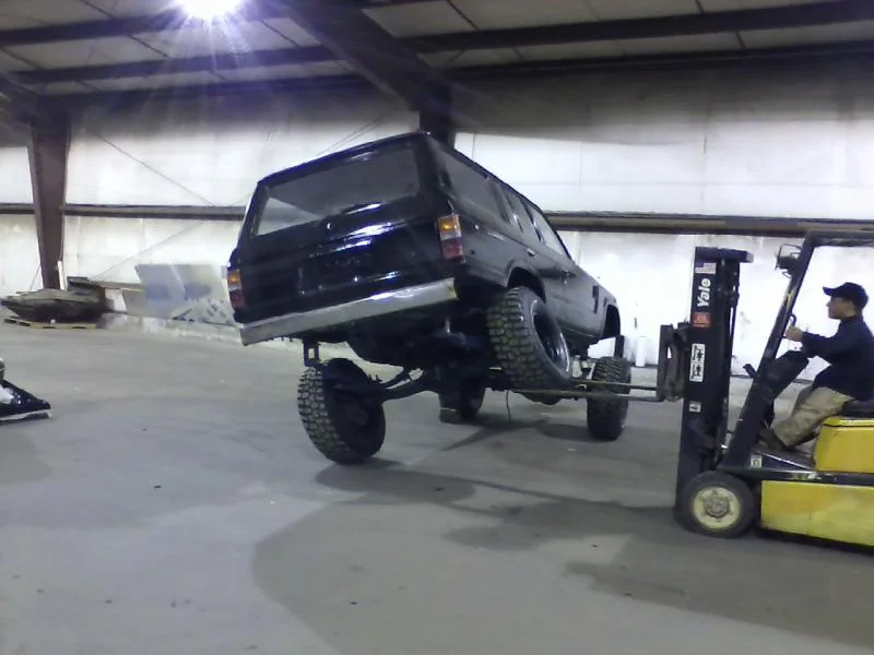

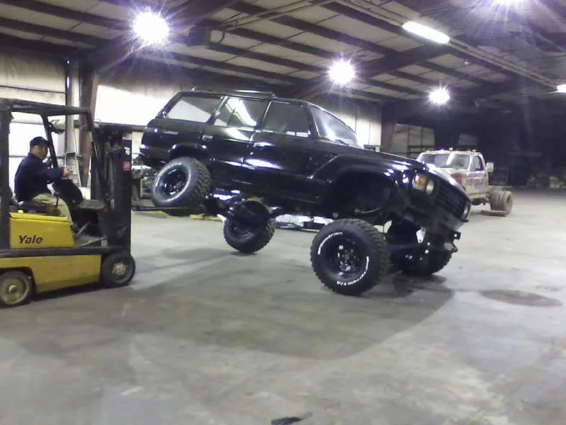

I also did some flex testing.
I have to say those 63" chevy springs sure do flex nice.
Using a forklift I raised the rear passenger tire 32" at that height both front tires were still planted firmly on the ground. I can go higher for sure but I am going to wait until the rear suspension is fully welded before attempting it.

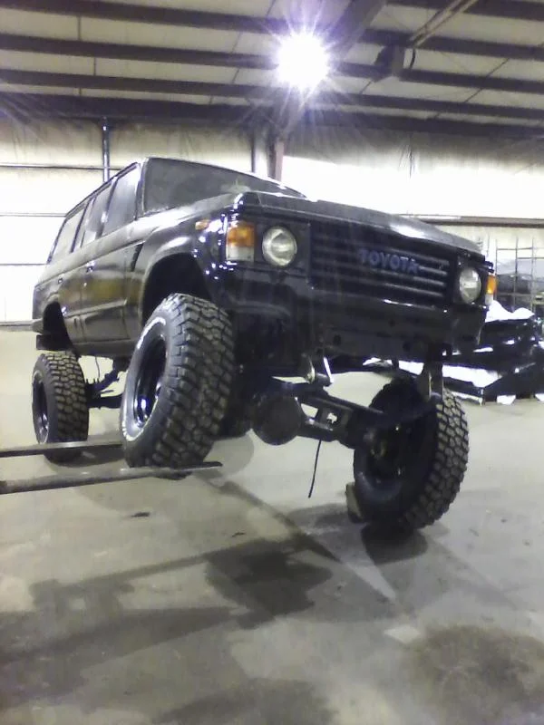

37's look tini-tiny
But look great stuffed in the front...
40+ fo show..
That's one tall MOFO !!
Great work man !!!
Hey thanks, It's actually got 35's on it now, Its gonna get bumped to 37's later. I don't plan on runnin and 40's but you never know.
Nice flex dude
Can't wait to see this thing in the sunlight on a trail! The black will look even more badass
You'd get more flex out of the front end if you took a couple of leafs out.
Other than that, she looks great:smokin:
There is still plenty flex to be had in the front, honestly I want to drive it before I decide to adjust the suspension.
Understandable. I'd want it back on the road too.
I'm finding with moonshine that even with the potential for more flex, it's very difficult to achieve with stiff springs. I'm setting my suspension up to be as soft as possible while still holding the weight I need it to. I intend to take a couple more leaves out of my rear springs in not too long.
Either way, adjusting is fun, but driving is better. What do you have left on your list?
