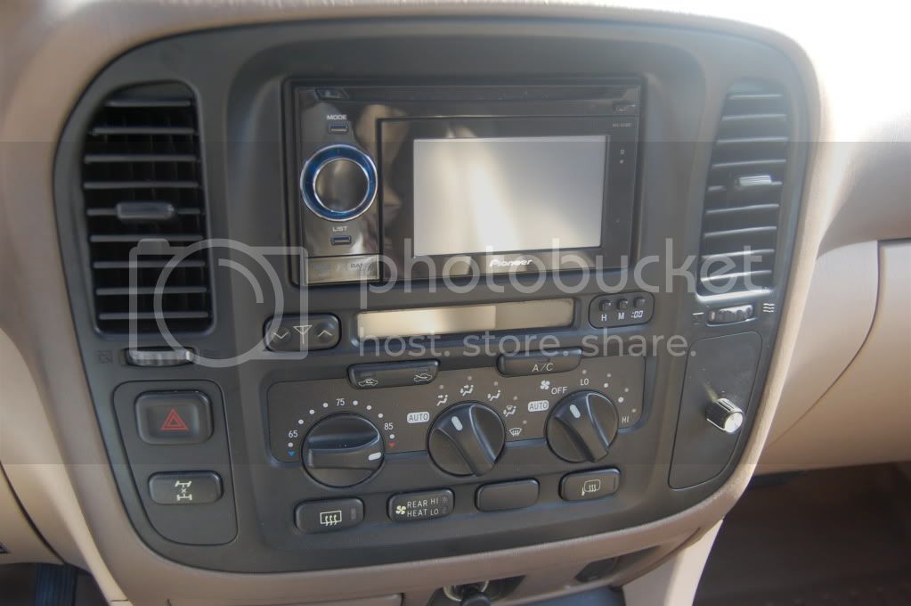

Example of Single Din replacement
Pioneer 4000 - inexpensive choice, but I can plug in my MP3 player in the glove box with the USB adapter and it has Bluetooth for the phone - if I ever decide to use it.
I wanted an AVIC unit, but the hand held GPS units are more portable on trails and less expensive. $150 vs. $1900 - saving for other mods and I love the added shelf for a wallet or maps.
Purchased at Crutchfield.com and they included the DIN shelf under the unit and the harness adapter for free. The Remote is sitting in the slot, great for backseat stereo drivers :princess:
I was nervous at first, but this thread made this job a :banana:

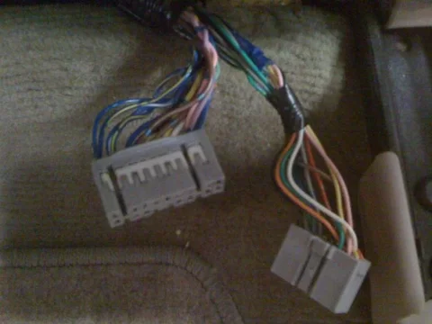

well with the help of a few mates I got it all installed...
the cable they send out plugs in perfectly... the speaker wires all correspond but the other 4 wires that come with are USELESS.. they dont go to any power source etc... you have to find the other 3 wires needed (power constant, power switched & ground) out of the 2nd harness that provides power to the amplifier then from there to the head unit...
so we had to pop 3 of the wires out and place2 of them in different spots in that harness then place the 3rd into the 2nd harness as a jumper to get constant power I believe...
all in all was really straight forward...

factory harness to amplifier... the smaller one is the one you pull the power from I believe

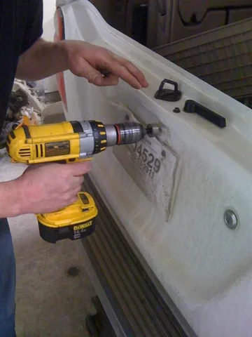

drilling for a rear camera

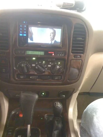

finished install
