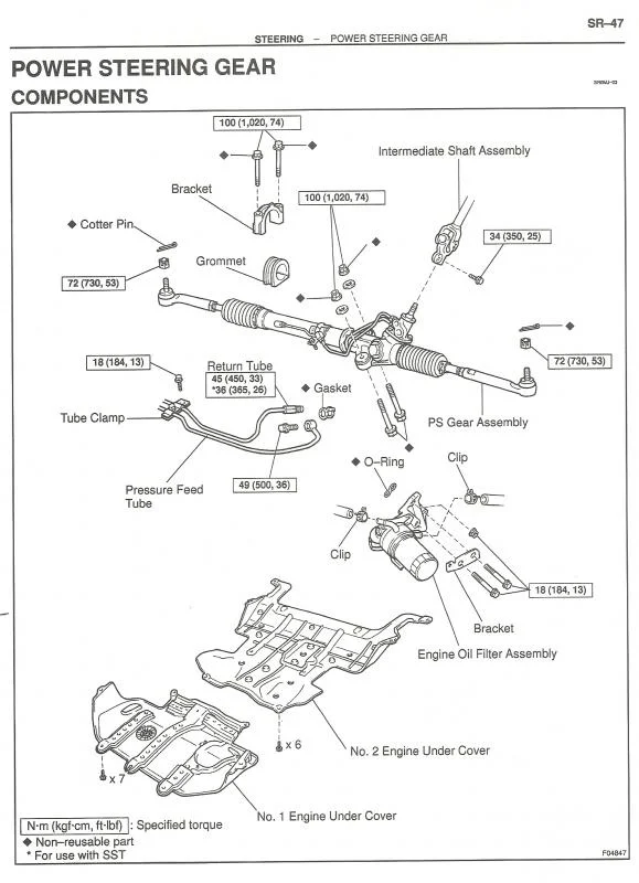

The online parts diagrams don't show it, but the FSM (at least for my MY2000) show that the 4 bolts and 2 nuts used to anchor the PS gear are not re-useable. FYI, and plan ahead when you order the bushing to order some bolts/nuts from your favorite Toyota source as well.

I did post a few pages from the FSM on another thread - I still don't see *why* the steering rack is difficult. But I'm beginning to believe you guys and will refrain from taking this on as a challenge. If anyone has done this, curious what makes it a pain.
On first glance it seems simple - since I'm pulling off the hub, removing the rack mounts and tie rod ends - rack removal looked like a few more steps (remove hose and steering link) - but obviously there is more to it . . .
