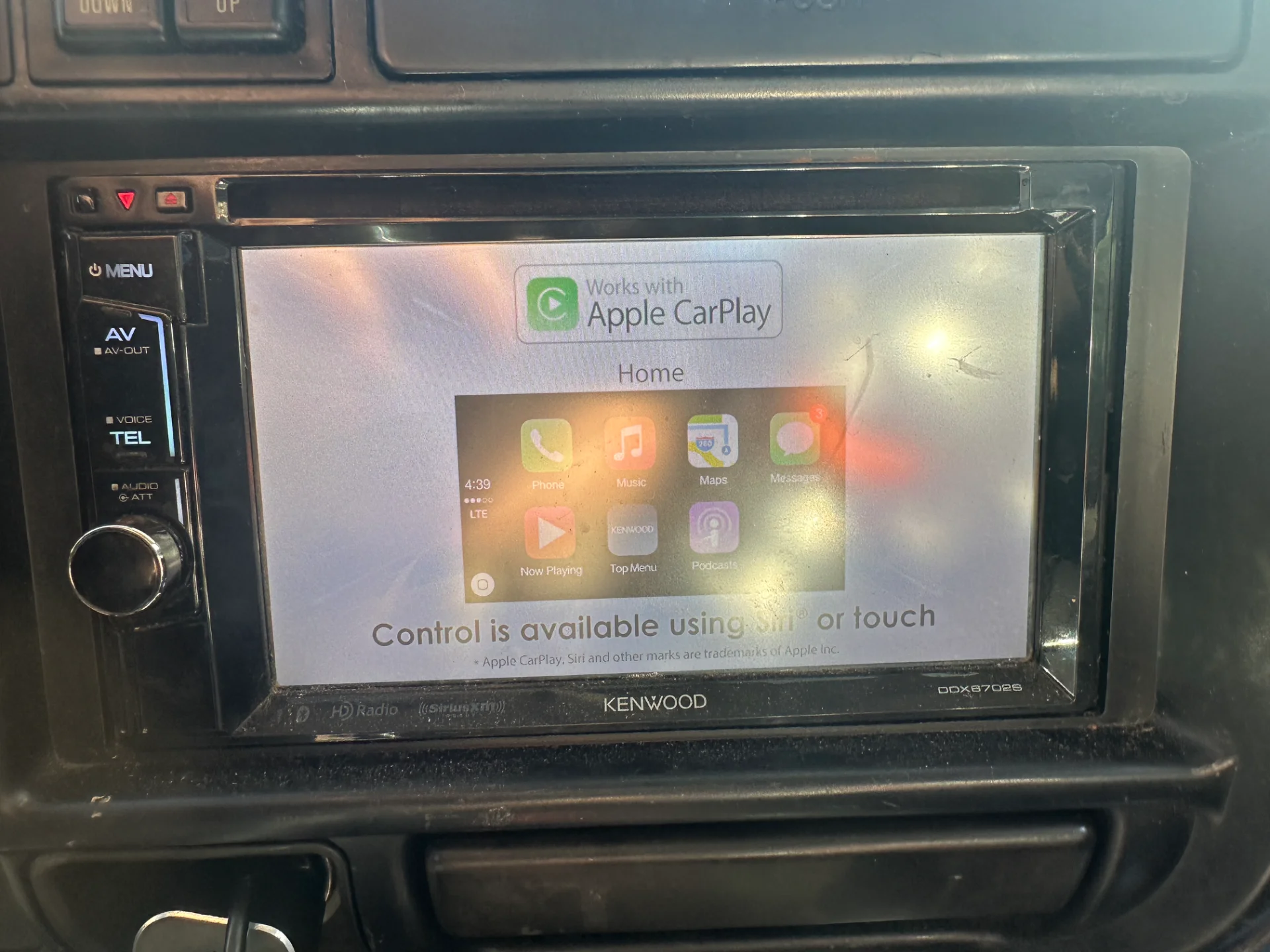

yesterday i got in and it barely didn't start and i heard an audible "mechanical" noise - i almost want to say solenoid but i had one of the higher voltage OEM rebuilt starter put in from a toyota website like five years ago - and i see the radio startup dialog was on the next time i got in the truck.
i only see this when i lose battery power by disconnecting the cables.
