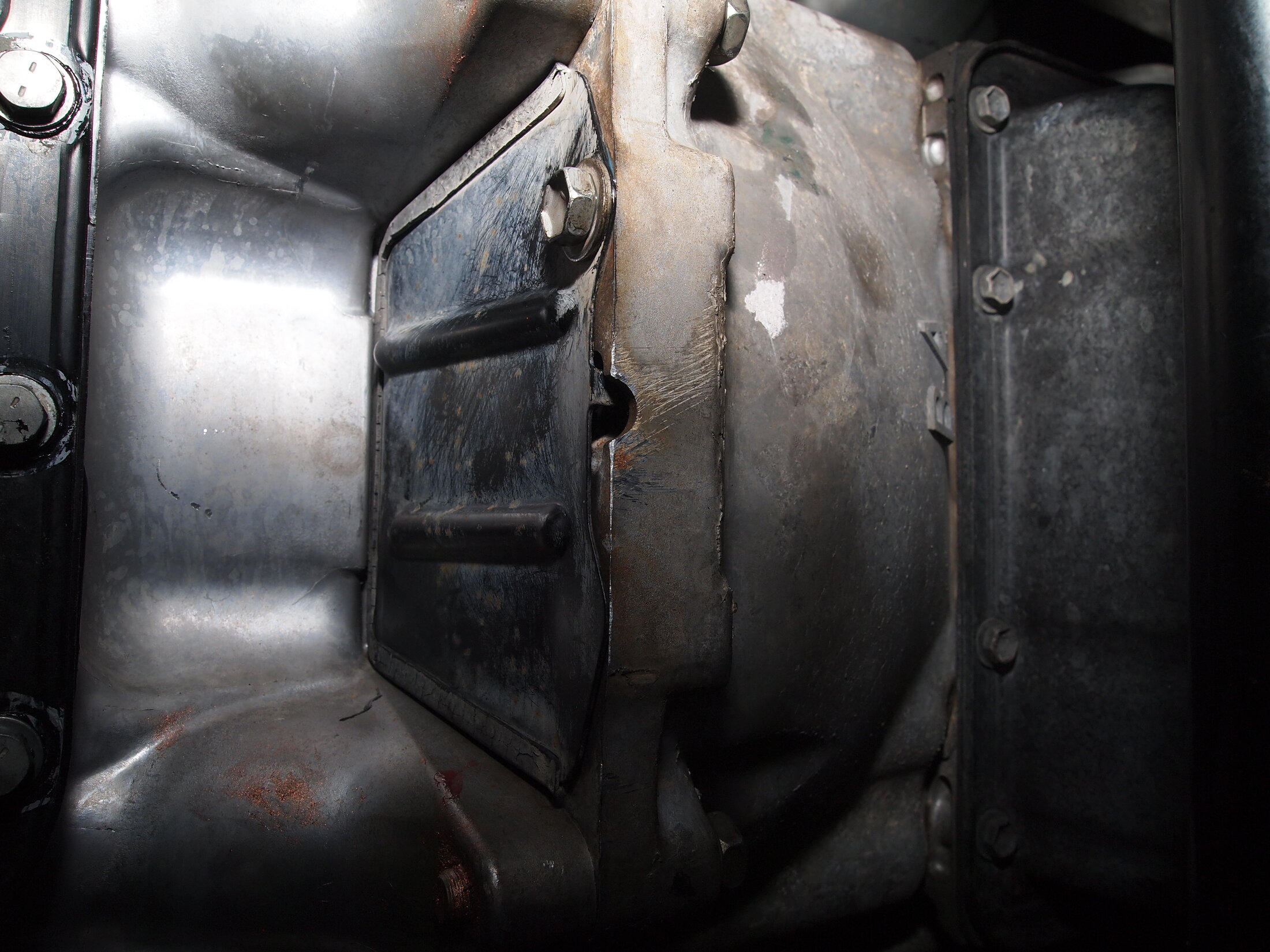

You can pull bellhousing inspection plate and look at flex plate. If flexplate busting apart, seems you'd see some metal fragments, in bottom of bellhousing. You can also turn the crank with 22mm socket, placed on front crank bolt. Then inspect each flexplate to Torque Converter (TC) bolts. A bore scope can be used to see close the center of flex plate, for break.
If flex plate was and new is, indeed busted aging. And was properly installed. Then yes, you've either some issue with TC or even Auto Transmission (AT), like possibly front bearing of output shaft OR a crankshaft issue. If front bearing in AT, you'd likely see AT fluid leak at bellhousing (inspection plate) weep hole. If a crankshaft vibration issue. You'd likely see rear main engine oil leak.

Bellhousing inspection plate.
