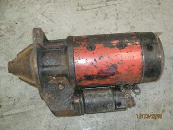

What i am looking for right now is a Starter Solenoid for the B engine starter as the 3B starter does NOT fit.
So its either finding that solenoid or going ahead and changing out the back plate and everything i need to fit the 3B starter(which i can get brand new from the local Toyota dealership...for a hefty sum of 560 Euros).
3B parts i can find...its the parts for the B engine that i am not finding parts for.

I found the correct Solenoid(it is still being made)! Just took a bit of research on my part and calling to a couple of companies here in Finland to see if they could find it from their suppliers.
So no need(for now) to change out the starter and back plate.

For anyone interested:
nippon denso 053400-1900
Manufacturer is: New Era and their number is SS-1709

Someone has been trying to sell a similar starter here for some time:
Toyota Dyna Diesel B Series Truck Starter Motor for sale - TradeMe.co.nz - New Zealand
Does it look the same as yours?

I have a 1977 B Diesel with the exact early style direct drive starter with 9 teeth as in the photo above. I think the solenoid is ok. My question is can I fit a Toyota Reman to my nose cone, such as 28100-54090-84 if I fit a new 9 tooth gear? Also, how difficult is it to remove the 9 tooth gear from the old starter? I looked at my other BJ 40 which is a 1980 and it has the gear reduction starter and the diameter is about 30MM and the 1977 direct drive starter is has a diameter of about 36MM.
1. So, can I fit a Toyota reman starter, if so what is the correct part number? Will the reman starter diameter be too small for my nose cone? How much trouble is it to change 9 tooth gear from the old starter to the reman starter?
2. Or is possible to fit a gear rediction starter? If so, do they all come with 11 tooth gear which necesitates a change to a 9 tooth?

I researched this a bit more and this is what I found so far. I think this is a Bosch E-82 Starter(direct drive) which had the discontinued Toyota Part number 28100-60062-84. Can anyone verify this? Can anyone verify the Kw specification?
I see that 28100-60062 is a 1kW 12V starter used on some 2F petrol landcruiser engines.
The "84" simply shows it was sold by Toyota as a "remanufactured unit" rather than brand new.

So with 12volts and 1 KW, its probably not going to turn over my B Diesel. Any idea on a part number for the B diesel version of that starter or would it be better to get a gear reduction starter (2.5KW)and change to a 9 tooth pinon gear? Do you have an idea of the part number for the correct gear reduction starter ? How diificult is it to change that pinon gear?:bang::bang::bang::bang:
I have located another Toyota part number that indicates that it is a Bosch direct drive starter, but with 2.0 KW. It is 28100-66060-84. Anyone know if this is correct?
Yes. I think that's a valid assumption.
The smallest (least powerful) starter Toyota fitted to a 2977cc B-diesel was 1.8kW I believe. And that starter was troublesome (from what I've read) and used till Sept 77 (Part number 28100-56020 subs 56021)

I would expect changing the cog on an existing starter drive to be either hard or impossible. (There is so much torque on that cog that I'd expect it to be cast-in-place or at least very securely held there.)
Sorry I can't be more helpful.
:cheers:
Thanks again! I think that you are right about the gear reduction starter, it seems to be well beyond my competence as well. I will try to get mine rebuilt or find a replacement on Monday.
