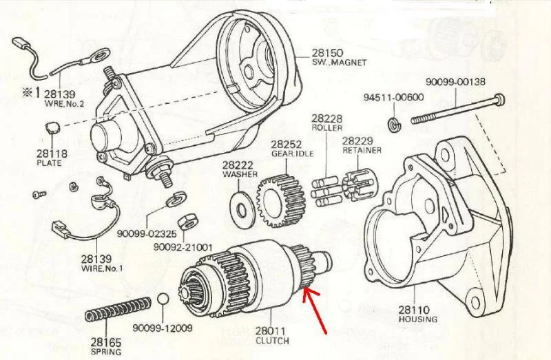

I'd be interesting in hearing the tech details of swapping starter drive cogs too.
More specifically .... Can this cog really be easily pulled off and replaced by another?:

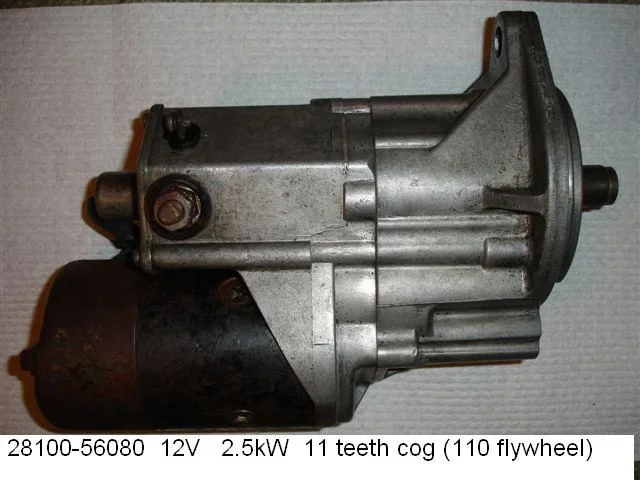

PS. The 3B gear-reduction starter under discussion is presumably this one (that I have on my B):

Thanks for the response! On Monday, I'm going to try to get my direct drive starter rebulit. If that fails and I can't find a replacement, I'm going to try a 3b gear reduction starter and install 9 tooth pinion gear.

Hi, I am in the same boat... I have owned a 77 cruiser down here in Costa Rica for the past 15 years. The only thing that is wrong with her is the starter. Luckily we have lots of hills to pop start it!!! I came across this thread a few months ago and finally found the reduction starter. I have the new 9 tooth gear... I am with the mechanic, and we just have one question, ...when we opened up the starter, I see that the new 9 tooth gear is shorter than the original 11 tooth. There is also a spacer on the end on the shaft. Do I simply put the 9 tooth gear on and put the spacer back??? Any and all help is appreciated...
