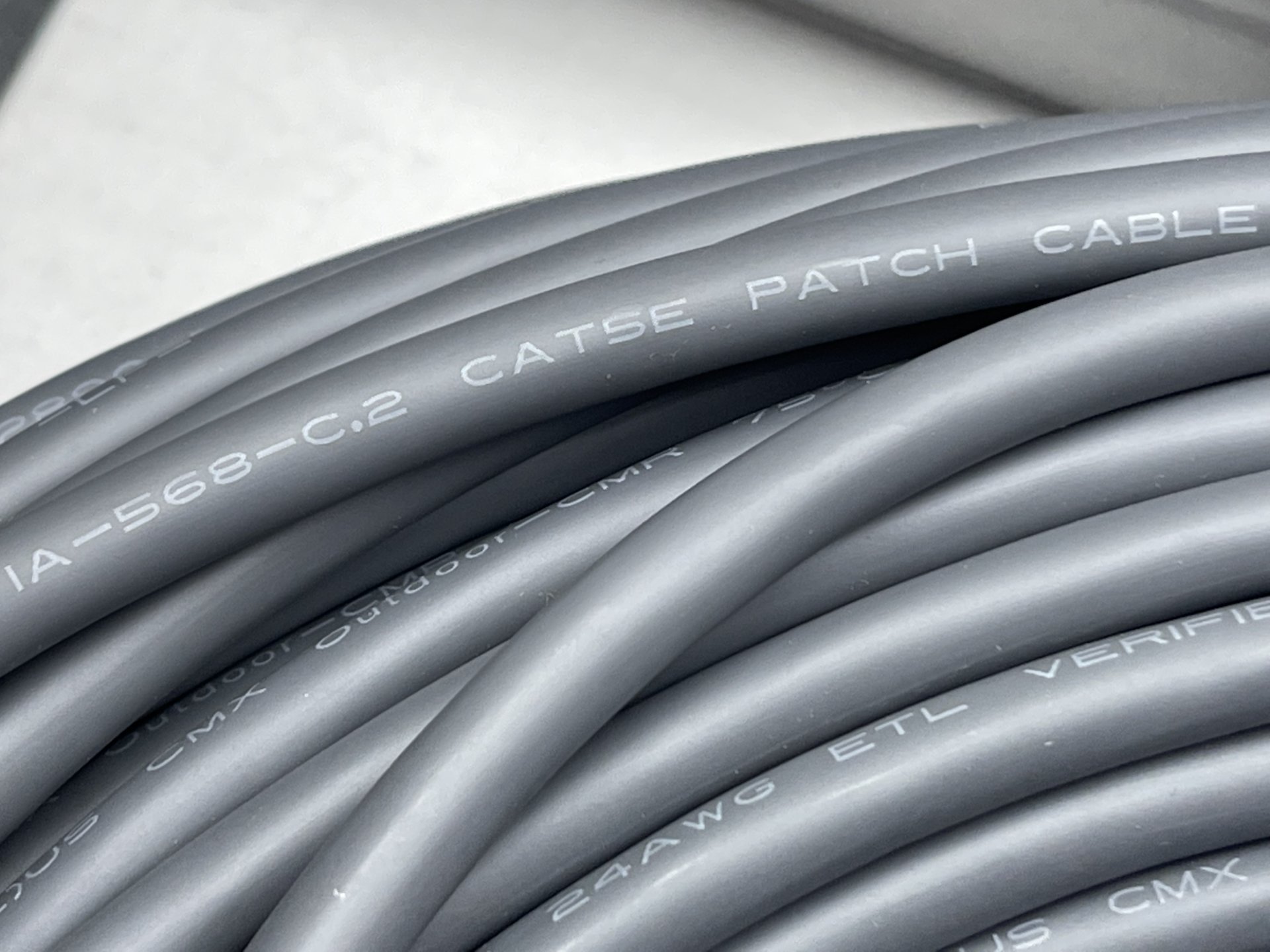

I believe was wrong, strange though, that's a different cable than I have.
Do you have a commercial unit or the non-commercial unit?
I did purchase through my business, but I believe it's a non-commercial account. I just looked at the 75' I ordered and it looks just like the picture and obviously CAT5E.
