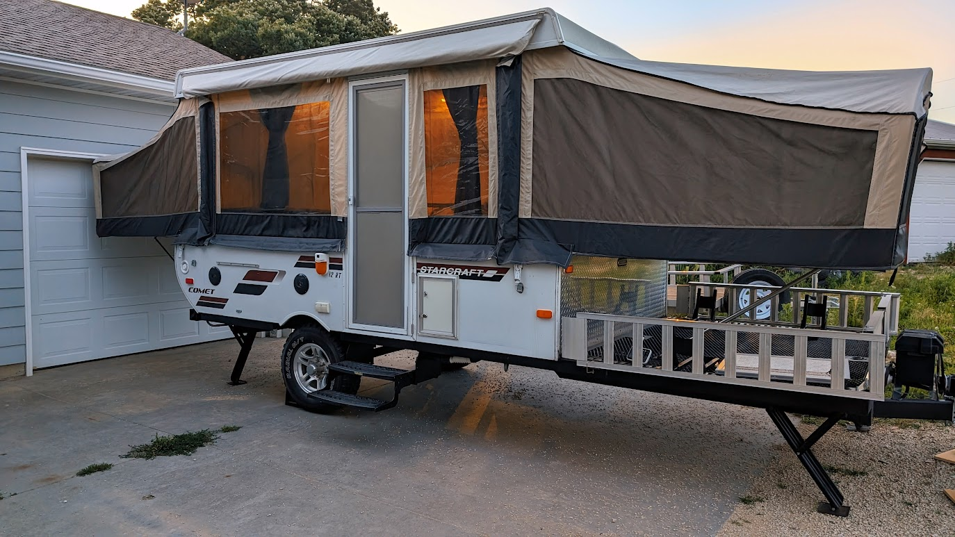

I recently picked up this 2014 Starcraft Comet 12RT pop up camper toy hauler. This is my first camper trailer so I have no idea what I am doing. Due to the rugged nature of this pup I figured I will record my maintenance, mods and uses of it here.

There sure is a lot more room with this pup than my homemade RTT trailer. Now I get to learn about RV systems. What have I gotten myself into!?!?!

The winch motor seems to really strain when raising the top. The cables are definitely coated in crud. I noticed the cable splitter under the trailer had a grease fitting on it. I suspect that whole contraption should be cleaned out and regreased. The seams on the outside of the trailer definitely need cleaned and resealed.
One thing that bothered me was the lack of a 12volt disconnect switch. I discovered the 12v converter and the CO/propane detector are continuous draws when not plugged into shore power. So I bought a bigger battery box and installed a Blue Sea disconnect and a Victron shunt to monitor the 12volt battery whenever boondocking.
