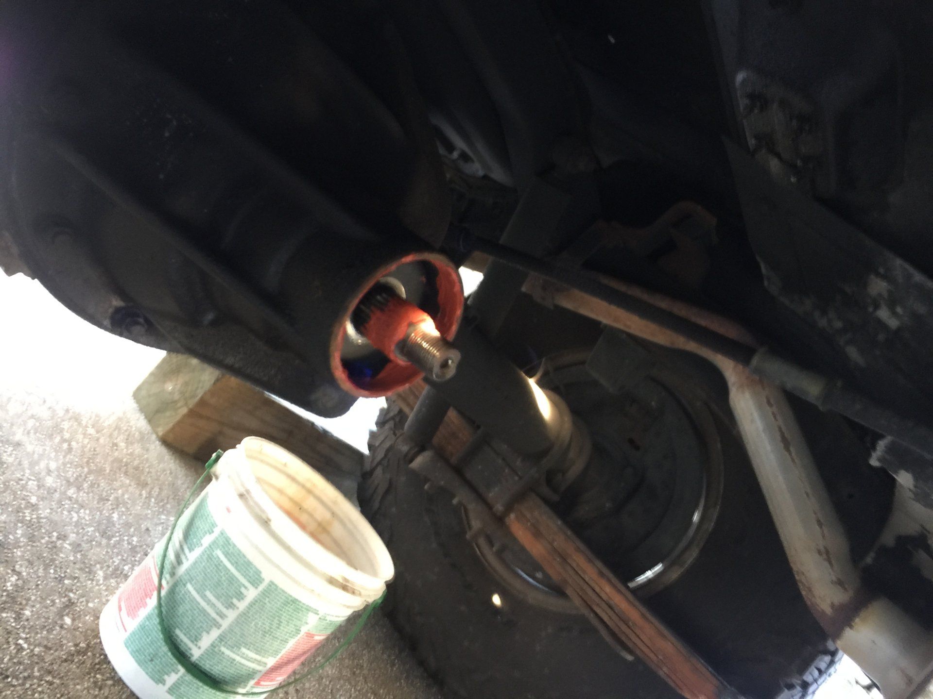

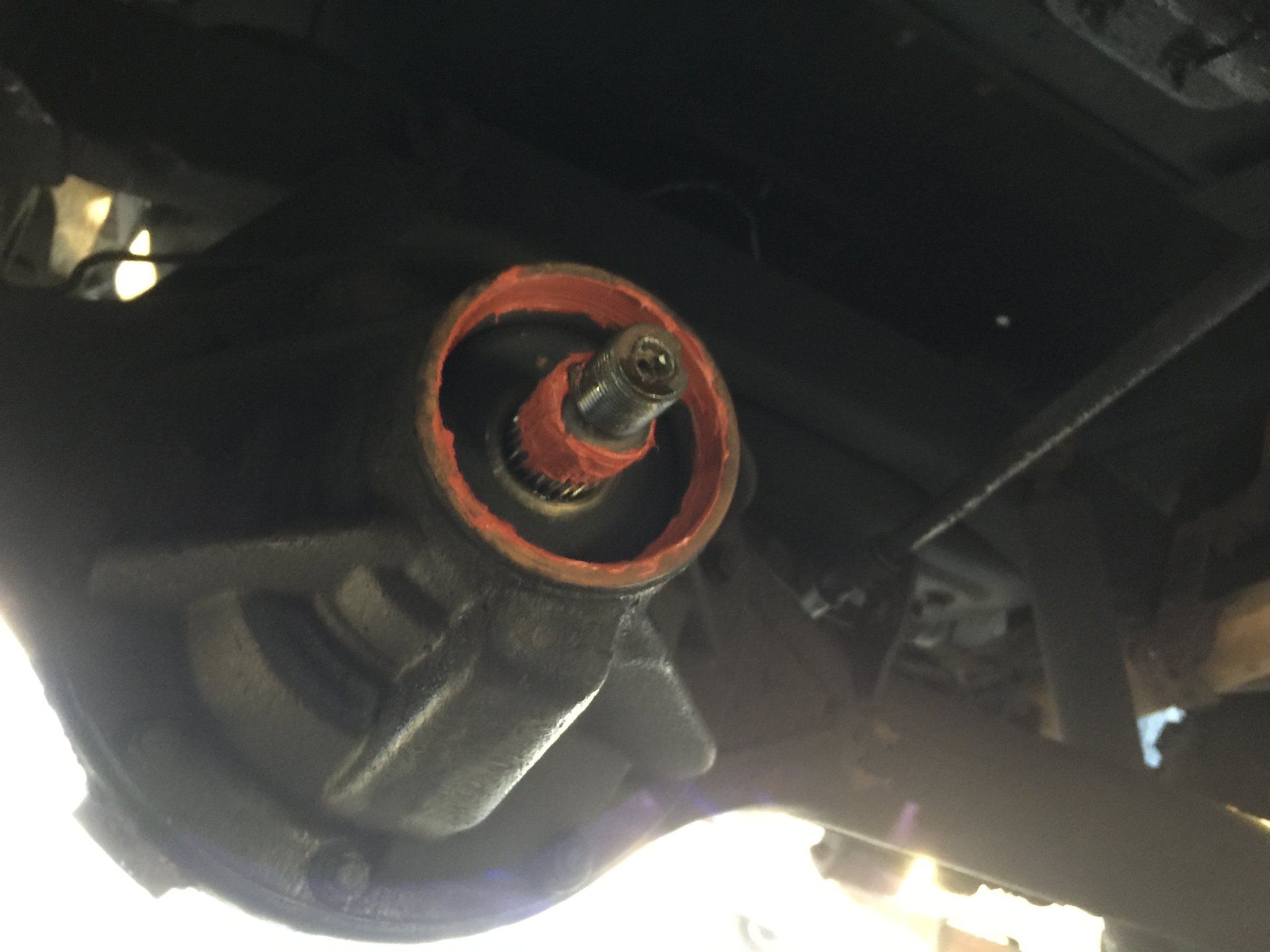

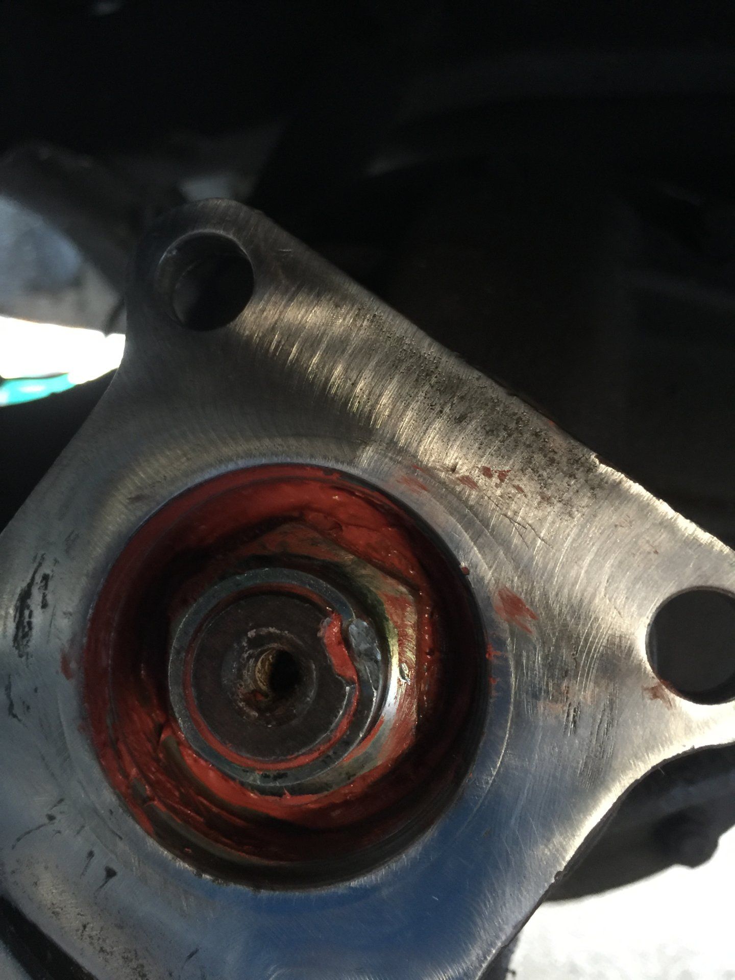

The FSM Specs are to stake the Nut , I always stake mine , If u don't they WILL vibrate loose in a short time
I also use Orange FIPG 00295-01281 on the Companion Flange Splines all the way to the back side of the Staked Nut to prevent
Gear Oil or ATF Fluid Thru-Spline Leaks
This method has worked well for me

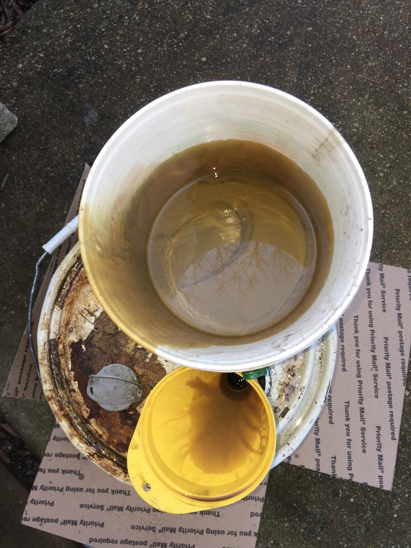

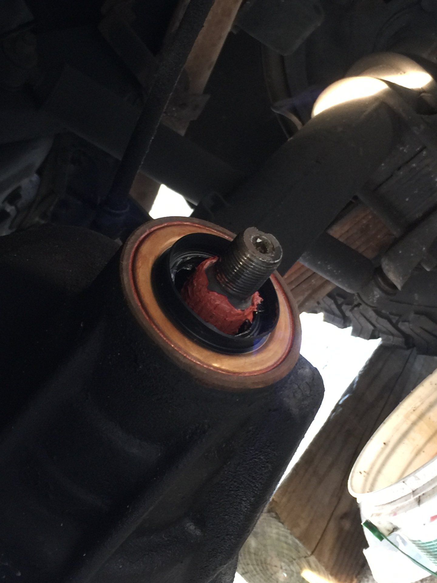

This 1979 FJ55L-KA had a Loose Rear axle Companion Flange Nut Due to NOT being staked by the " PO :poof: " , Water was able to
migrate in thru the pinion and contaminate the Gear Oil as shown
Stake Your Nuts per the FSM .................;)
You'd have to be under water a LONG time to get water in thru a pinion seal. At that point, I'd suspect axle seals and breathers to be potential culprits as well, and would be advising the customer to have me pull and change the axle seals.
As far as the stake nut question...
