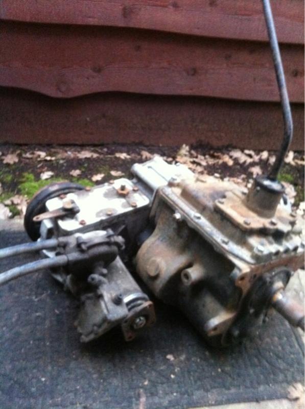

Any knowledge here is appreciated. I dont know enough about these to identify the year and model its originally out of but was used as part of the originally installed '66 4 spd conversion or something along those lines if i remember the story right...!
Transmission is circa 1975 or 1976. You will know if the t-case is a match by looking inside the top cover at the width of the gears. Swaps of 4wd controls and parking brake drums are common.
BTW, that's a serious dent you have in the cone shaped cover on the back side of the t-case. That is usually caused by the stake nut backing off the tailshaft of the transmission. It happens shortly before everything goes KABOOM! :eek:
You had better take that cover off as well and have a look.

Mark didn't the lower geared transfer case end in early 75? wouldn't those still have the thinner gears? I bought for dirt cheap what was suppose to be a 78 transmsiion and transfer case. Looking inside and dating the case the transfer turned out to be April 74 with thinner gears. On this one the direction of the high low shifter and vacuum 4WD makes me think it is probably a earlier case.
I have never seen a cover plate bubbled out like that. Guessing the only thing damaged would be the threads on the tailshaft. That is until the bearing decide it wanted to move backwards.:rolleyes:
John, wider lo range started in 74, wider hi range in 4 of 75.
Ed, smooth fop housings went thru 76.
And as I said, I've seen many top covers swapped.
All that said, there is a somewhat increased likelihood that a whole case was swapped, the original stakenut reused and not properly set, and that is why the rear PTO cover looks like that.
