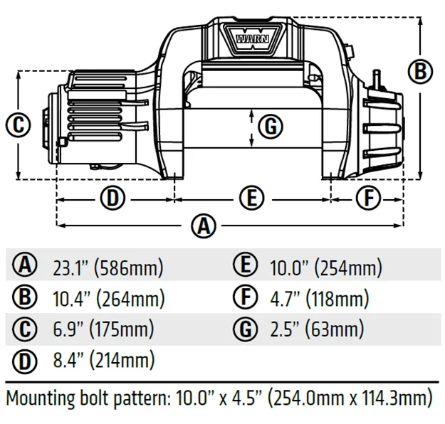

This SmittyBilt is dirt cheap, plenty of positive reviews, mixed reviews....might just run with this. If anyone knows the minimum clearance dimensions needed for this install (to help pick a winch by size), please share.
Can anyone positively confirm whether these dimensions are OK for this incognito winch mount??
I can ask Kevin later today for you.
Also, they had some issues packing these as they are not standard kits anymore, and there were some that got it missing a few bills. If you discover you are missing some please contact SSO and they will send it whatever you are missing.
@tlin here is the reply from Kevin:
I think it's a little tall. You'll need a solenoid that mounts to the side or remote mounted to make it fit well without chopping everything to hell
