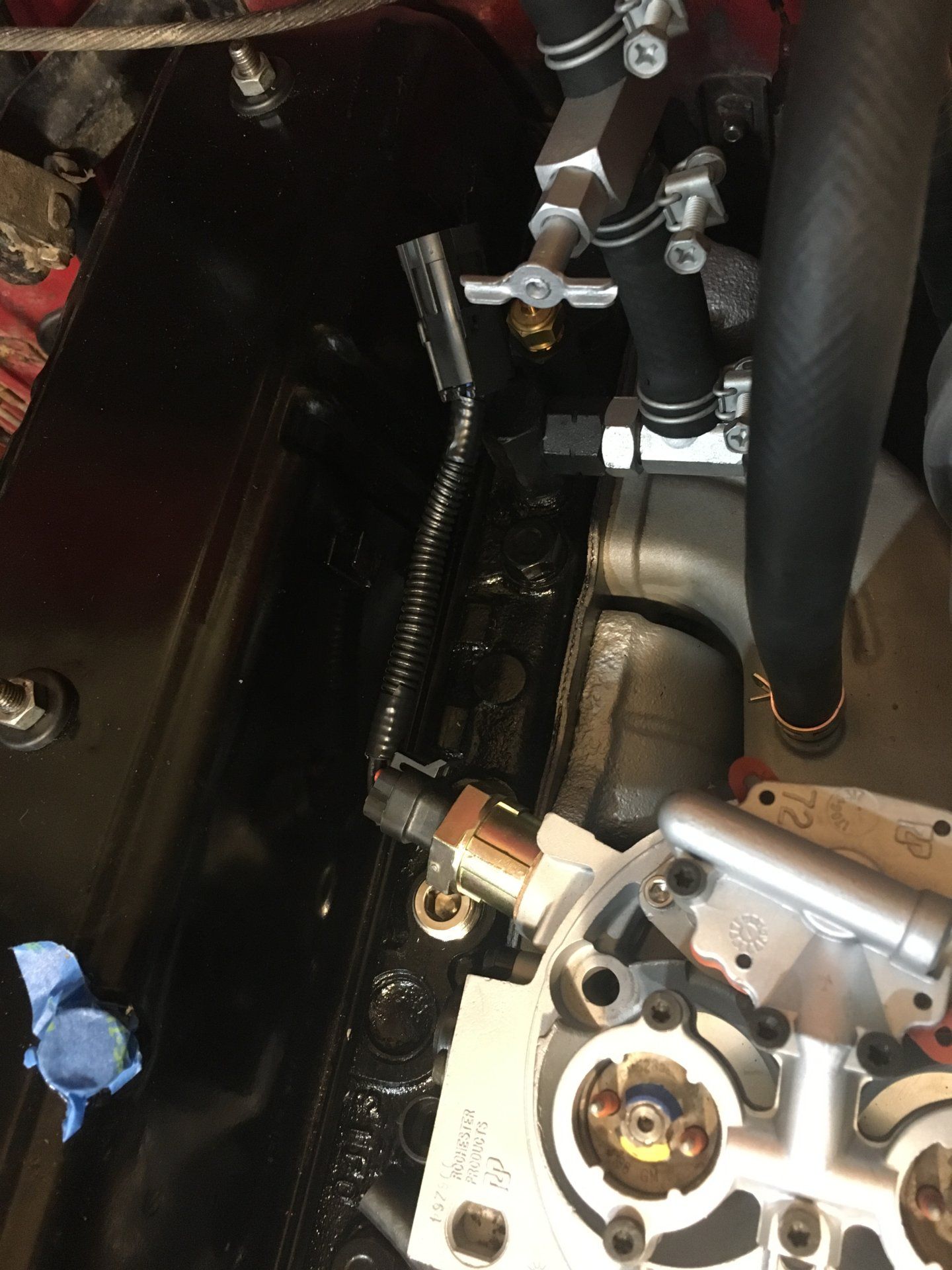

I was hoping to install the temp sender in the extra hole in the head, but there was a conflict with the IAC. In fact, there was a clearance problem with the plug that was already in there.
That got fixed with a SS countersunk hex head plug...
This still left the temp sender needing a home.
I didn’t want to splice it into a radiator hose, or switch out the thermo housing, so I started looking around. It turns out the block drain threads are the right size for the temp sender. Easy win.
Now we just need to deal with the IAC plug.

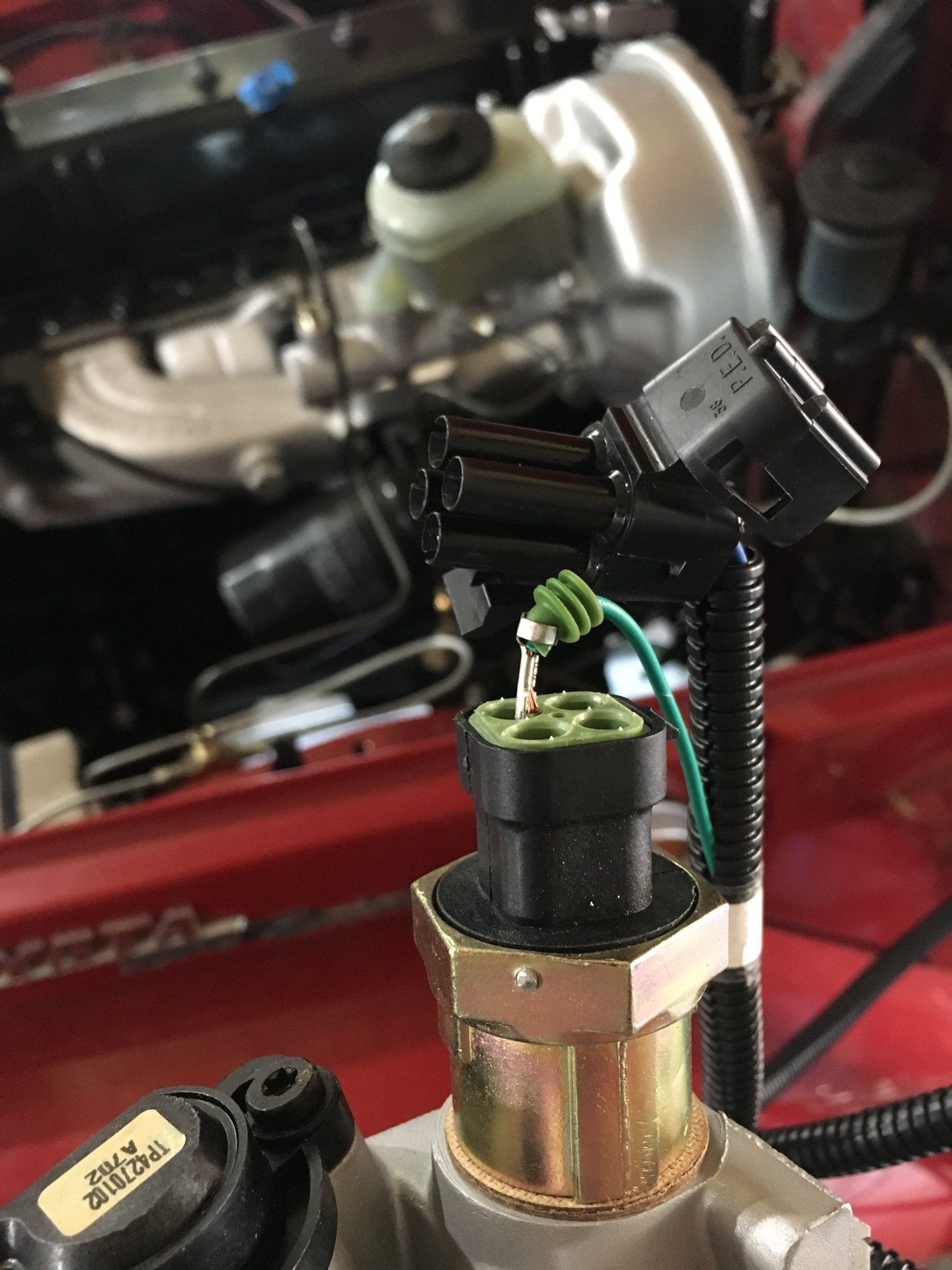

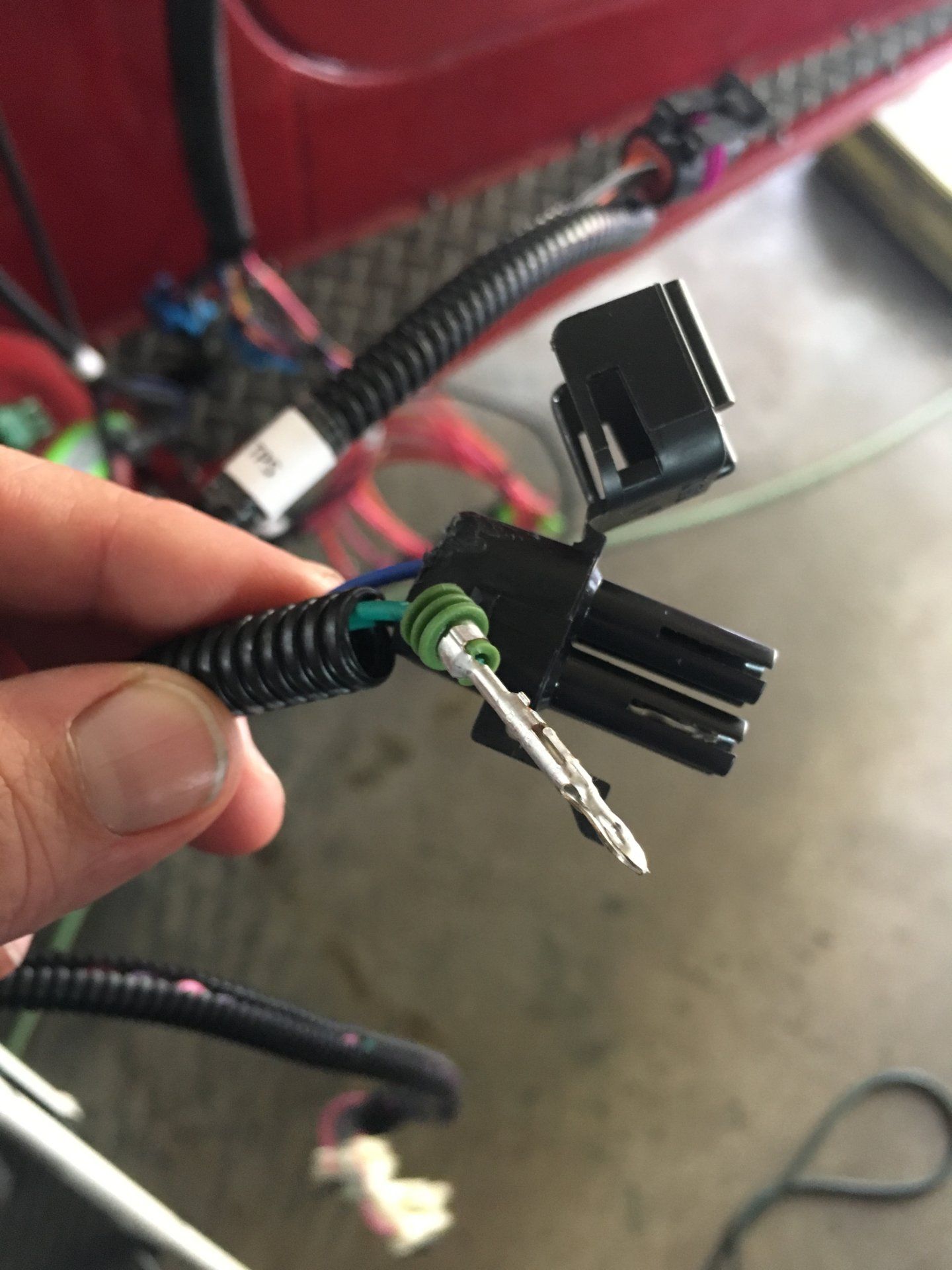

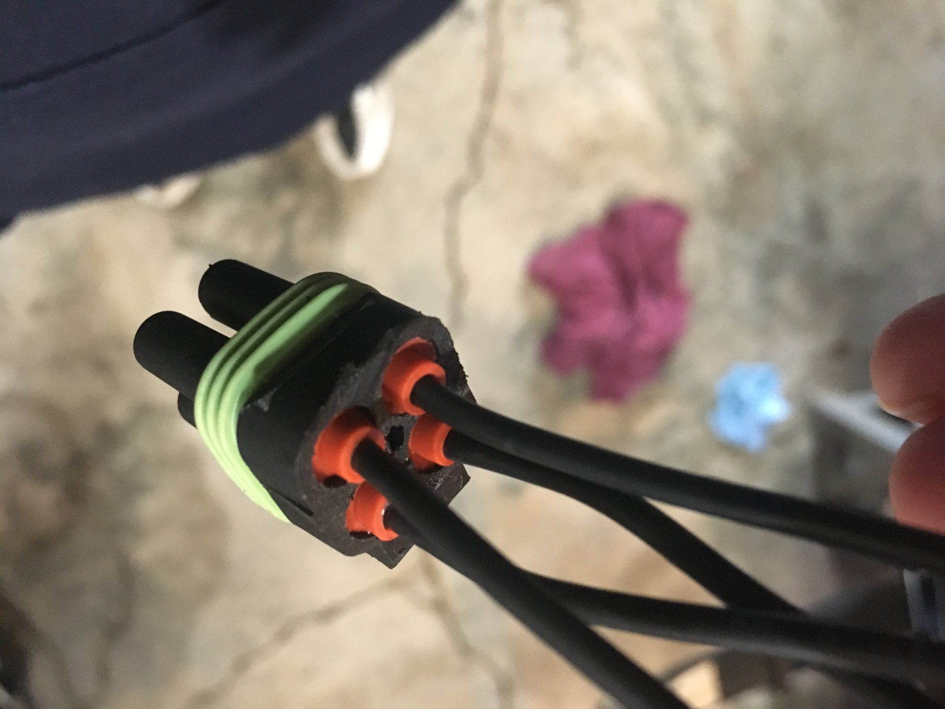

I took a closer look at the IAC plug and it looked like it could be shortened. I did some preliminary dissection to see if it would fit.
The new plan was to buy a pack of male & female plugs and make a short pigtail. I could shorten the plug that stays in the IAC, but you could still unplug the IAC for servicing.
I chopped about 1/2” off the back of the plug, but still kept the clip attached. For further heat protection, I put a very small heat shrink around each wire before inserting into the plug. I was able to keep the rubber plugs in, so there should be no loss of weather proofing.
I slid another heat shrink around the full bundle of wires, and bent them into position before shrinking, so it would hold this shape.
Here’s the final product, compared to the original plug...
In place, how it will be installed, with about the same clearance as a later manifold...

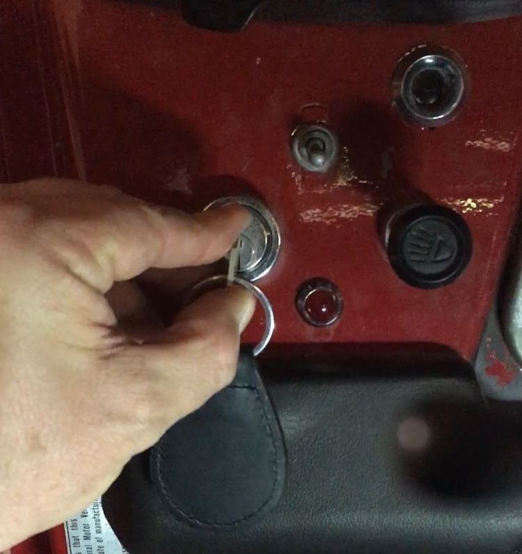

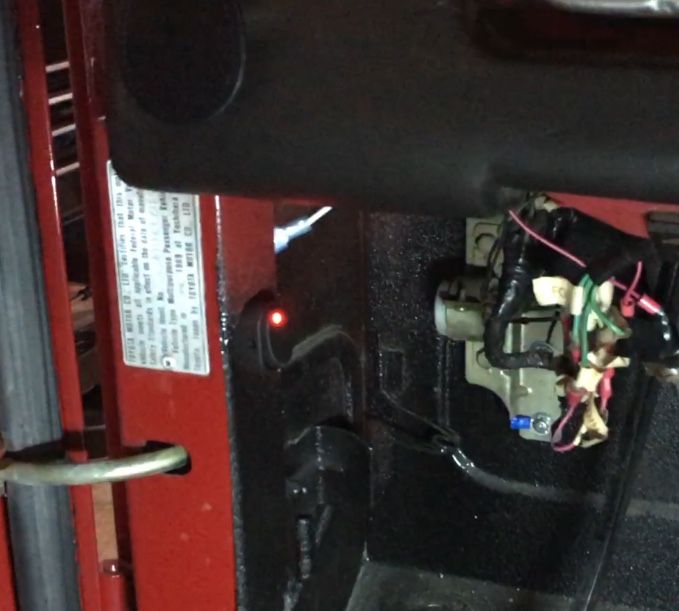

JTU found a better check engine light than the one that came in the kit. This one looks like a mini blinker light.
