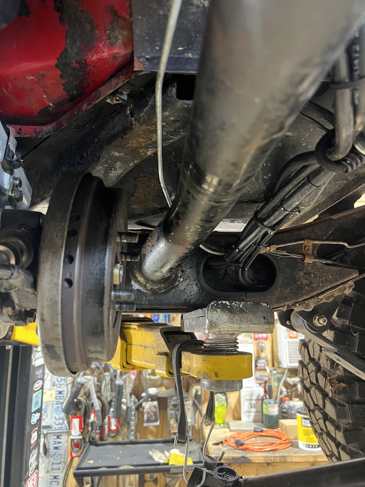

Driveshafts made it and fit perfect as always.

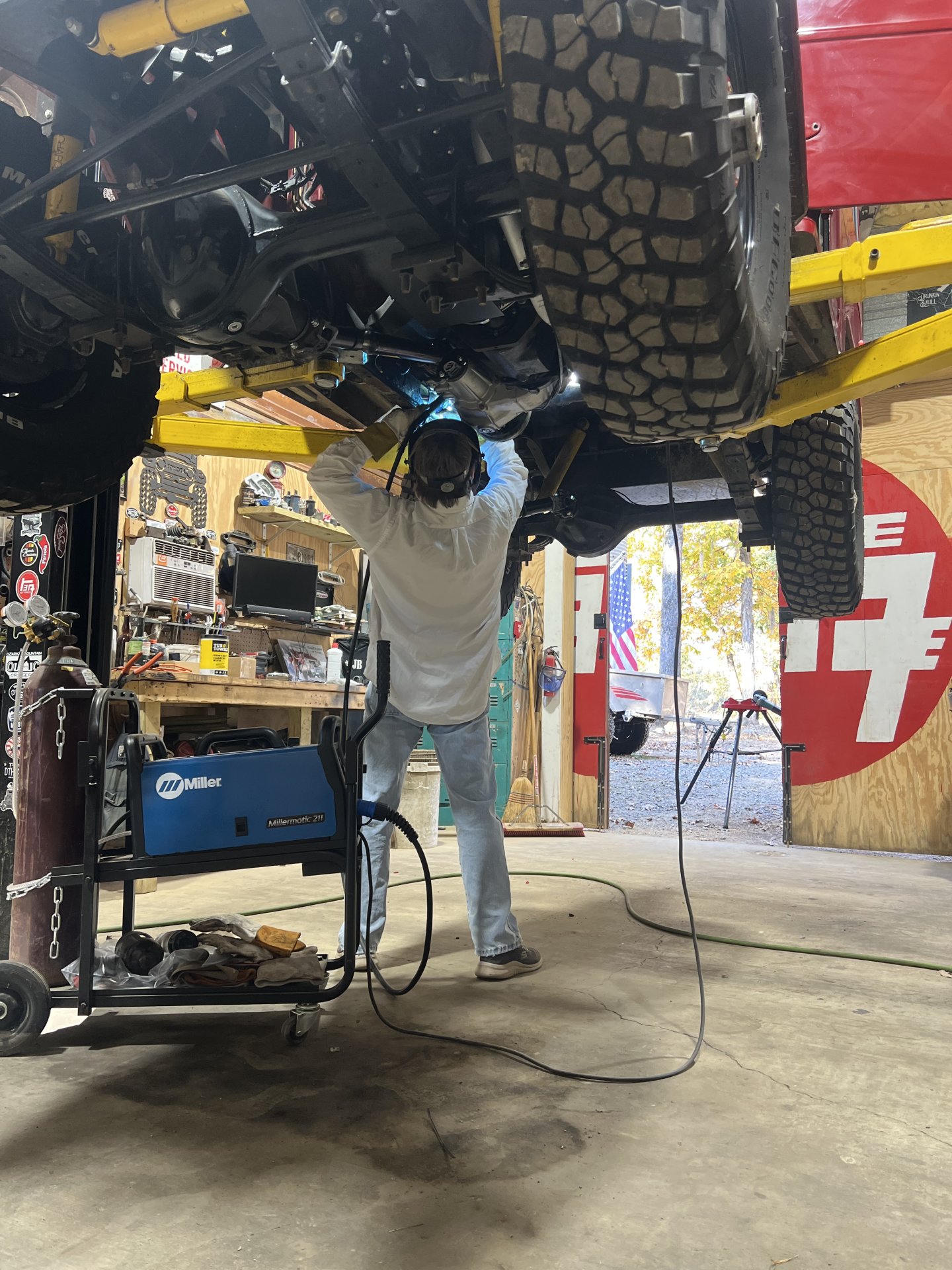

Got the Wizard up to clock and burn in the torque tube. We got it where the ebrake came come off if needed

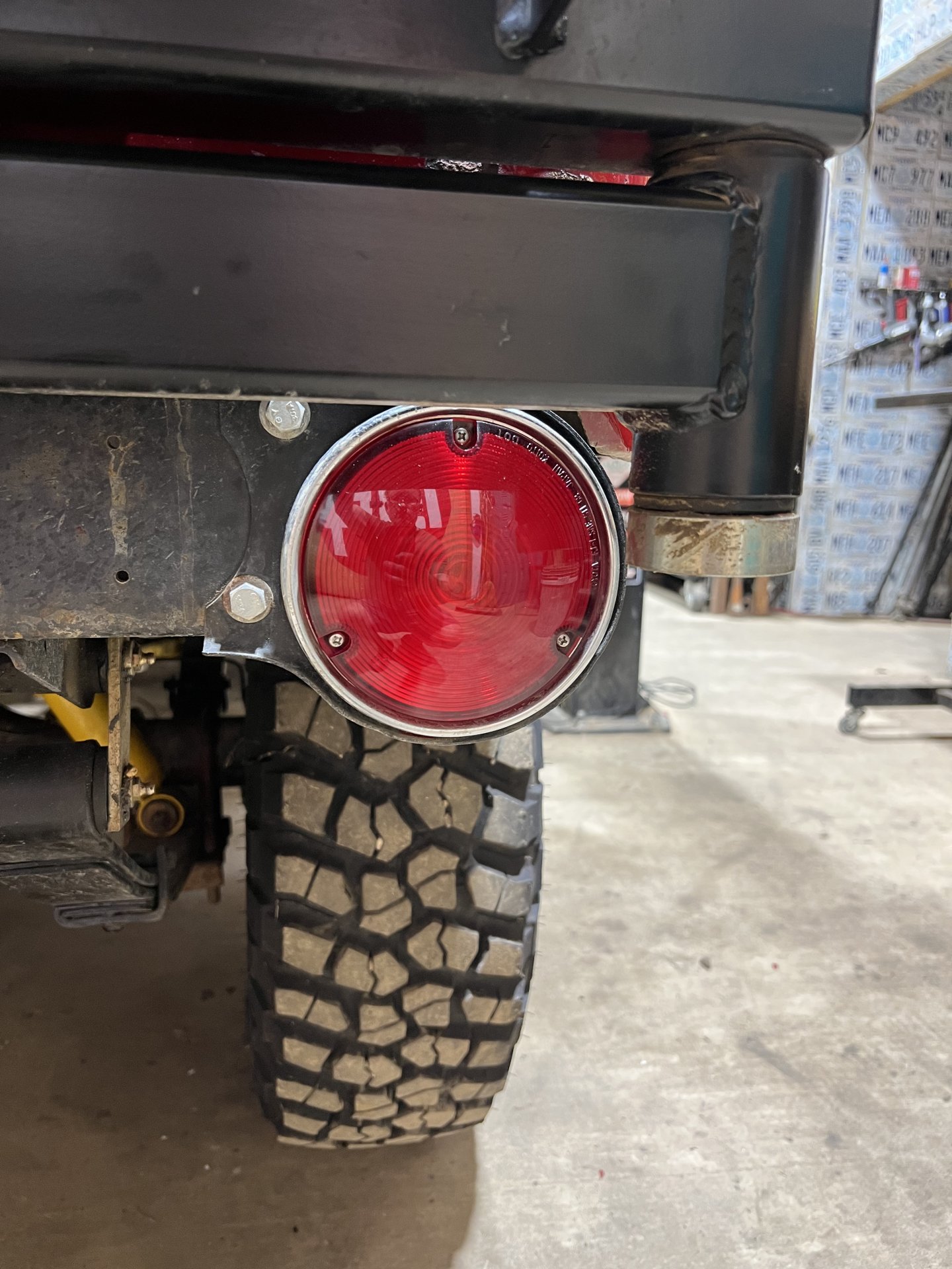

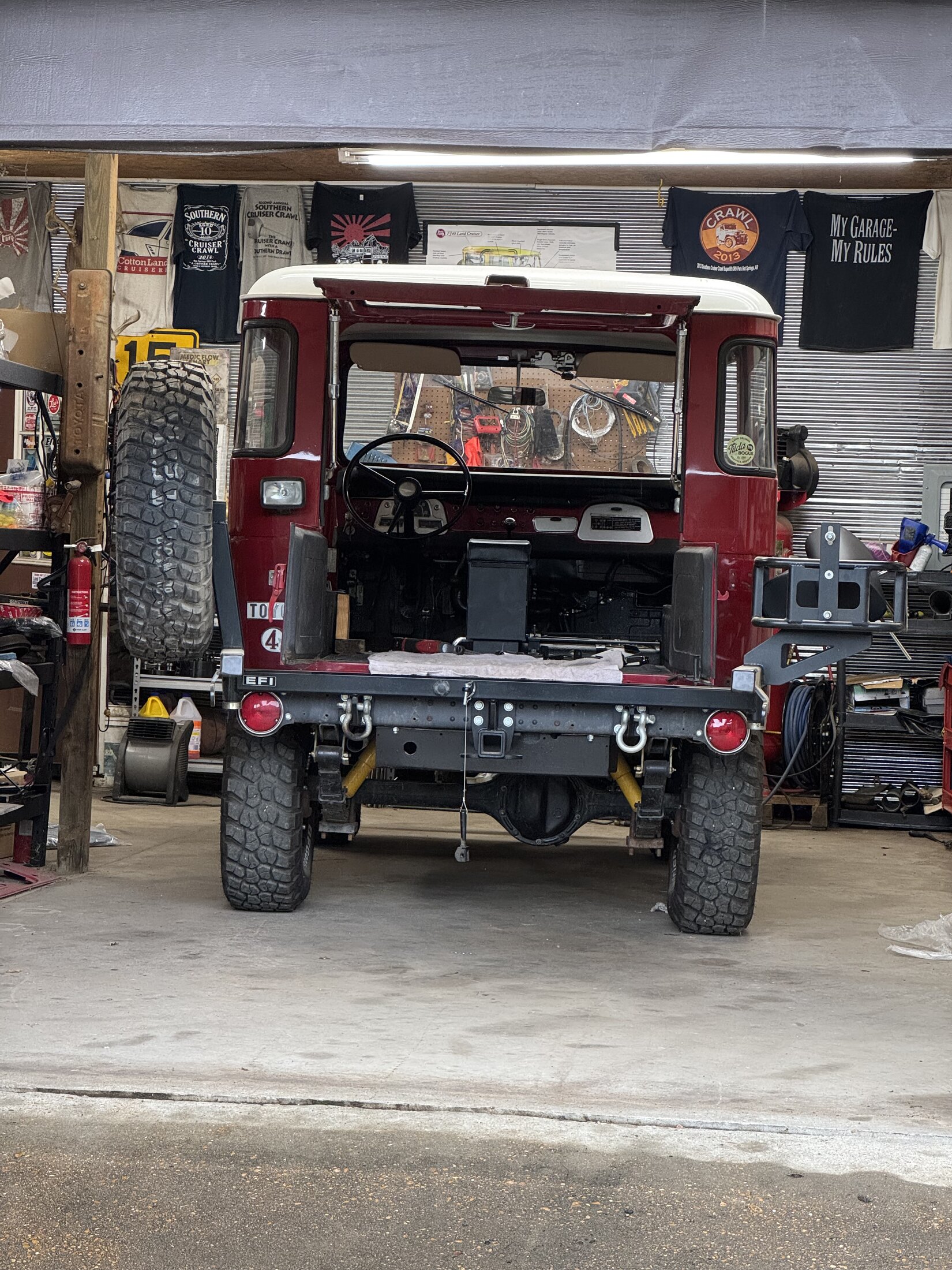

Added a new tail light. This one was a goner

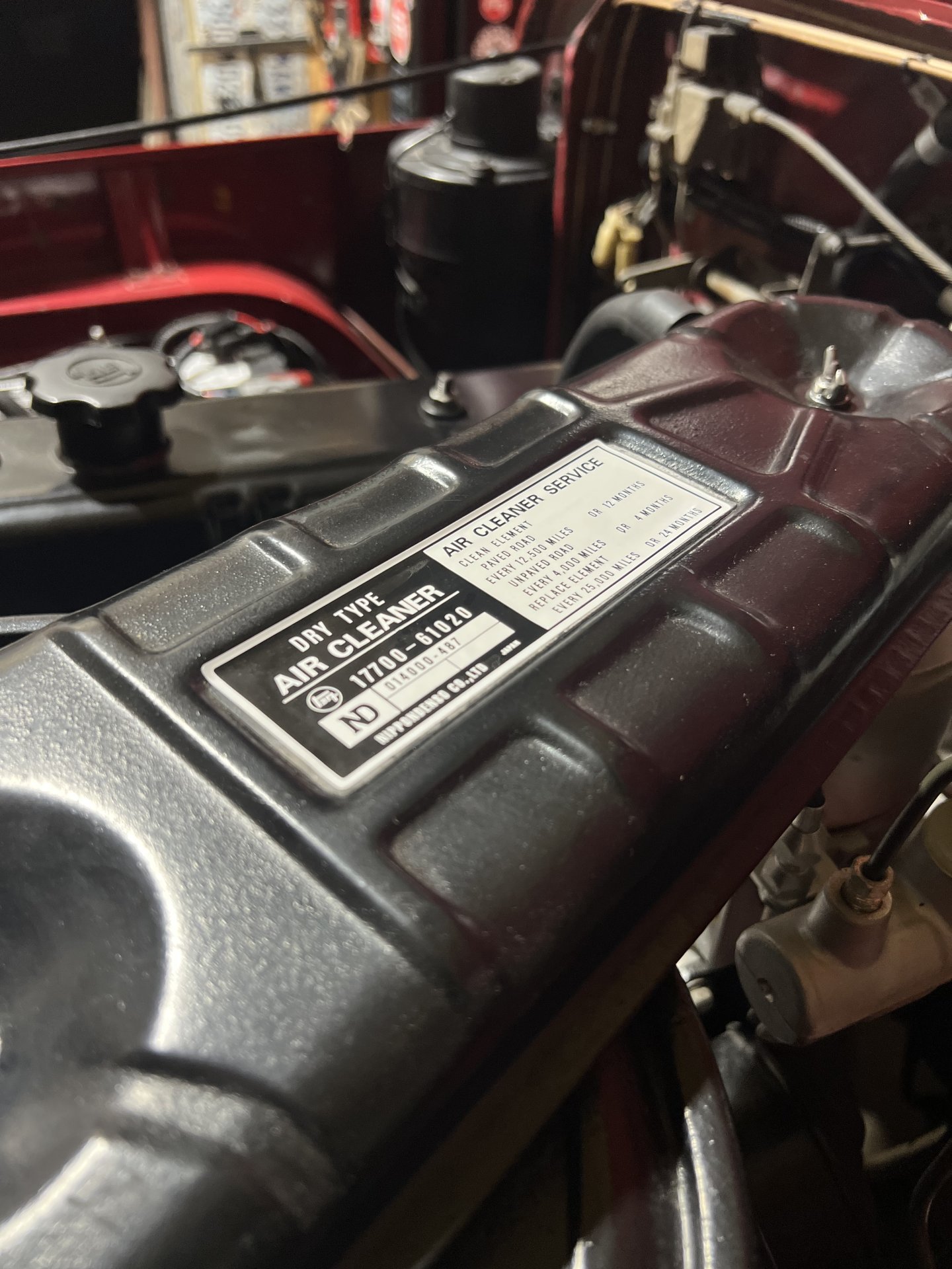

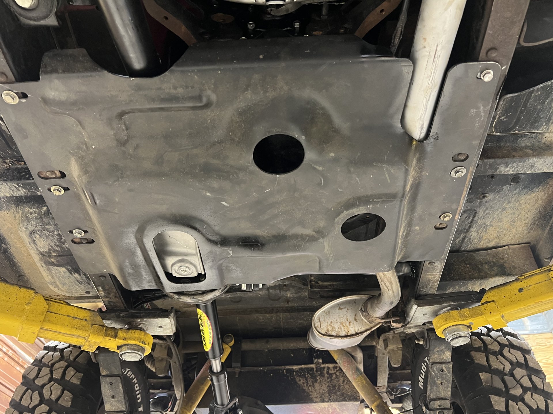

I got the 3 speed skid plate modified to fit the 4 speed and a new sticker from City Racer for the air cleaner.

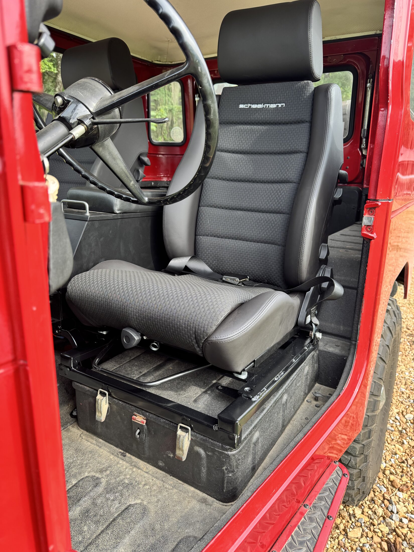

The Minnow is back for some ScheelMann seats.

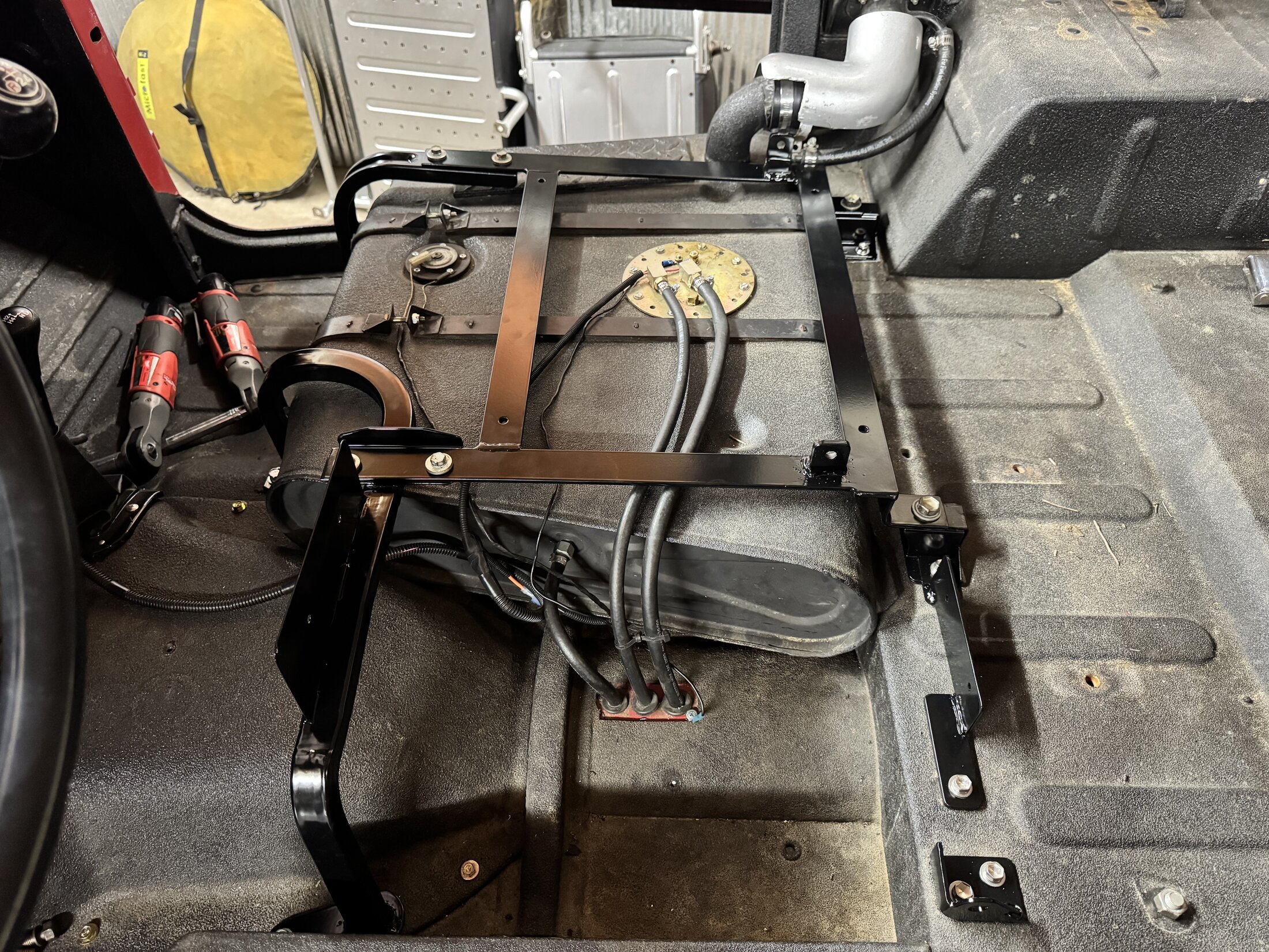

There really is no bolt in option I like for these so I usually get the Wizard over to make them work.
We add a passenger setup from a 1973+ bucket seat and then weld the mounting brackets to the tool box Pivot bracket from the early 40
The passenger seat will be about 2" higher because we have to clear the in tank fuel pump stuff
We mocked it all up and then tackled the drivers seat first. It's in and finished.
We will work on the passenger tomorrow. Console will be last. We want it as low as possible
We got the console mount built today and it all came apart for a trip to PowderKeg. We made all the brackets for the seat out of OEM parts. Should look slick.

I definitely like how you guys tied the driver seat in.
Are the flat brackets part of the scheelmanns? Or are those like a planted bracket?
They are provided by Scheel Mann. Outside vendor other than Planted. These are for the 73 and up
The early ones they provided make you dissect the passenger seat and add it to the OEM frame.

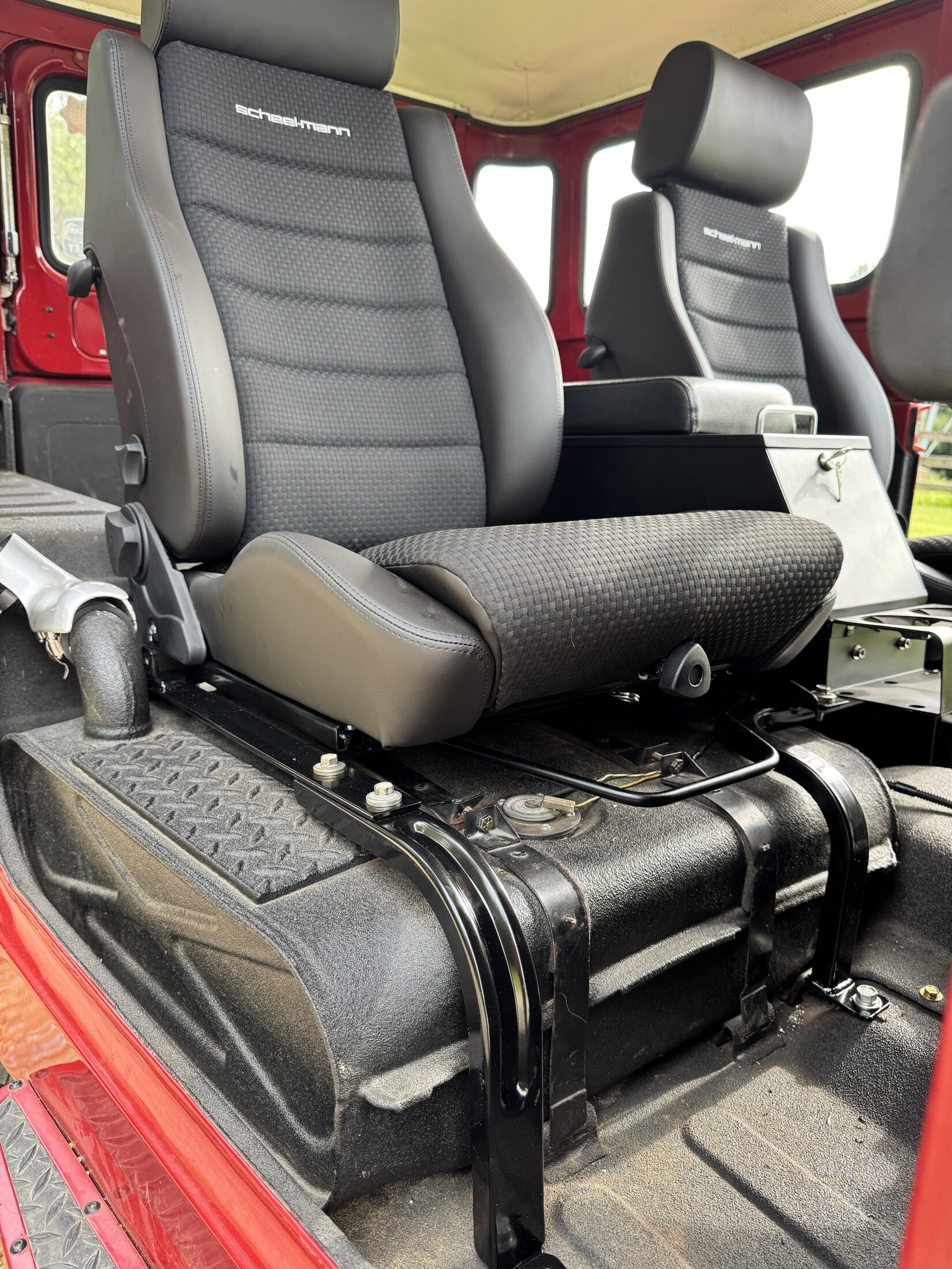

Got all of the parts back from powder and got these beauties installed
Here is the passenger side. If you don't have a in tank pump like this one you could probably lower the seat another 1.5"
For the 73+ seat brackets does the passenger sit at the same height as the driver seat?
Yes. The tank goes from 18 to 14 gallons so it's lower.
