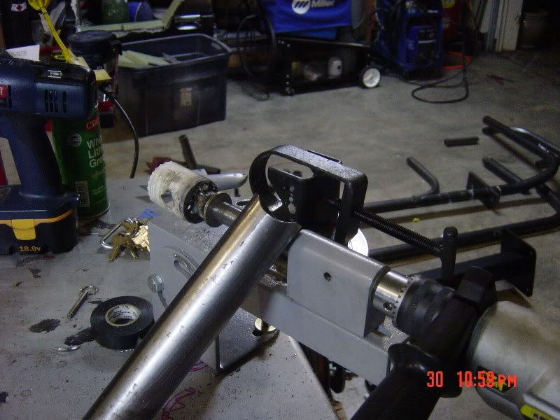

no notcher... Just a grinder and a sharpie. Do u think one of those harbor freight notchers would just be a waste of money?
As far as a hitch... I have enough butt pucker just going around long corners.
The HF notcher (the better one) is still a ball of junk. Bought it and returned it the same day. I had some hopes.
HF notcher works ok... Most likely use it for 90s and slight angles. I also learned that holesaws have those two holes in the top for a reason. Helps the threads under torque (I killed the holesaw threads on my first attempt). Oh well, I ended up just welding a hefty nut to the top of the holesaw.

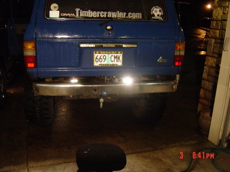

Old bumper:

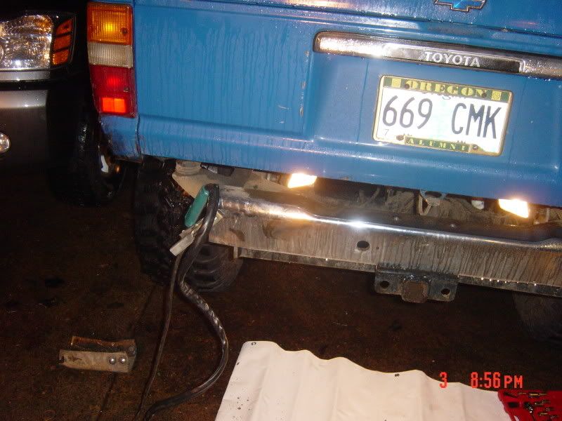

left side of old bumper off:

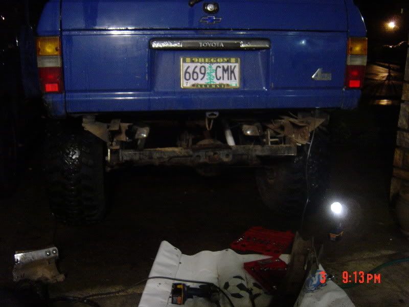

Both sides off:

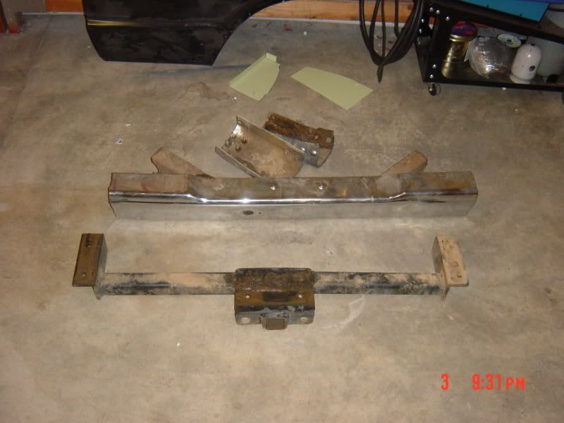

By the way... whoever tells you plasma cutters arent fun to use is lying. It was the first time I actually got to use it for something useful and it sure beat the hell outta trying to pry rusty nuts...I hate rusty nuts. :)

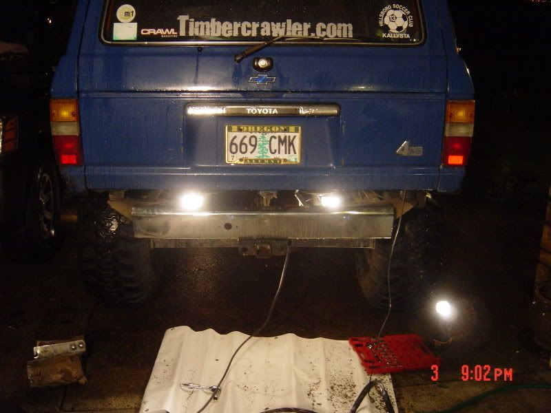

Bumper off:
Hitch off:

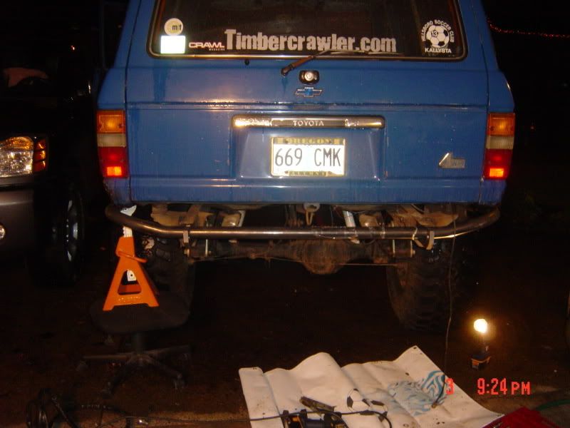

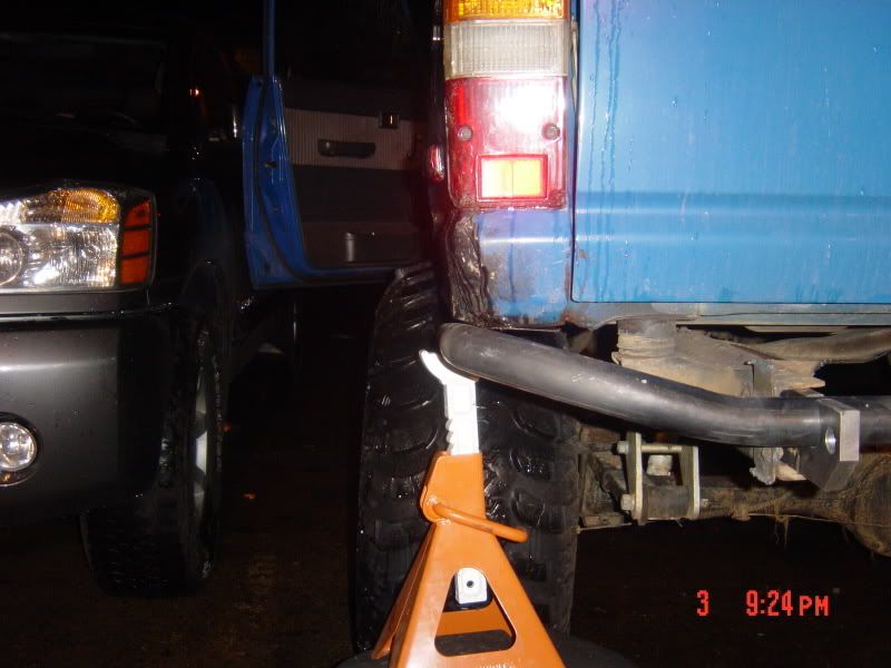

little tight but I think I can make it work. I think it ended up being just a bit short on width but I think I can just "V" the side protection and it'll work or I'll just add a hitch in the middle and that'll be all the width I need. I'm seriously impressed by how freakin close you got by my measurements over the phone... seriously impressed. OK OK enough with the jibber jabber..
and some aftermath carnage...
