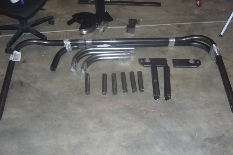

alright... had a little time tonight to at least try to lay it out. Jim am I close? Not sure how the pieces in the middle work yet.
you should have two 1.5" shortie straights that have a red 2" on them.
those are for the back, when you drop your tailgate, they are vertical on each side. the 2" end goes to the main bumper tube.
notch the top of the shorties to add a 1.5" 90 degree to wrap around the corner
page 8 post 223 ;) https://forum.ih8mud.com/60-series-wagons/177104-cheap-rear-bumper-8.html
then add the other 1.5" 90 degree tube and bring it forwad and down to the main tube.
weld the seems and add the extra 1.5" shorties that are marked 1.5 where ever you want along the sides.
make sense :eek:
I think I get it!!! so the two pieces with the 90s that were marked side and corner actually meet up and go from along the side quarter and around the the tail light and then connect back down to the main tube near the frame mounts/tailgate. Right? :)

that's it!!
