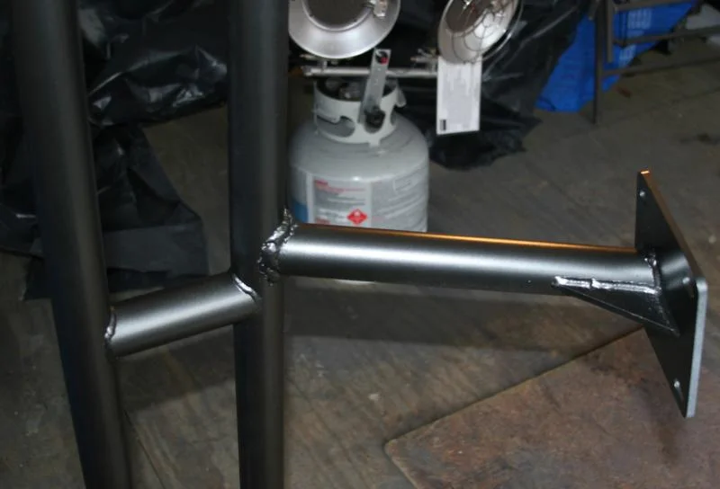

my buddy brian's sliders on his 80 series..
Tommy, any larger pics of those 80 series sliders? I still have your tree saver as well need to get it to you somehow. let me know.
