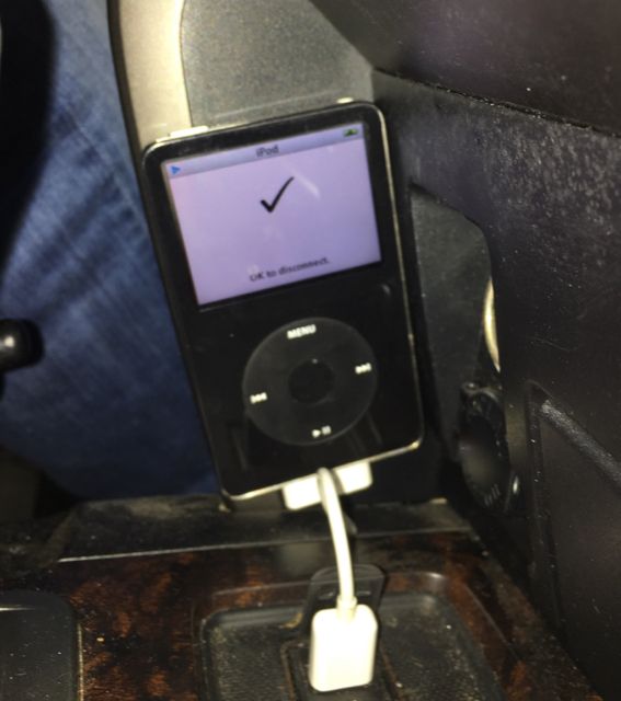

Found a cool spot for my old 80gb classic iPod. 2 sided tape and a short cable from Amazon
Probably not the right thread but I'm on a roll.
