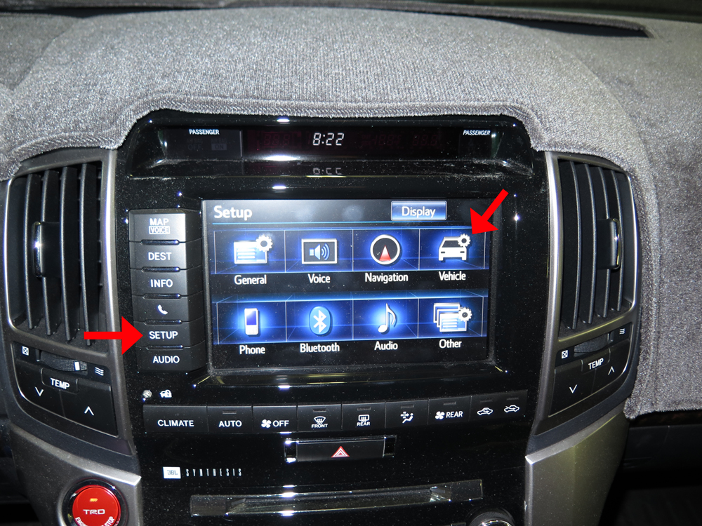

OK, here are pics that should guide you through the customization process for the features you want.
First, turn the Ignition ON - that's 2 presses of the Start/Stop button with your foot OFF the brake.
Press the SETUP hard button to the left of the NAV screen and select the VEHICLE option:

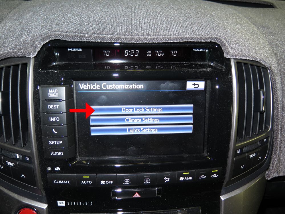

Select the VEHICLE CUSTOMIZATION option:
Select the DOOR LOCK SETTINGS option:

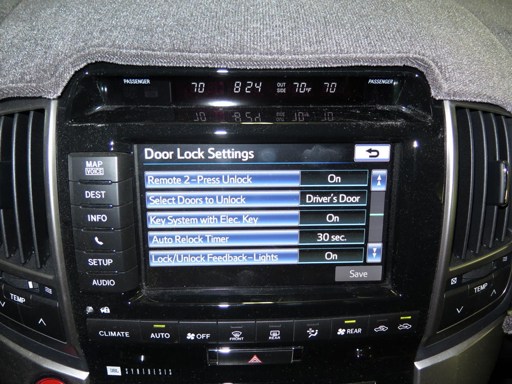

This will bring up a screen with several options:
These options are toggled ON or OFF to enable/disable the function.
Toggle AUTO LOCK BY SPEED to ON and the doors will lock when moving above a certain speed.
Toggle AUTO UNLOCK BY SHIFT TO P to ON and the doors will unlock when the vehicle is put back in Park.
When done, be sure to press SAVE in the lower right of the screen to save and enable your changes.

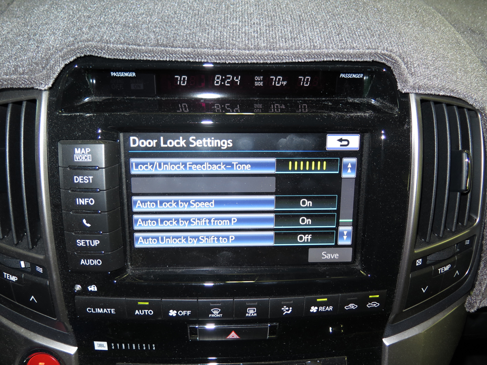

That takes care of your specific request, but FYI there are other options available if you scroll down the last screen shown above. Here is what you see by scrolling down one screen:
And by scrolling down one more screen:
None of these options have the possibility to induce a "fatal" error or are irreversible, so feel free to play around with them to get the various features to work the way you wish.
