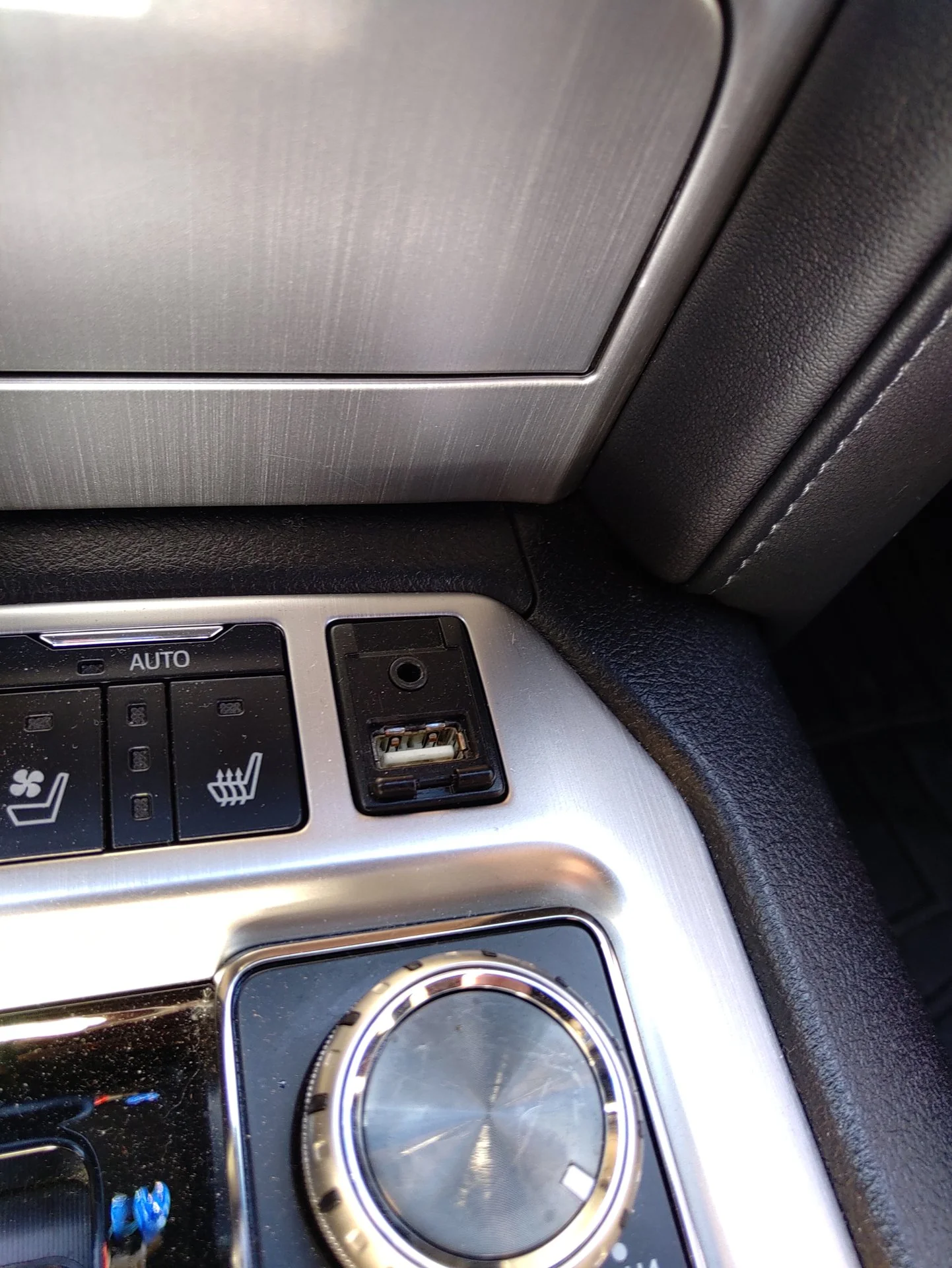

Anyone know where I can find this USB cover?View attachment 2965766

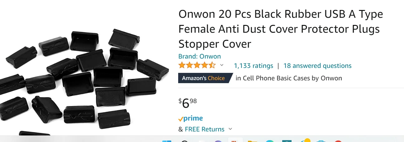

i would buy one of these for 6 bucks on amazon, and spend the rest on beer for the weekend.
Do you want my USB cover? I leave a short USB cable inserted into mine all the time anyway. It's only ~6" so it's not in the way, and it makes it easy to plug in a phone to charge when a battery is low. To me the little USB cover is just in the way
I appreciate the offer but I do keep things plugged in there a lot too.
Not a big deal, thanks though....

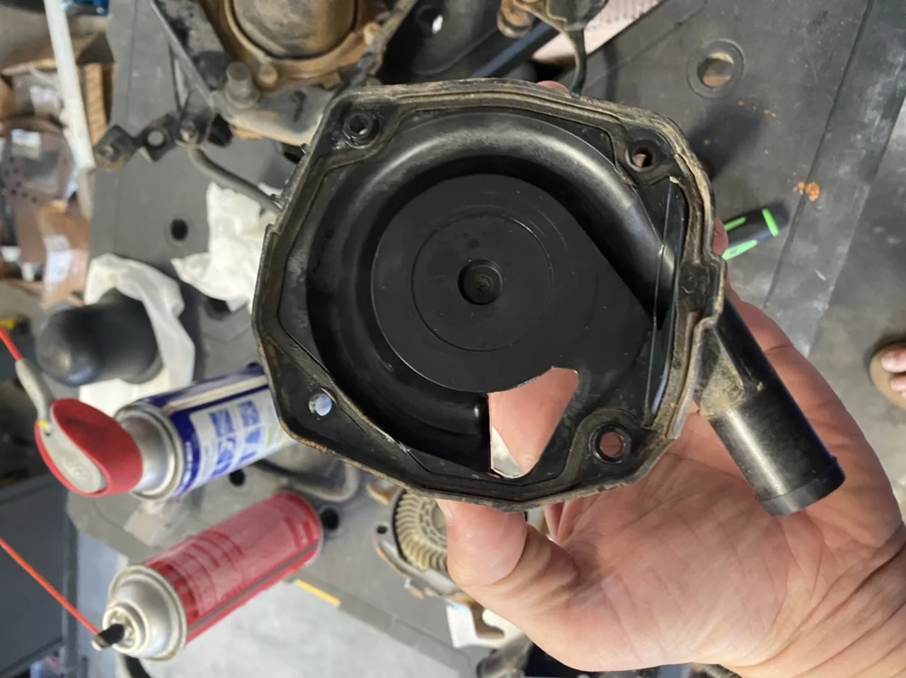

Stupid Question: disassembled my secondary air pumps to remove the destroyed foam. The old gasket appears to be a form in place foam gasket. My plan is to reseal with 3M 8662 (super silicone sealant). Wanted to see if anyone has other suggestions/recommendations, as I cannot find the gasket itself anywhere….
RTV silicon sealant really isn’t a true FIPG (form in place gasket).
Toyota makes a black FIPG that comes in a tube and the stuff is incredible. Nothing like silicon RTV.
I’d recommend using Toyota’s goop.
There’s a black and orange formula. Orange is for contact with automatic transmission fluid, black is for contact with engine oil.

I think that I would just clean up the current gasket and reassemble it. Silicone or FIPG will just make a mess now, and a nightmare should you ever have to take it apart again.
Ended up using some Toyota FIPG I had laying around. Figure after 12 years if I have to open these up again I’m using a sledgehammer and replacing them anyway
