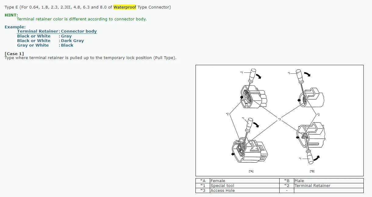

This is an older document and that connector may not be in here, but maybe something similar?
Yeah I have the latest version (attached). I can't find an exact match for this connector though. It's 90980-10946.
The corresponding mating part, which I also have, looks like the bottom right image and pops right out, but this part doesn't have any obvious method to pop it apart (unless the special tool I don't have is supposed to fit in one of the tiny holes in the white insert... but if so which one?)

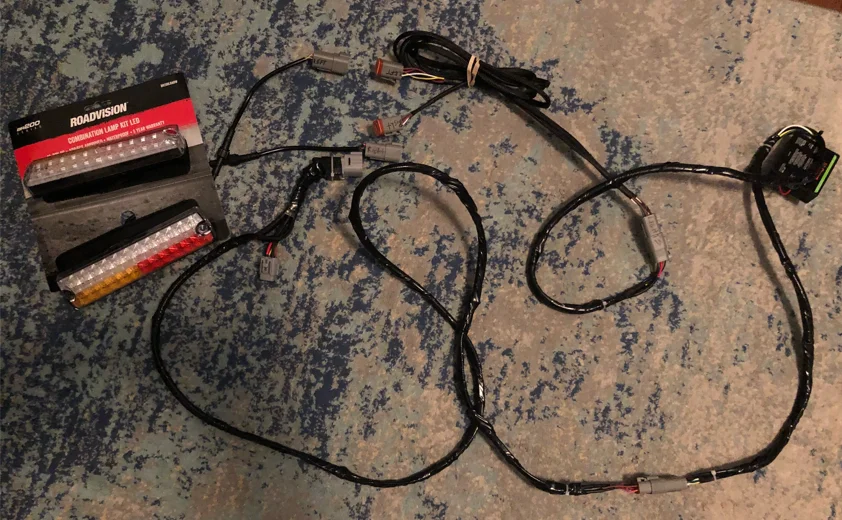

Harness complete. Thanks for the assistance! Debating the best way to test this... maybe I'll string a bunch of AA batteries together
Connecting to the battery seems like a good idea, assuming everything you've testing is 12v.
Although, I picked up a variable power source when I was troubleshooting a fuel pump ecu issue a couple of years ago that would be ideal for testing electronics. It has variable voltage and amperage, so is very controlled. Probably overkill for testing 12v lights, but I have it, so I'd probably use it.
Although, I picked up a variable power source when I was troubleshooting a fuel pump ecu issue a couple of years ago that would be ideal for testing electronics. It has variable voltage and amperage, so is very controlled. Probably overkill fir teating 12v lights, but I have it, so I'd probably use it.
I thought about the truck battery but it’s cold out and in the off chance I shorted or miswired something I’m hesitant since the harness isn’t fused. actually the variable power supply is a good idea - I totally forgot but I have one that I used when top balancing my Lithium battery pack. Ado that allows me to fiddle in my comfy basement instead of out in the cold garage.

At my hourly rate and pace it’ll be like $1000 effort ;-)
I’m going to post the wiring diagram and parts in the RLC bumper thread tomorrow when I have a few minutes. It’s not hard and not expensive parts, just kinda slow. Having the right special DT crimper tool would’ve helped me.
At my hourly rate and pace it’ll be like $1000 effort ;)
Lol same. I would have paid to have someone do this part. Mine looks jank.
I posted the wiring diagram in the RLC bumper thread, for those interested.
Parts-wise the lights cost me about $150 delivered from Australia. The connectors were about $40 total. The Curt adapter runs about $20. The spool of wire was about $40 though I only used maybe half of it. Another $10-20 in techflex, tape, heat shrink, etc. So easily about $250 in parts.
Seriously I probably spent 6-8 hours making this. If I had the real DT crimper tool I could probably get it down to about <2 hours per harness... maybe an hour if I made dozens of these. Even still this would probably be a $500 harness (including all the parts above) to make it worth my time. I bet some company on Alibaba could make these for <$100 (plus the lights) and all you might have to do is put DT6's on the ends of the Roadvision lights... and then sell the harnesses for $$$ here. I suppose if a bunch of people were interested I might look into finding a company to make this, but I suspect we'd need at least a couple dozen people buying in to make it work
On the plus side even if it looks janky... well it's not something you regularly see at least ;-)
