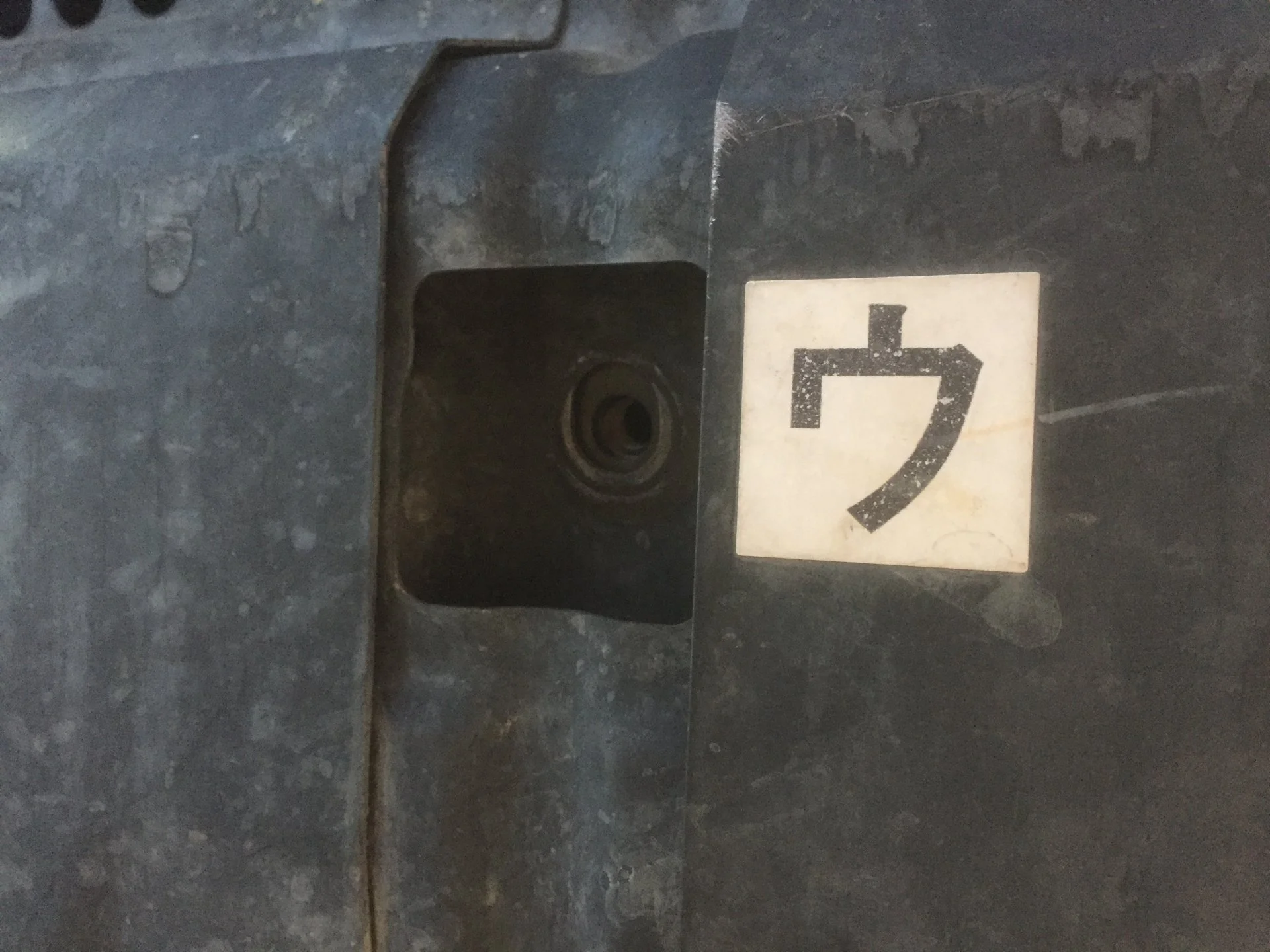

What does this symbol on my skid plate mean? (and no, I did not check the manual)
[edit, the photo was upside down]
Your picture is upside down, but is the Japanese kana for "u" (pronounced as oo in loop) and is usually an indicator for UP or FIRST in English.
oops! But I wonder what it means in the context. It is towards the front of the vehicle on the driver's side. I guess it could indicate the front of the skid plate. Maybe it's for the folks who change the oil filter and tells them how to reinstall the plate. The passenger side is not marked.
