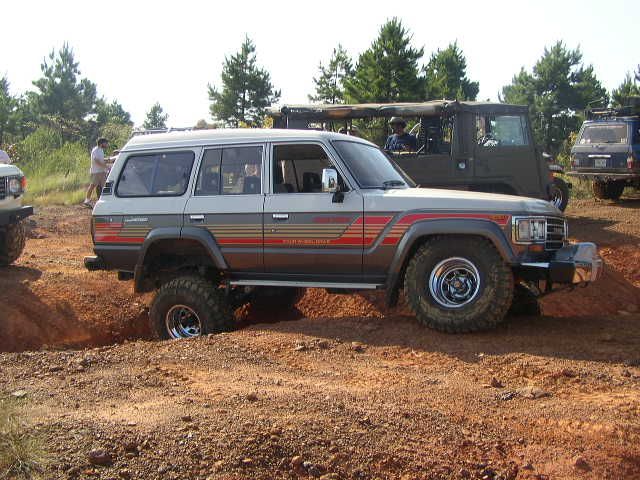

One pic better than 10 thousands words ..
Off course SO my rule for serius mudd wheeling ... in my case 2" whee spacers and I can handle 120 km/h cruiser speed with no problems.
and here is a good pick of a clean front axle on my HJ61
good shot Brad .. I'm triple jelaous .. :eek: is a F beauty TLC ..

Thanks everyone. I appreciate the compliments.
I love my TLC.
I hope the next one I build will be even better. There are so many nice trucks out there with many great ideas. It's hard to decide what to do next...
